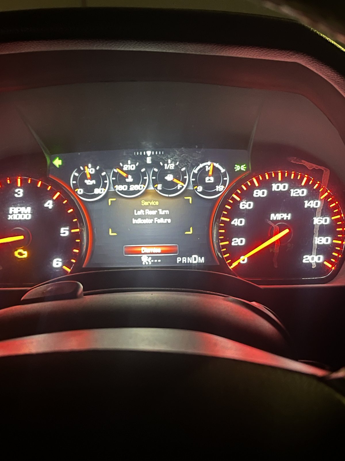

Hello, I got this message about on the dash for left rear indicator message. Would anyone know how to fix this issue? It is not a bulb. The company who sells the tail light said it’s nothing to do with their LED light so won’t sent a new one. The flashers blink correctly. This particular light last summer was brighter then the other one and the dealer reset the fuse block. Any fix for this?

The company is Circuit Board Medics. They claim they are OEM brand new lights. This is the second tail light that they say is brand new OEM replacements. Whoever owned my ride before hacked the first time and soldered. I sent core in and circuit board medics sent me a new tail light last Jan. This summer it was brighter then right side so dealer messed around for 6 hours and chased wires blah blah blah, reset fuse block for $600 and it dimmed down. The other day the message just randomly came on the dash for blinker. It’s led not a bulb for blinker. They don’t want to send a new light because they don’t think the light is bad

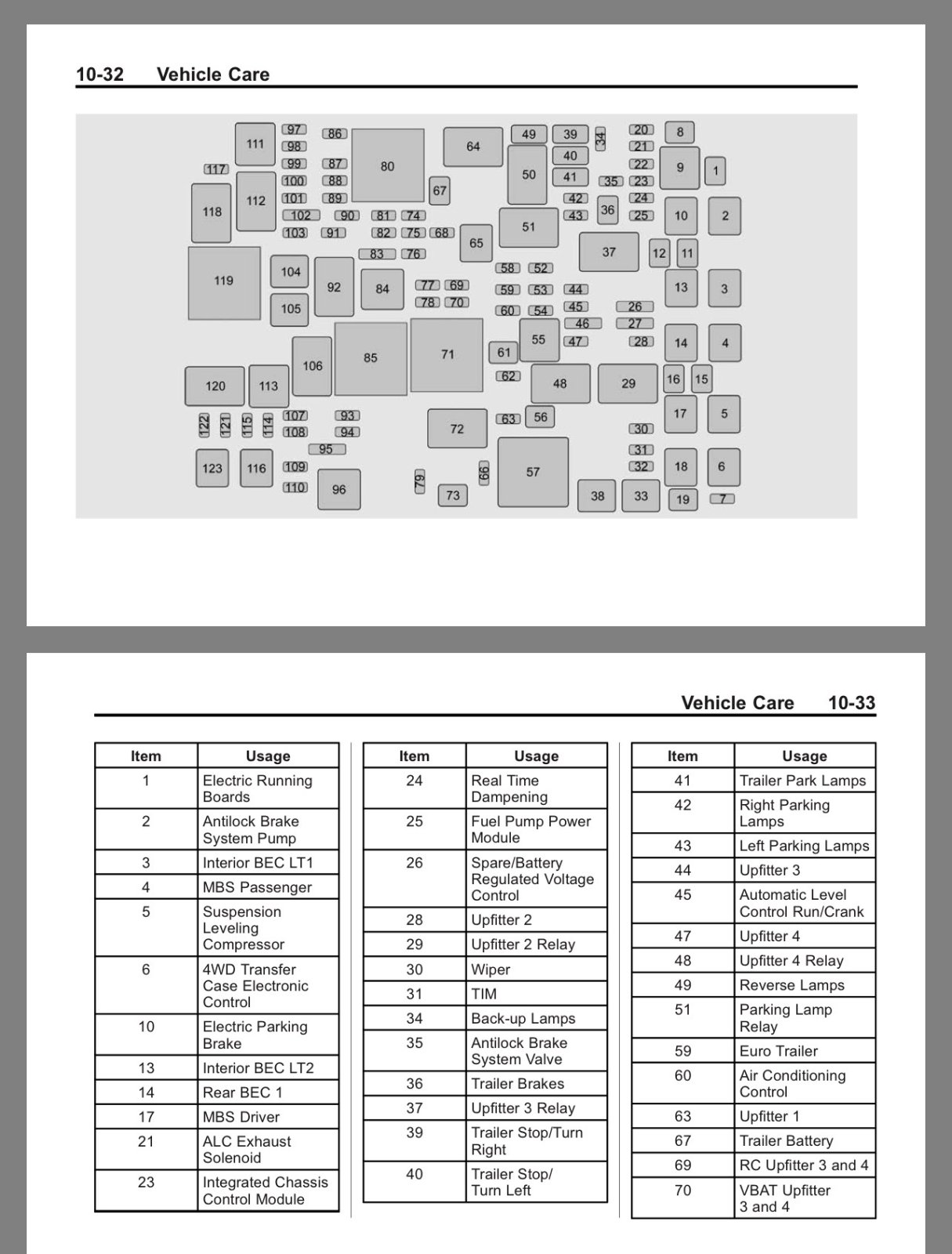

So 43 is fuse but not sure about changing it. Blinker gets power. I’ll mess with the wire under it. I’ve messed with it before. The reason I don’t think it’s bad is because everything else on the light works fine. When I swapped lights there was no corrosion or anything who knows road salt could get up there. I’ll mess around and report back
30,706
48,361
nope 40 is the left turn signal combo trailer stop/left signal
this what i mean by screwy gm crap
39 is right side
you can verify by pulling the fuse and see if the blinker still works, in case that is for trailer use only.
