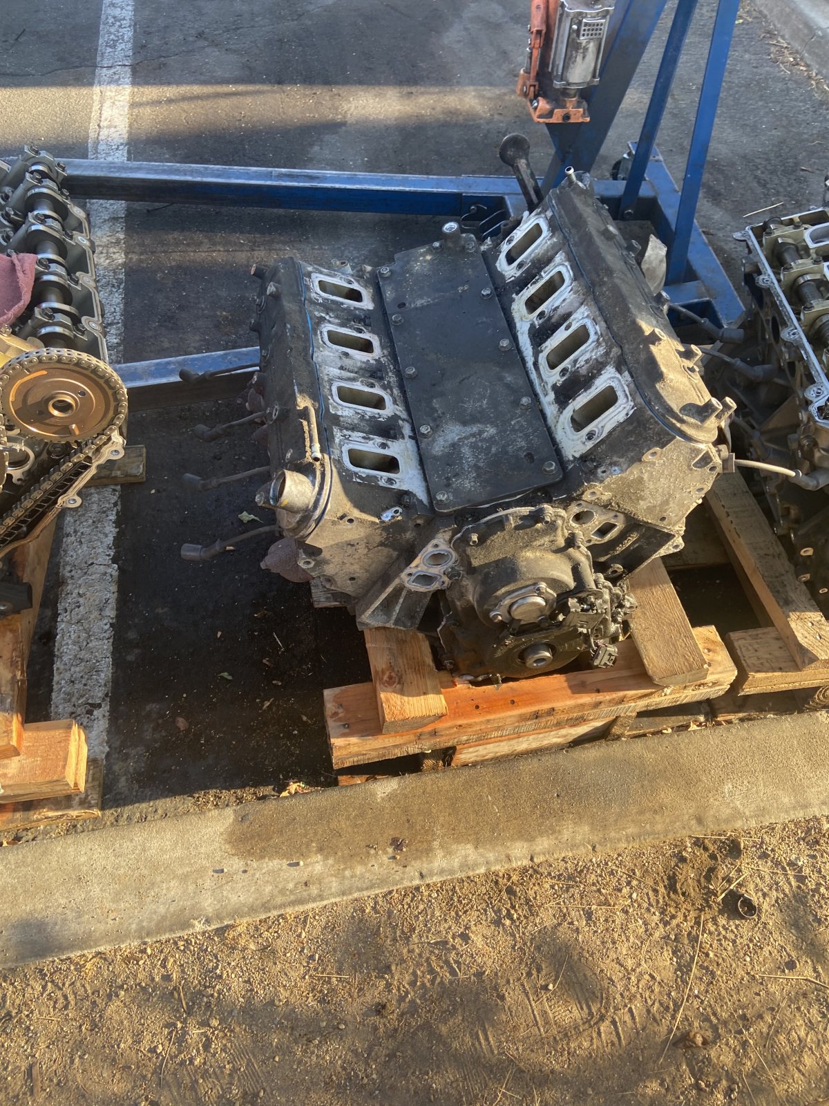

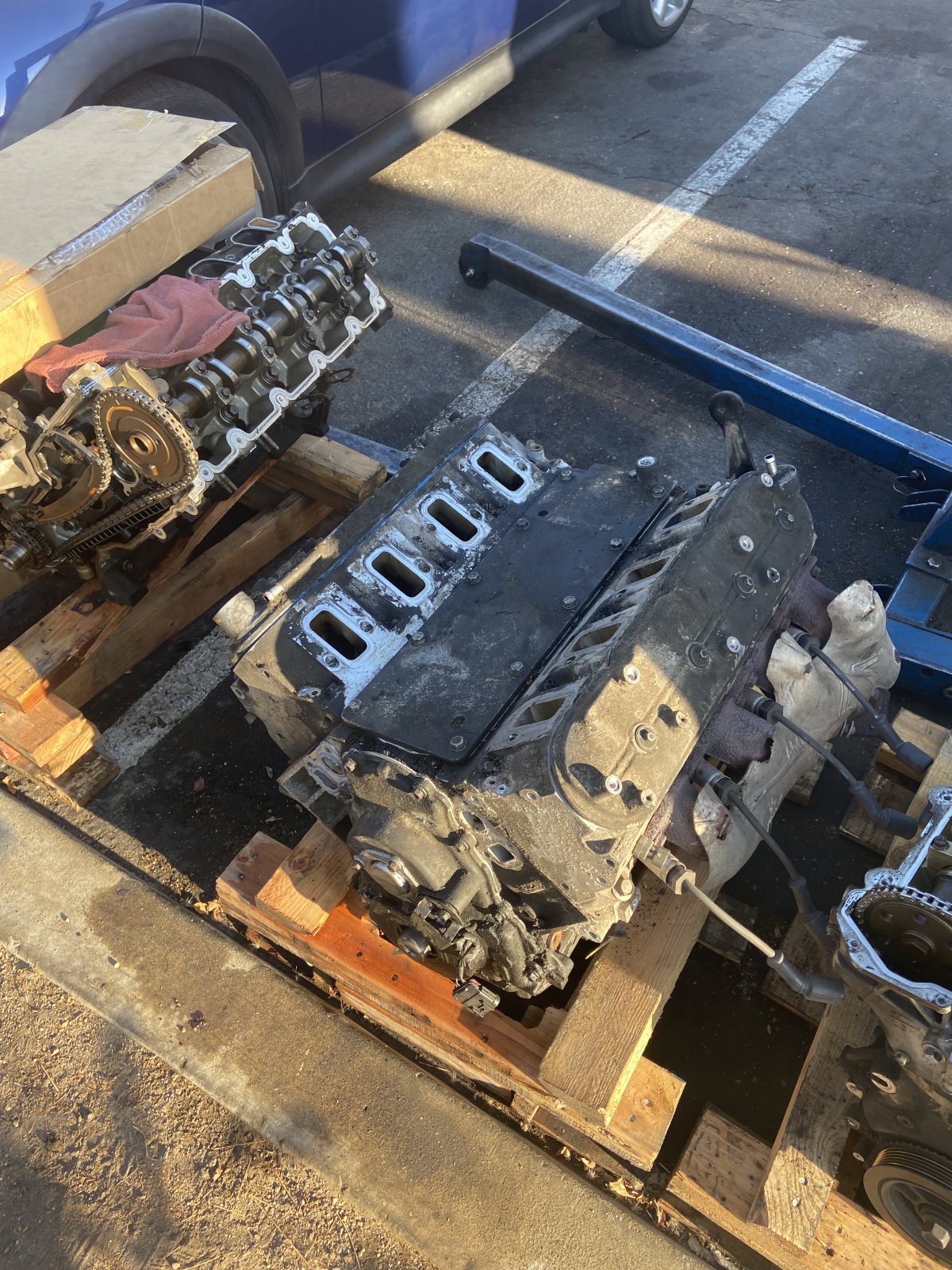

Take your truck to John at Destroyer Auto in Riverside CA. He changed my engine for $5100 on my 2008 Escalade and gave me a 6 year unlimited mile warranty. He changed it in the summer of 2021 and the engine is better than new. I would also buy all 4 OEM o2 sensors and give it to him to change while he is at it. If you buy the OEM engine mounts x2, tranny mounts, belts (I think he includes belts, ask him), all 3 pulleys and water pump he will change it for free or whatever you want to change when he replaces your engine out. The guy that changed the engine worked for GM for decades. John has the correct GM programmer and does neat and clean work. I already put 30k on the new engine and it sounds perfect, even on cold startup, no ticking whatsoever. When I hooked up the programmer I get all zeros on my fuel trims which means the engine he installed is in perfect condition with no flaws. The new engine includes spark plugs and wires as well. John only does engines and he can get it done in a couple of days. He will pick up your truck for free. John will go through everything and tell you what you need the day he replaces your engine. John can also look at your engine and tell you if he could fix yours instead of replacing too. Tell him Stephan with the 2008 Escalade from June 2021 sent you. If you need a A/C guy I have one also near chino hills. The A/C guy fixed my A/C for $160 when everyone told my it was my compressor. My A/C is doing great for the last 3 super hot summers so let me know. I have also a great driveway mechanic to change anything that could be changed in your driveway. If you have 130k than I would replace the engine because it won’t last much longer. Just call John and let him give you his advice. He is the best engine mechanic in South Cali. My rear seal was leaking on my 2008 Escalade also I had the oil pressure light. I spent 3k trying different things to fix an engine with 190k. I wasted 3k for no reason. The engine replacement might be your best bet.
I just told you what to replace with your engine so you probably will save a decent amount money by buying the parts from GMdirect.com and bringing to John.
John will answer his phone for you 24/7.
The first and last is my old engine and the three in the middle is my new one. John even replaced my header shields for free. He is awesome. I don’t work for him. I live in Texas now and I recently purchased a 2018 Escalade and when my engine fails I will bring it back to Cali to John for sure. I will have him order the engine and when it arrives I will stay in a hotel for 2 days while he changes my engine.

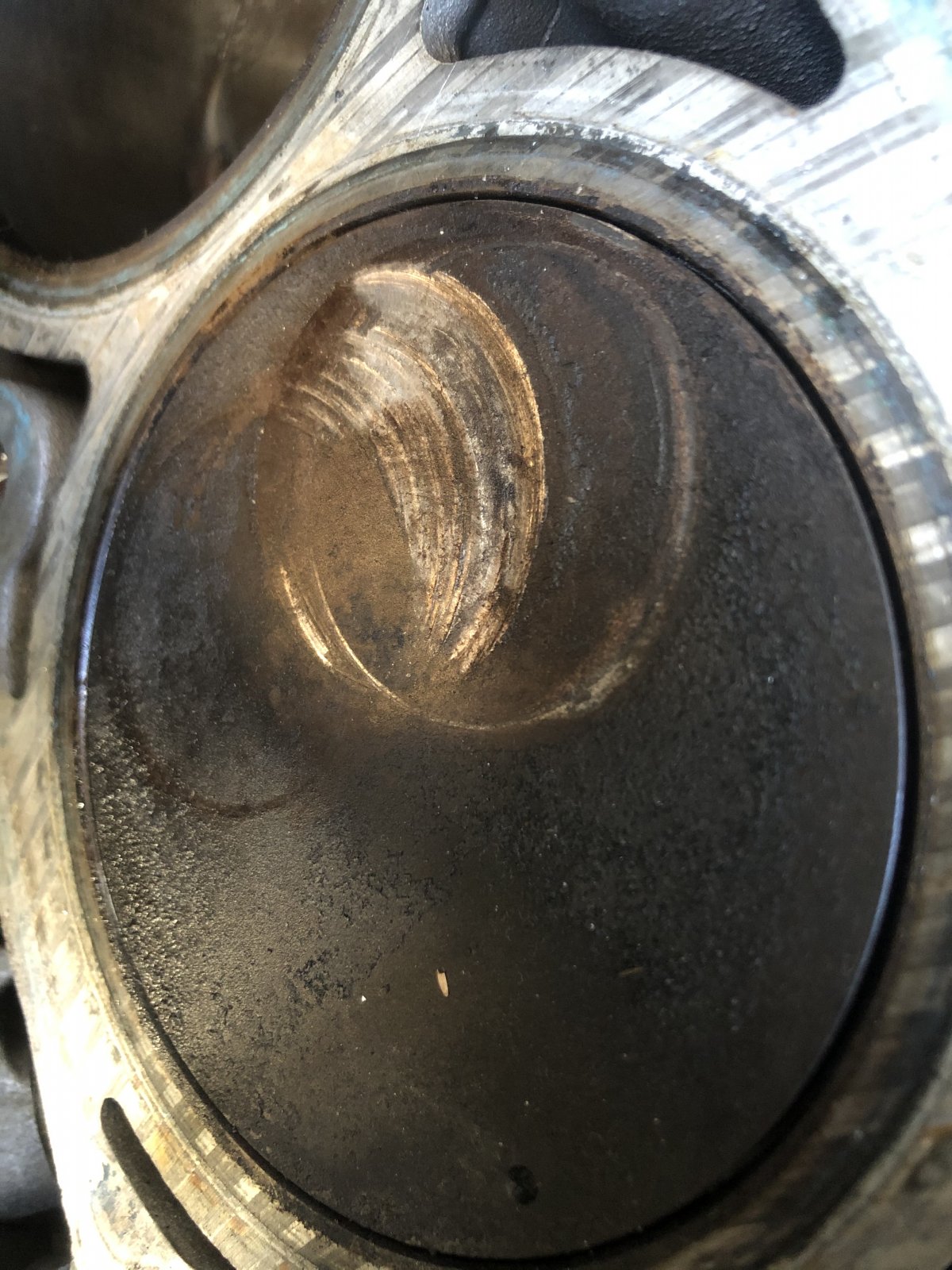

I scarred the piston on my Silverado when my valve spring broke and dropped a valve. I buffed it out and sent it! Still holding up good and running like a scolded dog!
