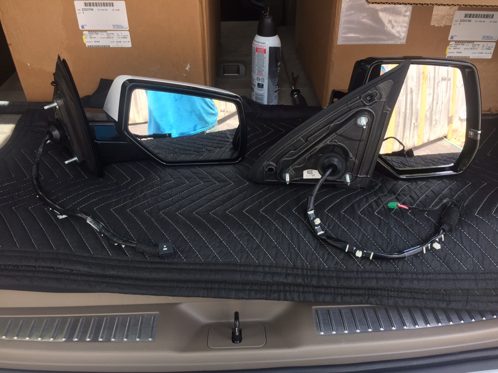

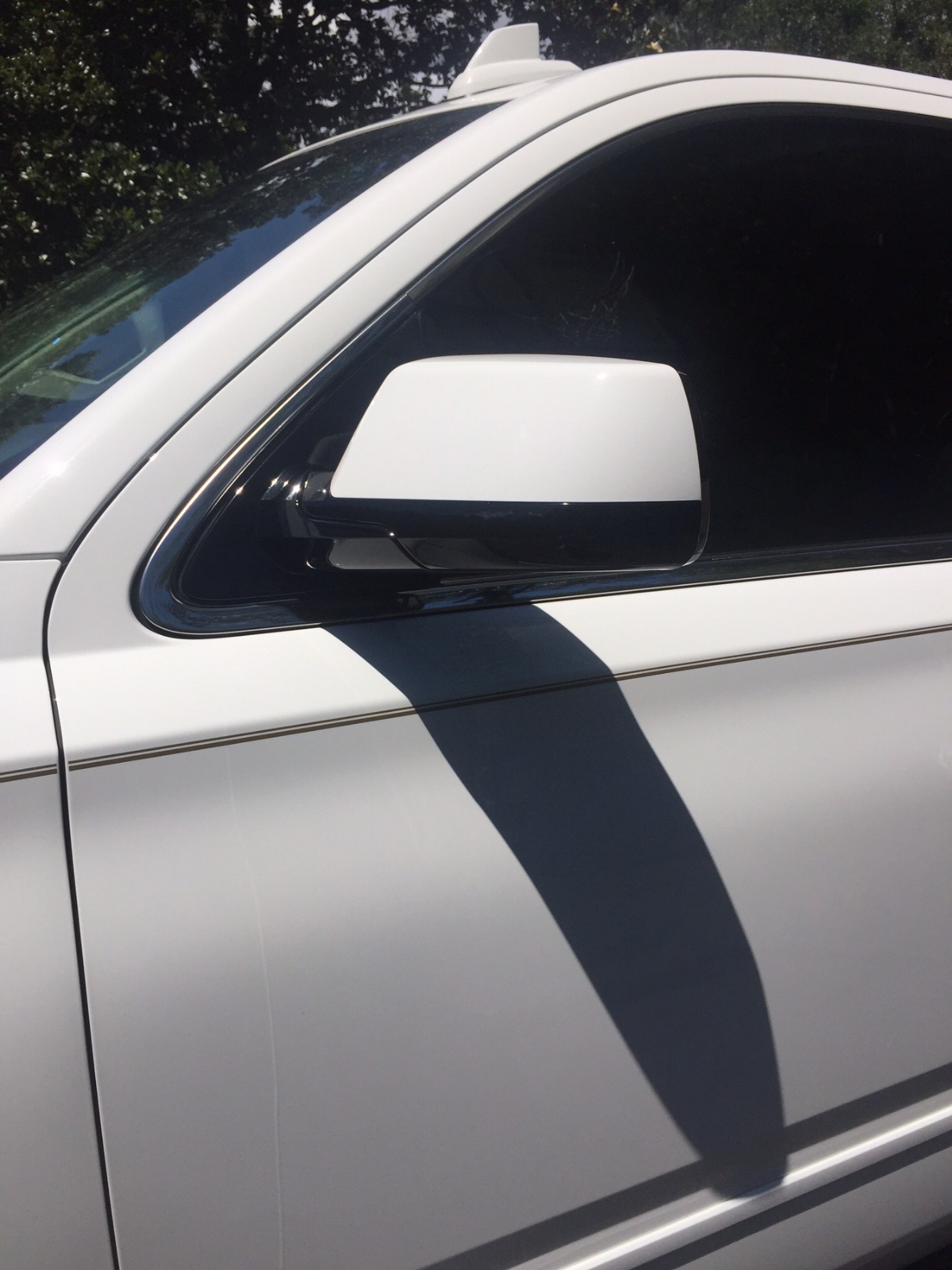

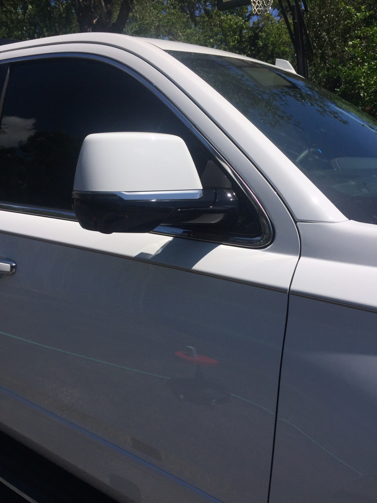

One option would be swapping in Escalade mirrors. They are plug and play. Although they don’t extend, they are much better than the OE mirrors.
Original mirror
Escalade mirror
Sent from my iPad using Tapatalk
Thank you for the suggestion. I wasn't aware that the Escalade mirrors are taller, but my needs are the extension mirrors due to trailer length. If I could obtain an accurate description of the wiring for each slot in the mirror and door plugs I could make my own harness adapter. Would you have that info or know where I could get it?
Original mirror
Escalade mirror

One option would be swapping in Escalade mirrors. They are plug and play. Although they don’t extend, they are much better than the OE mirrors.i
Escalade mirror
Dang. Those are atleast better! I'll have to look into sourcing a pair.
Yes, they’re much better than the originals. One of the best mods I’ve done.
