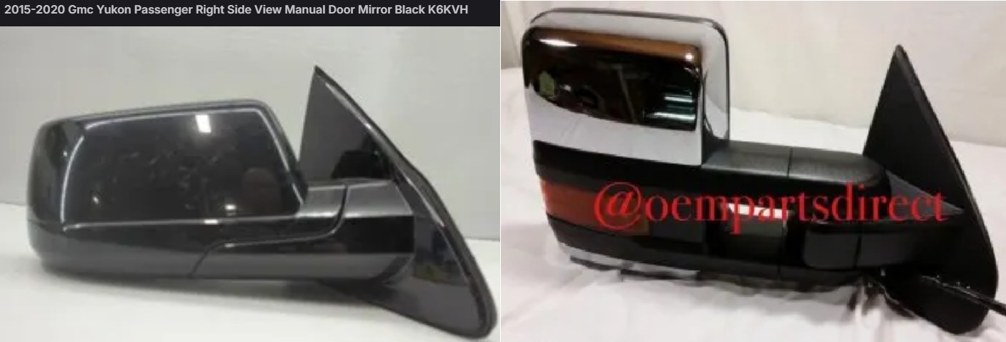

So I went to GMpartsnow.com to explore using Using the larger Escalade Mirrors.
http://www.gmpartsnow.com/auto-part...-v8-flex-engine/body-cat/outside-mirrors-****
Now...in looking at this I discovered that the mounting gaskets are the same for Tahoe/Yukon and Escalade...that tells me that they will physically fit up.
So, I called GM Parts and asked them. They agreed but cautioned that there may be a programming issue with the mirrors based on what equipment is installed on each particular vehicle.
I think they will work but a harness/programming change may be required...any thoughts?
