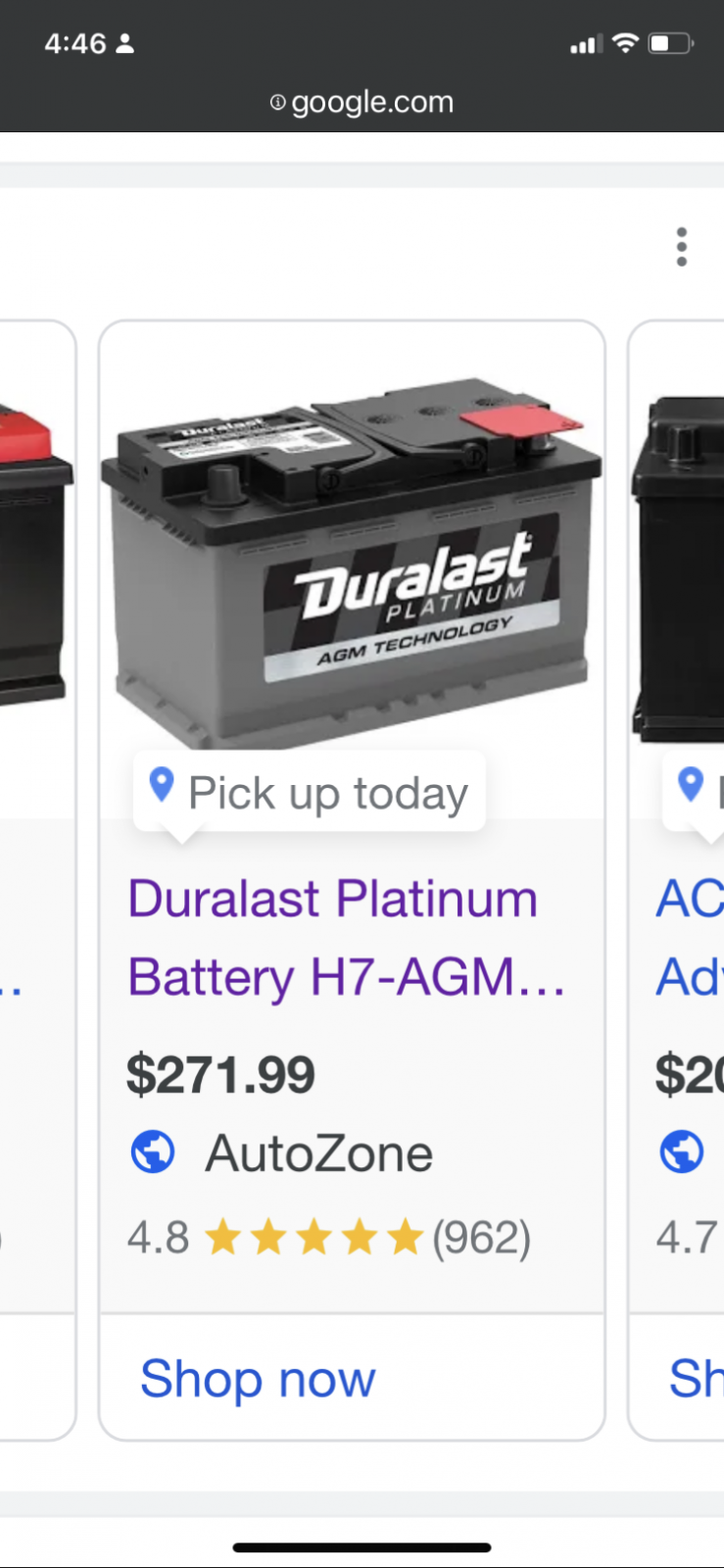

Walmart has the H7-AGM with 4yr replacement for $180 which is about $80 less than big box auto parts stores. and they only have 3yr replacement!

I bought the Delco Gold battery 42 month in 2/2022 for $220 and it failed while I was away on a Saturday on 12/2022 where I was 300 miles from home. I did not want to keep calling OnStar or look for a jump every destination I went too and wait until Monday and risk damaging my computer or something else. I also did not want to drop off my truck and leave it for a day or two at the dealer for a battery or wait 5 hours at the dealer. So I went to AutoZone and purchased an AGM platinum battery which I changed myself in 15 minutes using the tools at AutoZone. I lost out on $220 but I learned my lesson. It is easier to go to any AutoZone in the country and give my phone number & they will replace my battery under warranty or prorate it. The battery comes with a 3 year warranty. The AGM battery is better because if your like me and always clean your truck where you drain power then charge the battery then AGM is better for you. They said AGM will last twice as long.
