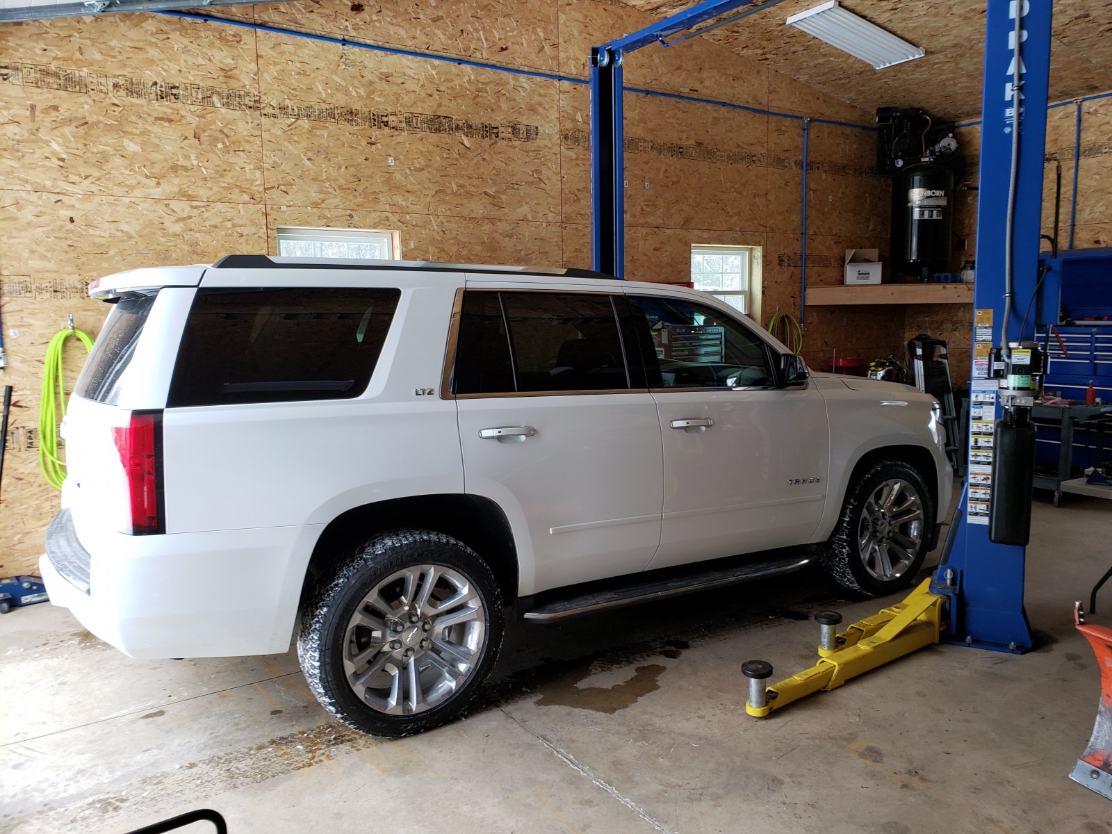

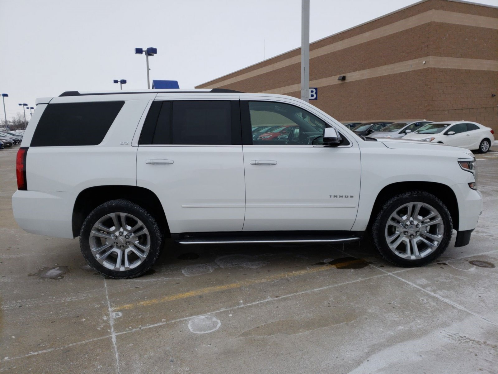

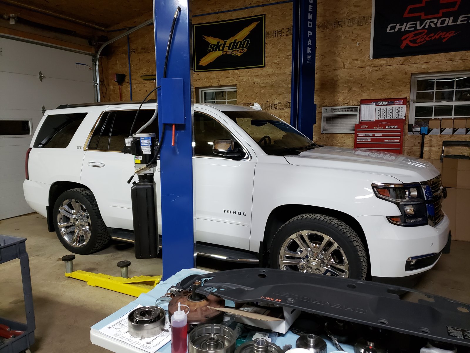

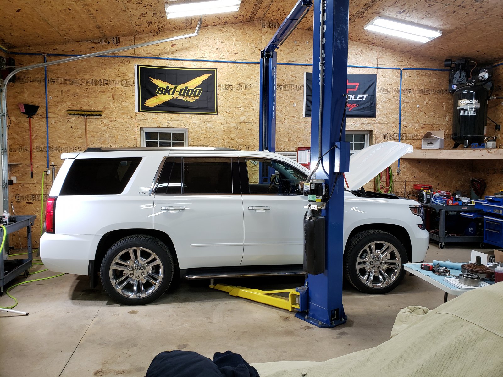

I did get everything installed and the rear lowering kit was excellent and now the rear is level with the front all measurement are at 35 1/2" 20190411_233000.jpg 20190412_010556.jpg
20190301_101707.jpg 4.jpg Bottom 2 pics are when i got the truck
C
craigk
Dec 28, 2011
18
I did have to adjust the headlights down as you can see in the pictures the black line on the cardboard is the line with the stock rear height and then with the rear lowerd the black line is much lower I did have to adjust the lights down 2 1/2 turns to bring it back to the stock headlight level
