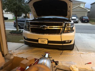

Exterior Disassembly
Start the engine and turn the wheels all the way to one side.
Remove the 7mm bolts securing the felt wheel-well cover on the front bumper.
Get under the bumper and remove two 10mm bolts and a clip holding the felt cover on from each side of the truck.
Reach in and remove four 10mm bolts holding on the fog lamp blanks. (the left-most screw is out of view in the image below due to the angle)
Put the new fog lamps on, turn your wiring up through the fender and into the hood area, and put it all back together if you'd like. Don't forget to secure the wiring with a few wire ties to keep everything tidy.

All lamps on
Parking lamps and fog lamps only
Fog lamps off
