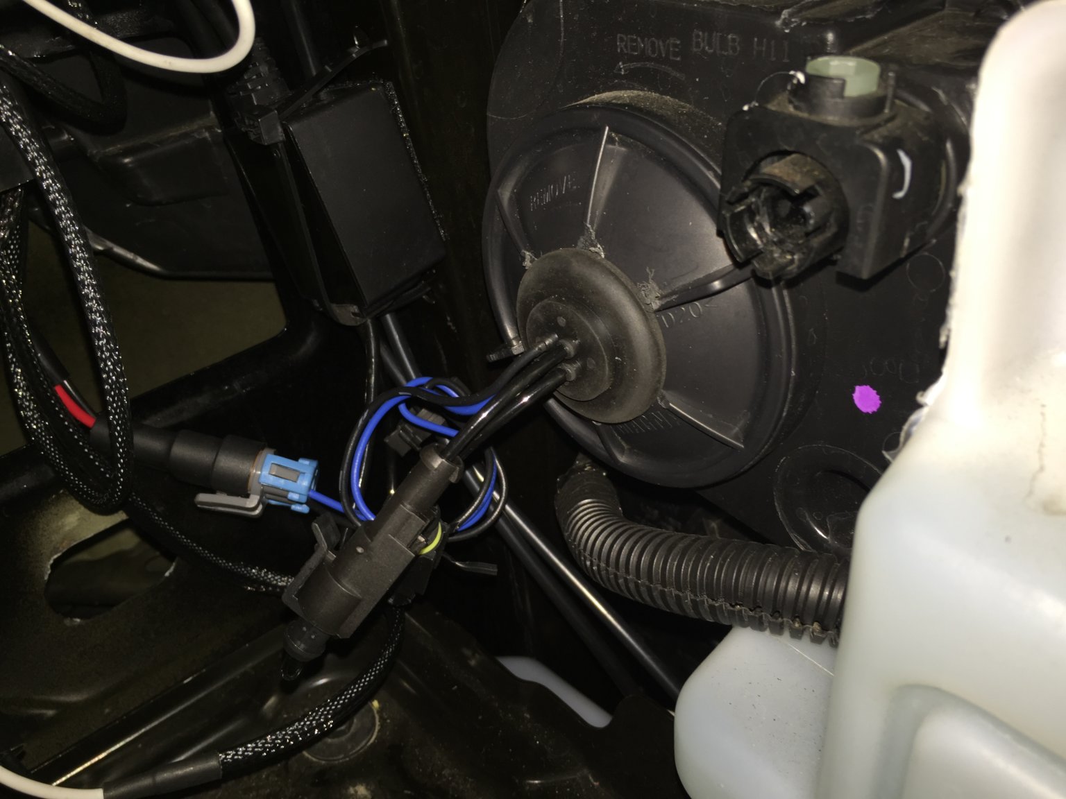

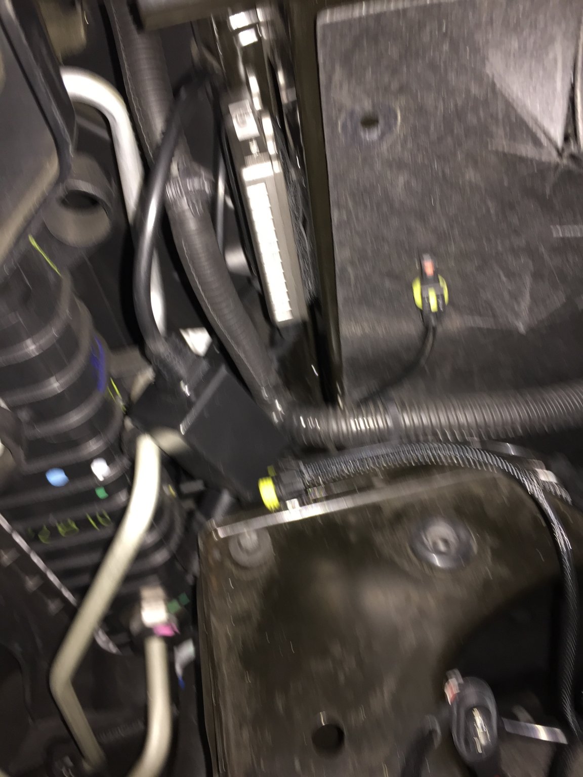

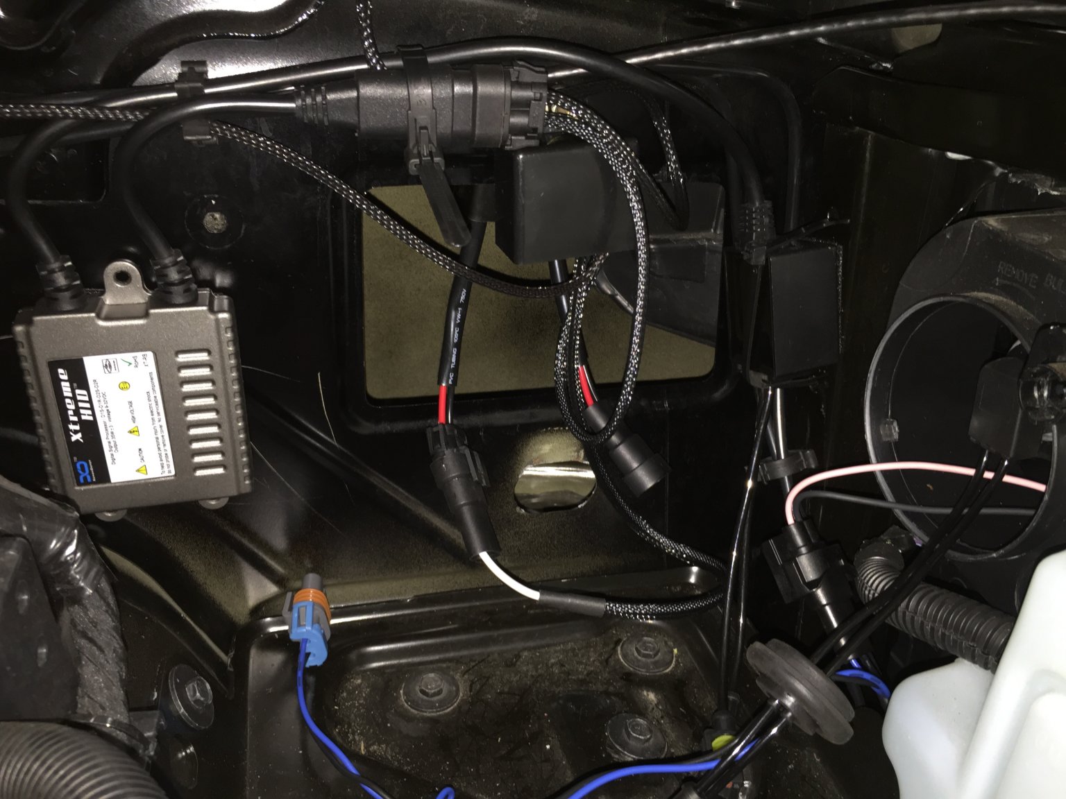

this is the driver side, attached the ballast to the side with velcro.
The canbus and the relay went together on a lug on to a hole together their backs attached to eachother.

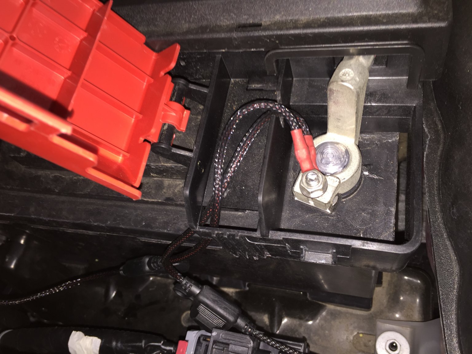

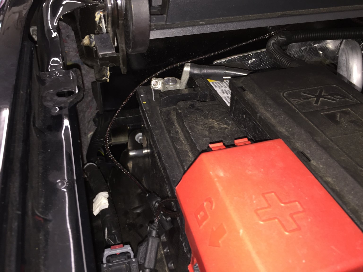

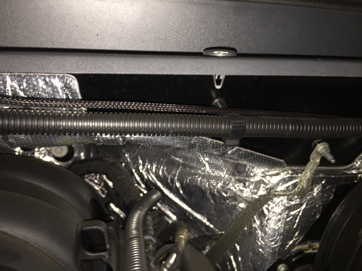

Ran the cable to the battery under the back of the hood where there is a cable running alongside.
went around the corner to the battery
cut a little spot to accomodate the wires going in to the terminal
driver side, what it looks like after install.we ziptied the black box coming from the bulb to the a metal post on side of the headlight.

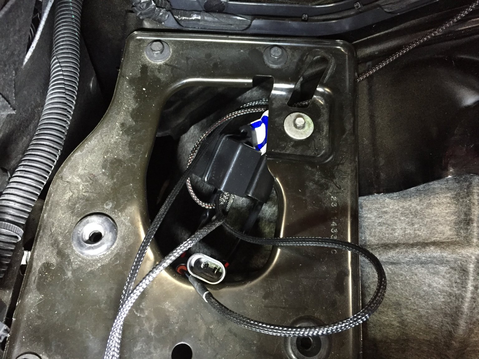

Passenger side

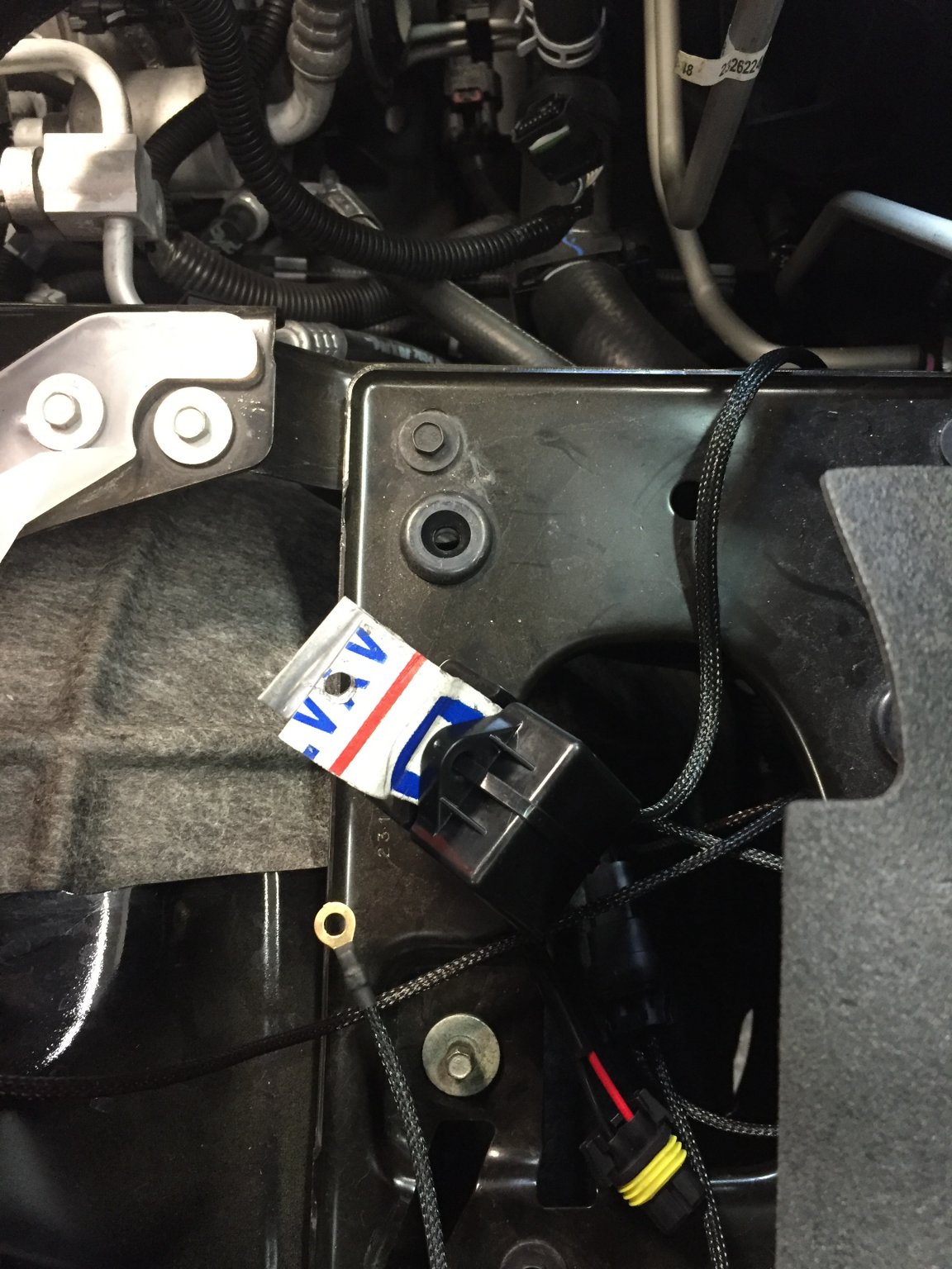

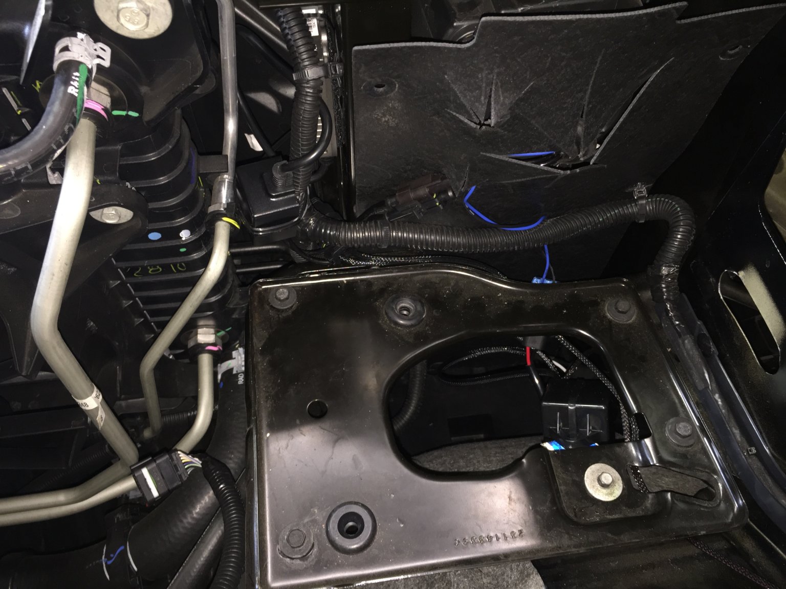

this is the top view of the tray under the airbox.
the only place we found good enough to put the the capacitor n relay was right under the tray.
we kinda fabricated a little holder for the capacitor n relay attached together backs touching eachother to that fabricated attachment and used a lug hole already there.

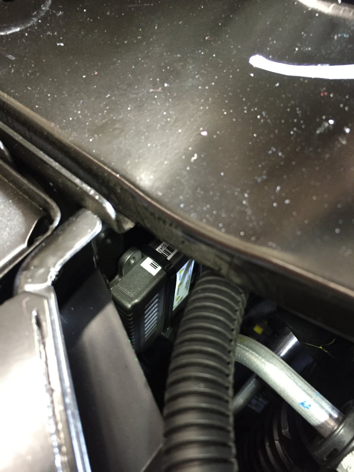

picture of the ballast installed to a post right next to the passenger headlight.very tight spot.
ballast attached next to headlight.the black box got ziptied to the cable there to make it stable.
