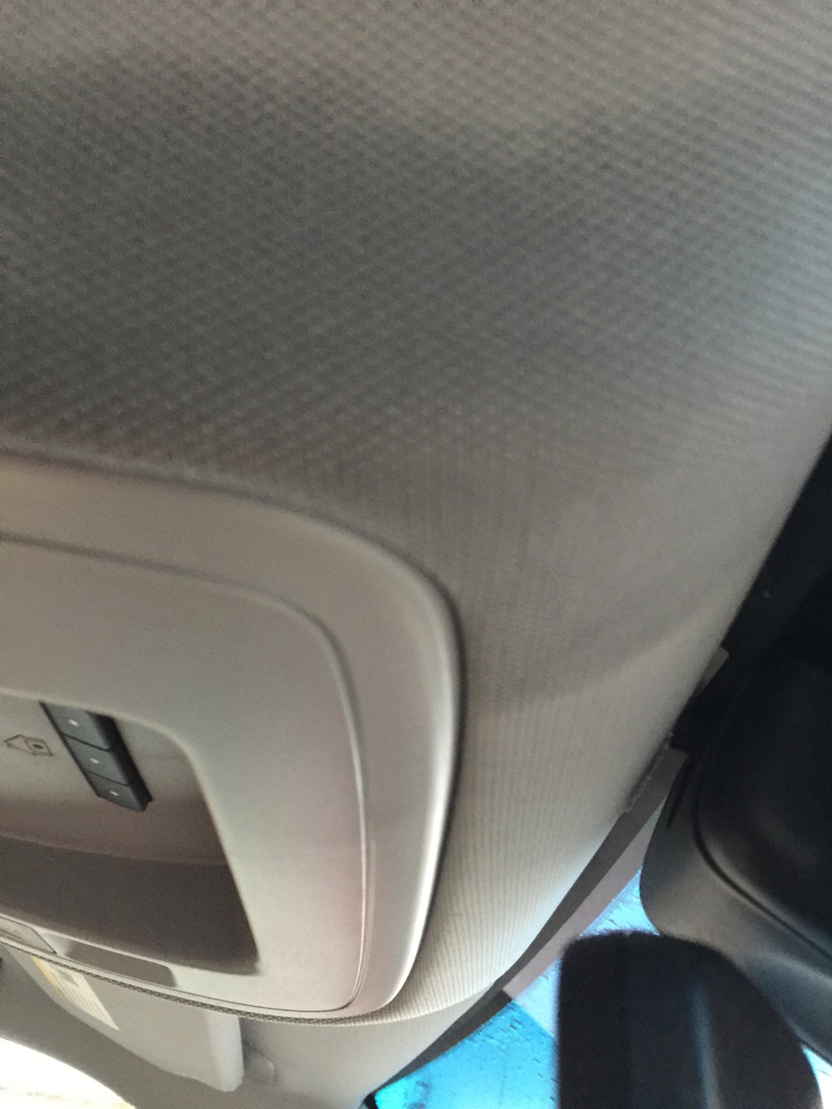

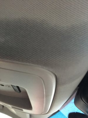

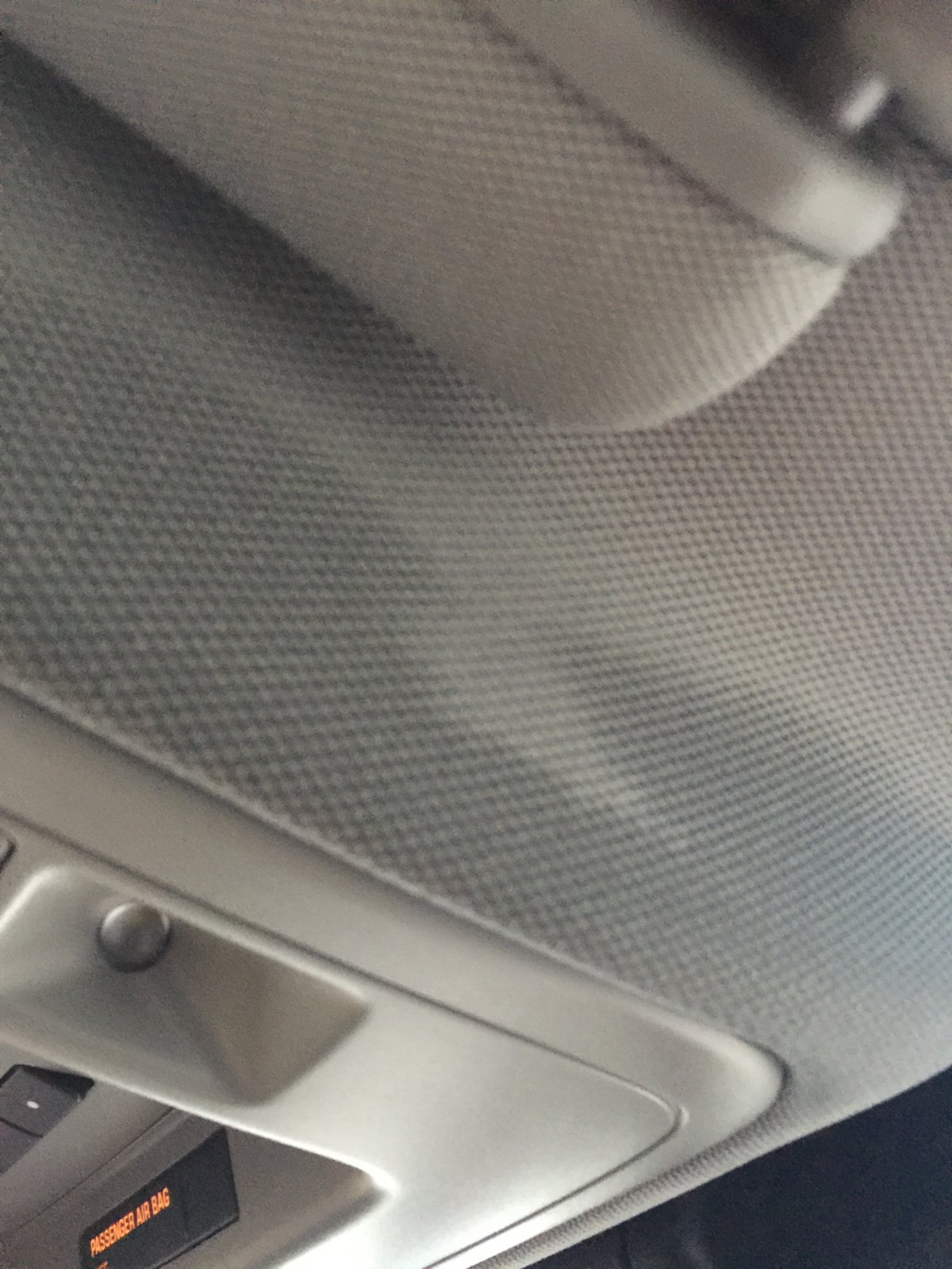

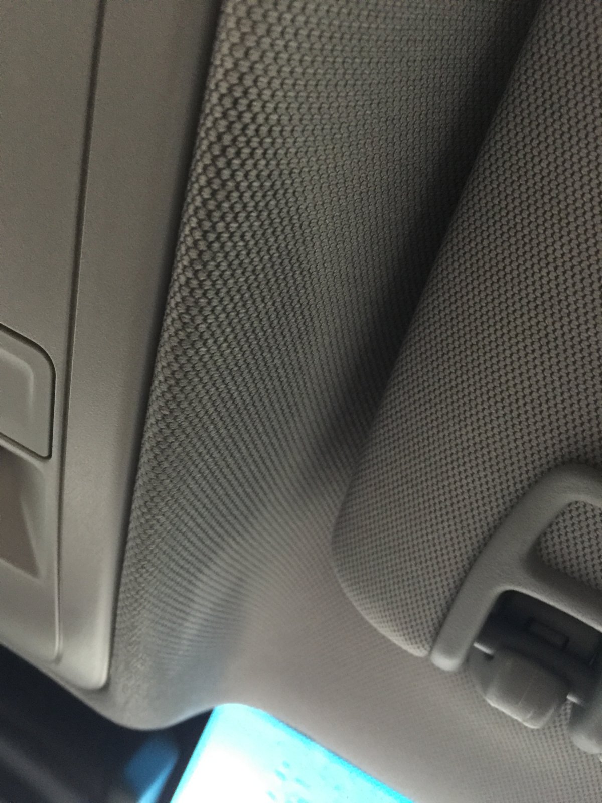

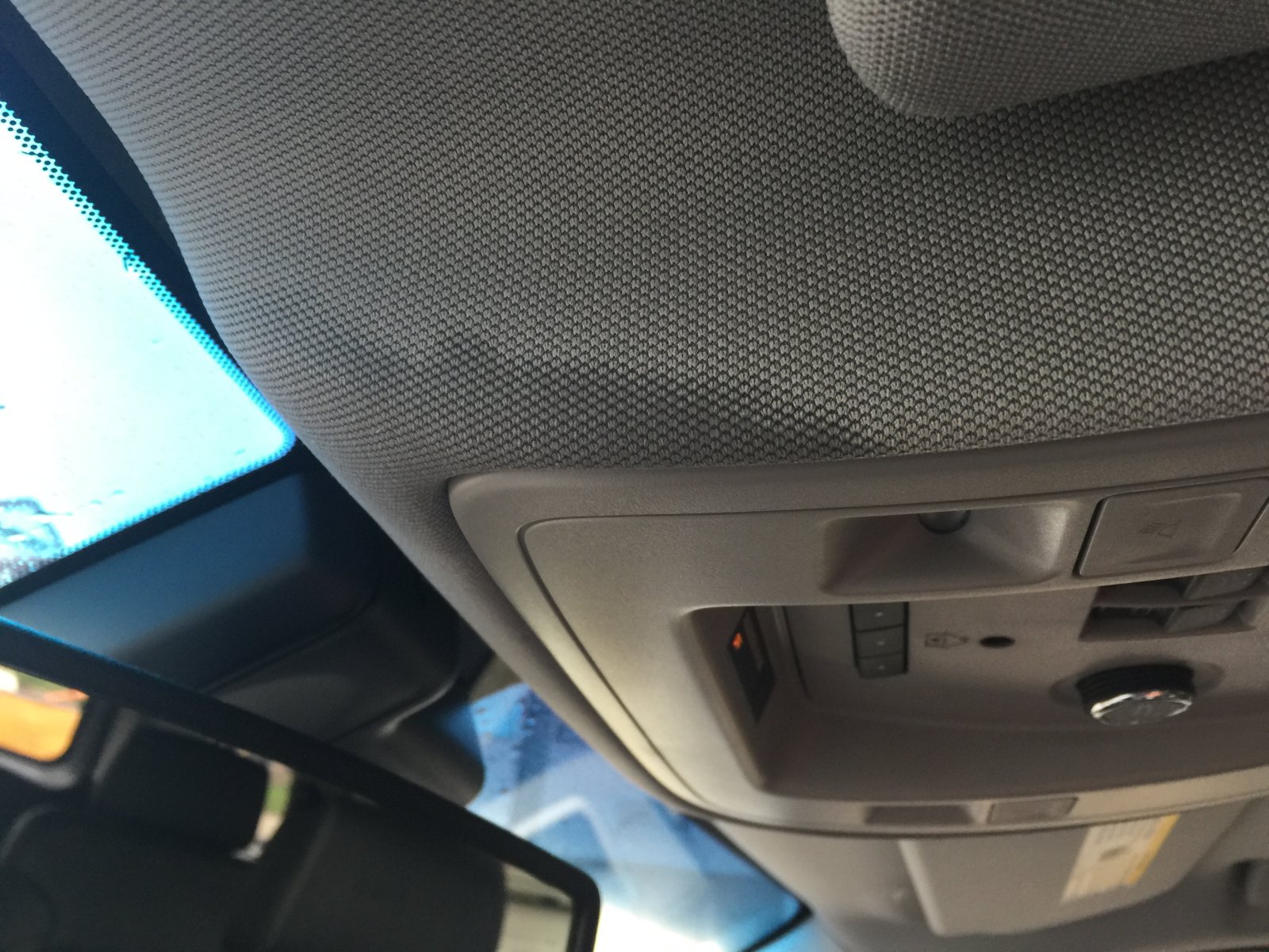

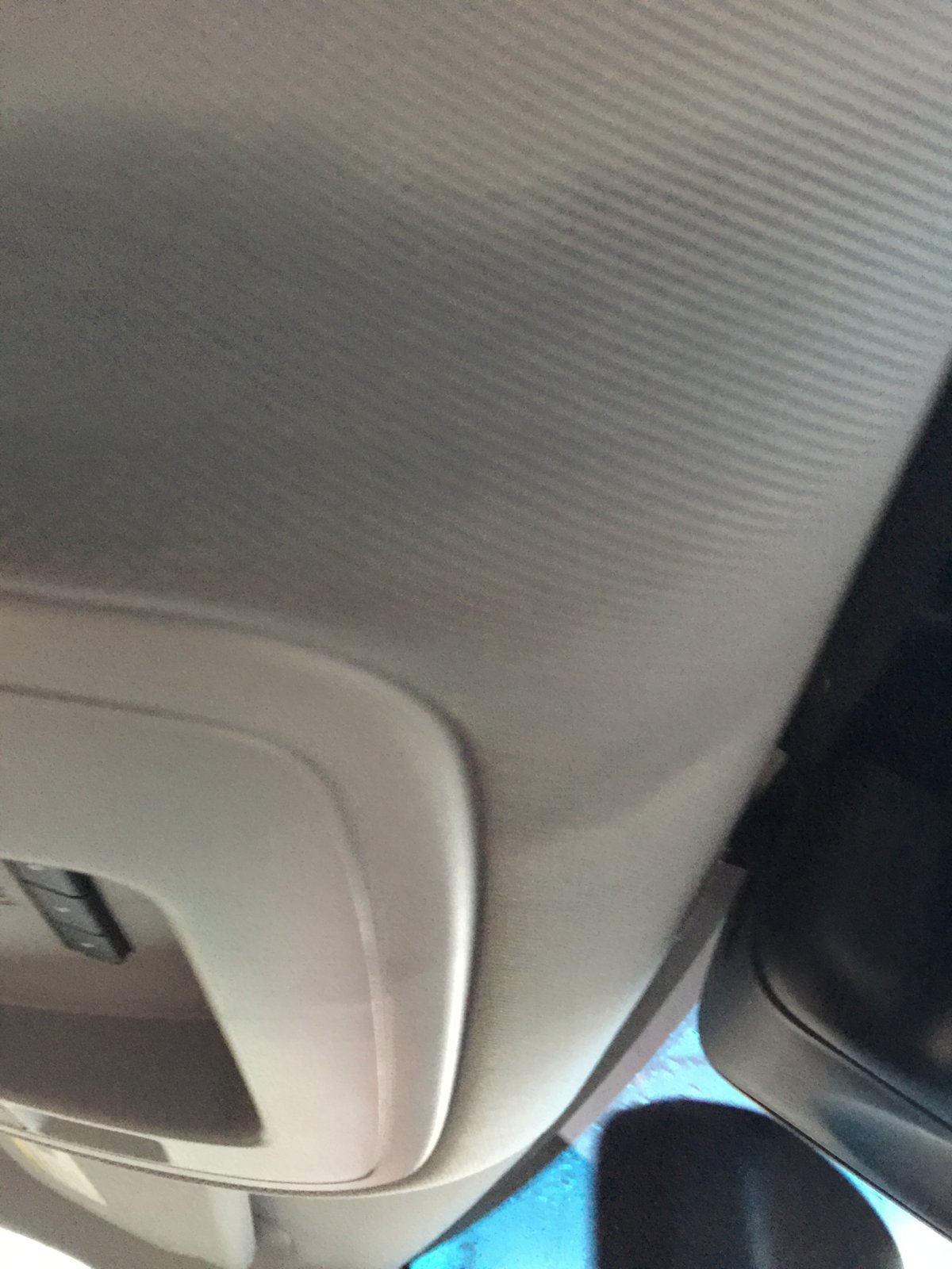

I purchased a CPO 2015 Yukon Denali XL in May 2016. Shortly after purchasing my truck, I noticed that the Sunroof sometimes leaks when it rains. I didn't notice it right away because it only happens when there is a lot of rain and then the headliner starts to leak pretty bad near the front roof console. I took the truck into the dealer for service and was told the Sunroof was "out of alignment" so, the sunroof was then realigned and the truck ran thru the shower to verify it was not leaking anymore. Since that 1st time that this happened, I have had this same issue happen 3-4 more times. Each time, I will only notice the problem when it rains a lot and the headliner starts to leak really bad. I take the truck to the same dealer each time because they are the only dealer in my area that has the shower to check for leaks. Each time I am told the Sunroof is "out of alignment" and needs to be repositioned. I ask what keeps causing this issue and I am told "I don't know." I am now having the same problem again. It rained the last 2 days here in NY. Yesterday, when me and my fiancée went out to the store, she noticed she was getting wet sitting in the front passenger seat. I then notice the headliner is soaking wet around the roof console again so I assume the sunroof is out of alignment, again. The last time I had the Sunroof alignment corrected, I decided not to open or close the sunroof to see it that was causing the problem. I have not used the Sunroof since the last time it was "re-aligned." But, the problem resurfaced again. I am now very concerned that this truck has a body or bent frame issue that was never disclosed to me when I purchased the truck or some other issue which is causing the sunroof to shift. I need to get this issue resolved. The water leaking into the headliner is not good and may be causing mold, mildew and/or electrical issues. I chatted with GM support today and they opened a case. I was told I will receive a call back within 2 days from a Senior Service Advisor. Anyone heard of or experienced this type of issue with their Sunroof? I've checked drain holes and they are good. I really don't think the leak is coming from the Shark fin and do believe I might have more serious issues. Hoping To get to the bottom of it and get it resolved ASAP. Any feedback is appreciated...

I knew it was not the Antenna because of where the leak was showing up. BUT, the dealer insisted that it was the Antenna. So, they replaced the Antenna at the tune of $470. I fought with GMC Customer Service and the Dealer because this is a leak I have been complaining about since I purchased the vehicle. But, they still told me I had to pay for it. So, they just replaced the Shark Fin Antenna. Luckily it was raining the day I took it to the dealer. On my way home after getting the Antenna replaced, not even 10 minutes of driving and it started leaking again!!! I called the dealer and the service advisor spoke to the Mechanic and he swears when he removed the Antenna there was water and rust in it. But my truck is still leaking in the exact same place it was leaking in for the last 2 1/2 years! I am going to upload pictures of the location of the leak. I have a case opened with GMC. The Senior Advisor I am working with is very nice but, GMC is not doing enough. This leak is very frustrating and I have been dealing with it for over 2 1/2 years! I am so tired and frustrated with this. My truck can sit in the rain for days and no leak but as soon as I drive in the rain, leak. This dealership is supposedly the only dealership near me that has the facilities to deal with leaks, They place the truck in a "shower." But, I keep telling them when sitting the leak does not occur; only when driving in the rain does leak occur. It only happens when driving in the rain. I have told them this several times but they do not seem to listen. I am going to leave the truck with the dealer this time and hope they can fix the leak. If not, I will take it to another dealer. After that, I need to hire a lawyer. GMC is also aware of my concerns with future rust problems in the headliner and possible electrical problems in the roof console. I made note of this in the case. Will keep you 'all posted on this irritating recurring issue...

that looks more like a leak from top of windshield than sunroof.
especially given you state , only happens when driving in rain.
