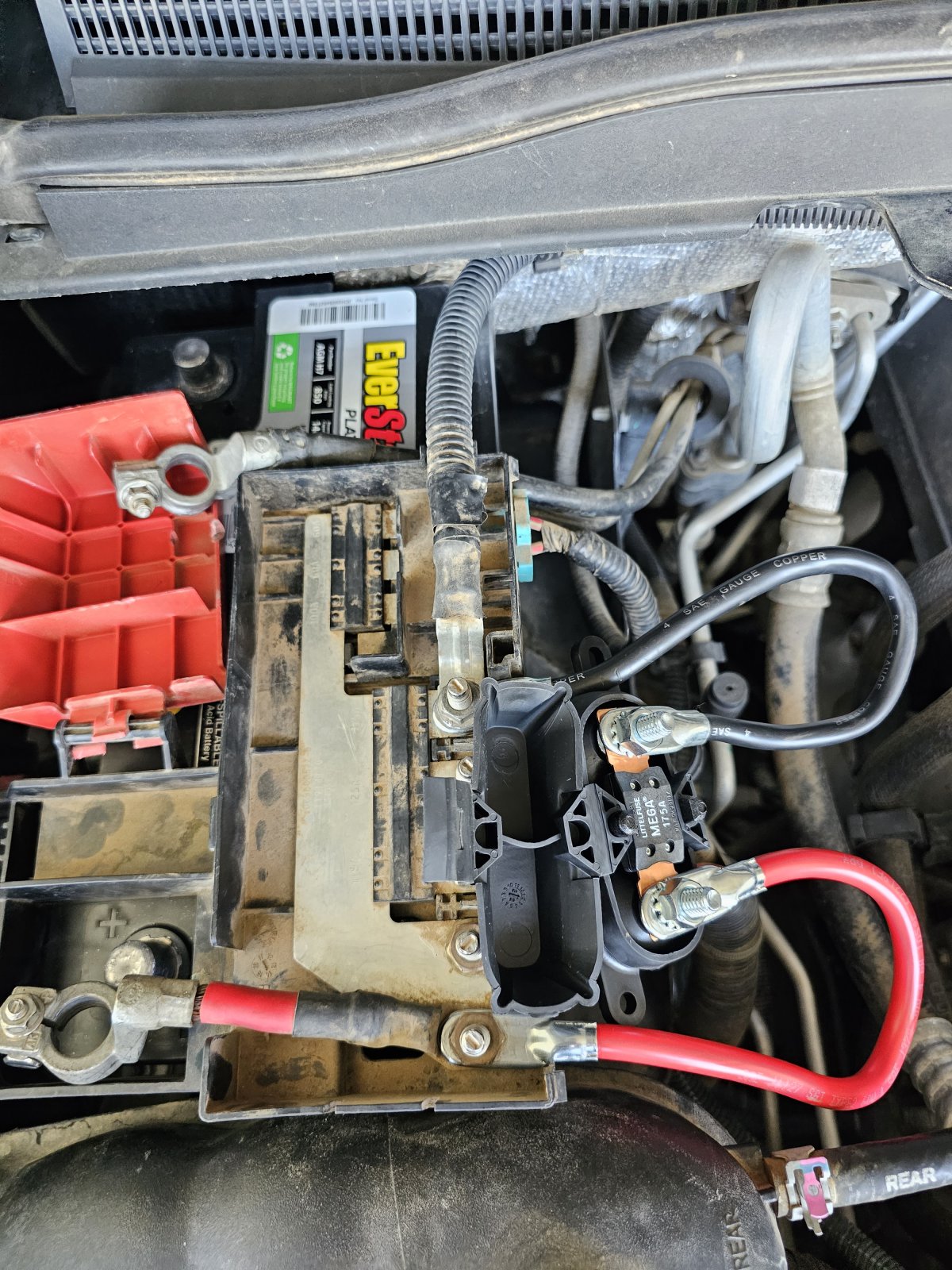

Ok, my meter thankfully has a continuity test so I figured out there is not continuity on the 175A fuse that connects to the alternator and another cable so that makes sense. I see one unused fuse but it's only 125A, I guess it's probably not a good idea to try that one just temporarily?
*** Scratch that, 170A alternator..... what about connecting it to the unfused post?

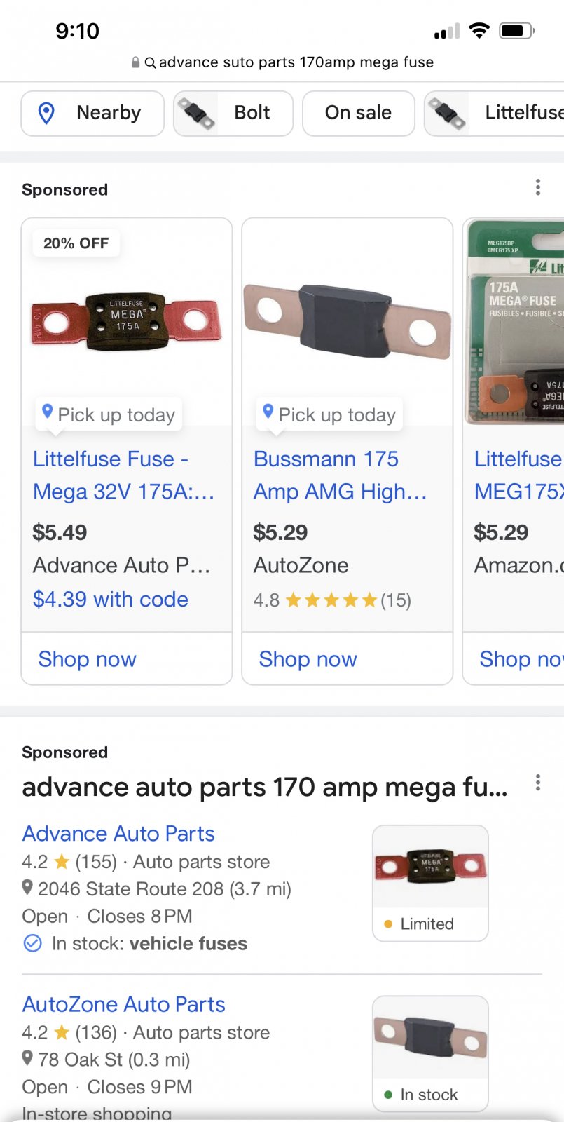

Dealership service departments all closed today and possibly tomorrow. Advance auto is not going to have this but I am considering going there for a 175A mega fuse and see what I could cobble together.

Best solution I have at the moment is 2 short battery cables with a 175a mega fuse between and connect the cable between the 1st post with the bad fuse and the last post that also connects to the battery positive. I just need to see if the parts store has those bits. That I could drive on indefinitely.

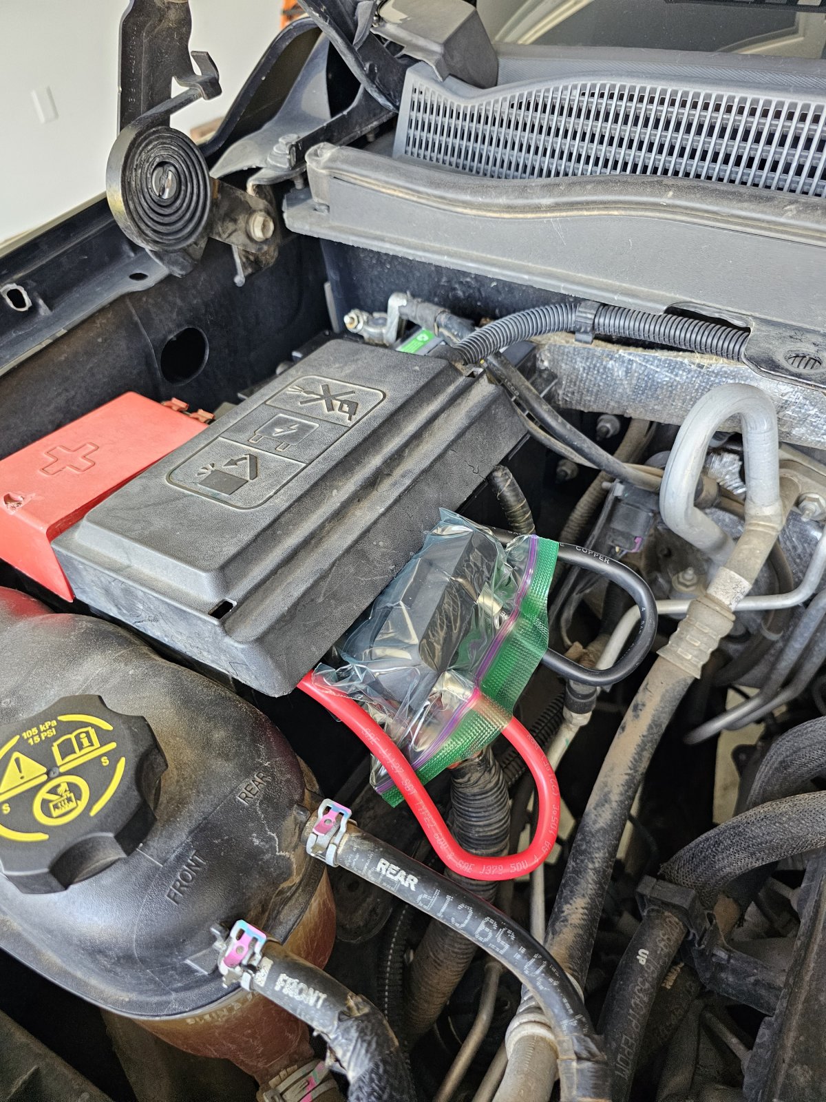

Well she is up and running. About $40 for the fuse, holder, and cables. I threw on a baggie for a little extra protection. Thanks so much Doubeleive for the heads up!
