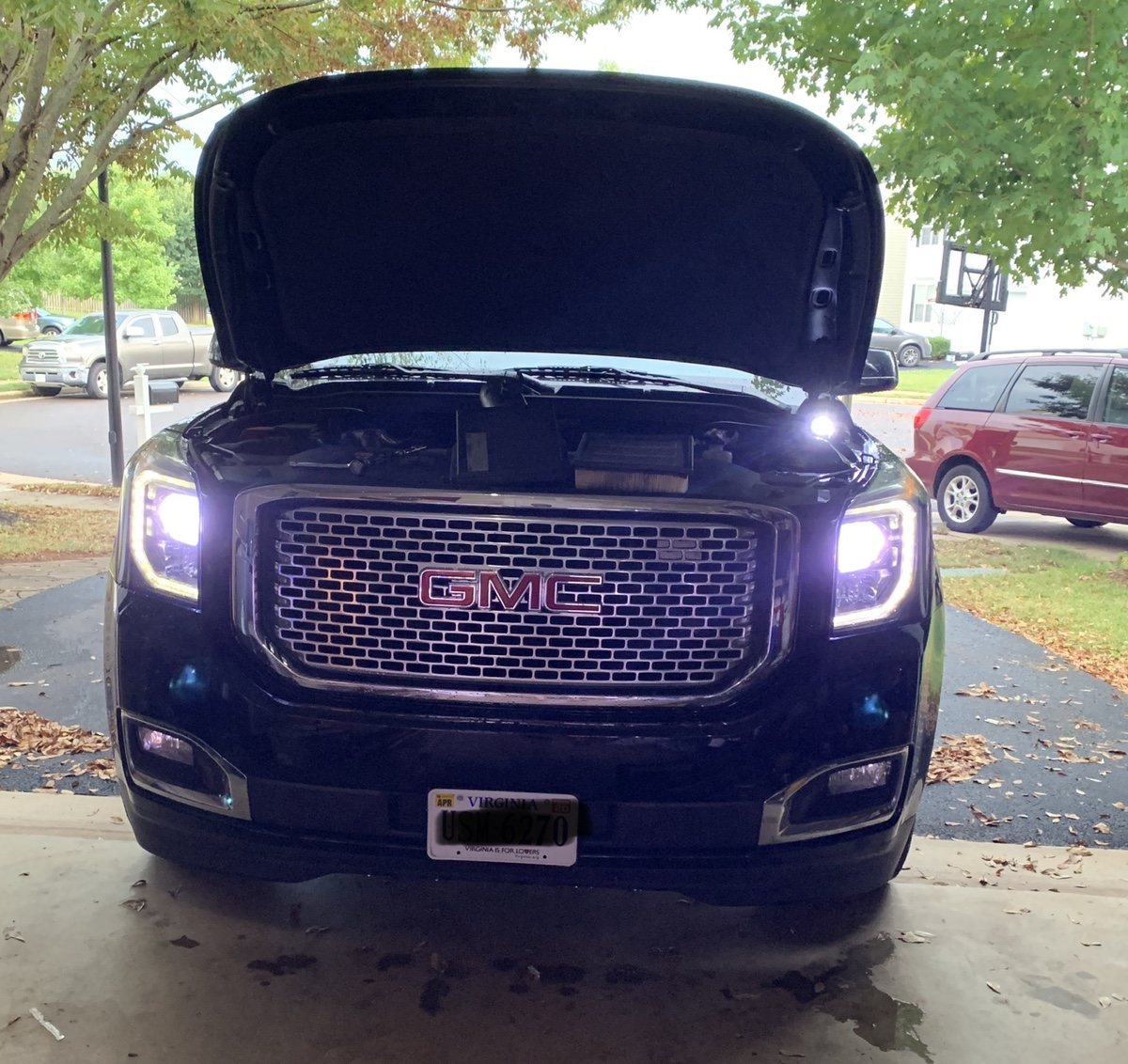

Complete. Took about 30 minutes.

I did go with the philips. I will give my thoughts after I drive at night. So far, this morning at dawn they look great. Color is exactly what I was hoping for.

So driving tonight the lights look good but I noticed a flicker every so often. Not sure what that could mean. Both sides. Maybe alternator?

Everything snapped in pretty snug. It’s not bumps causing it bc it happened while parked. I’ll have to troubleshoot some more today. I’m also going to contact HID Concept who I bought the lights through.

Alright, so after driving this morning they flickered a few times in the first 30 seconds or so then stopped. It's almost like there's a warm up period or something. I also turned my ac on and off to allow the compressor to pull power and that didn't cause flickering. So, we'll see how the next drive goes.
