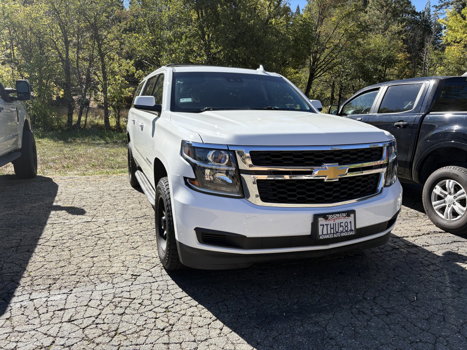

It's a 2015 Suburban LT, 188,000 miles, 4wd, standard shocks in the front with a little lift block and air shocks in the rear, don't really know much else about it other than it had every oil change on the carfax.
Interior is perfect, exterior has some dents. $16.2k out the door before financing. There was also 2020 Suburban Z71 with 140,000 for $29k on the lot but the interior was trashed. Happy to get into one of these for such a low price.
Replaced the oil and trans filters this weekend, everything looks good. Waiting for Black Bear tune in email then we will be ready to... commute to work and back.
Only plans so far are some bilstein 5100s and to replace a noisy belt pulley.
With that mileage, the transmission failure has probably already occurred. Mine made it all the way to 159k before it croaked.

@Sparksalot I am hoping that most of the points outlined earlier in the thread have been addressed at this age and milage. One thing I can see is I need to flip the pill in the trans thermostat, I understand that's a must on these even tho my 4l60e runs at 190 no problem

I was going to say it looks like an LT, same thing I bought the wife except 2wd, a couple bells & whistles, but not LTZ bells and whistles
shouldn't give you too much trouble
you'll probably want to add fog lights for better visibility at night and HID or LED bulbs instead of the incandescent will be an improvement also.
the escalade mirrors are plugnplay and larger, better visibility
the superchips FR2845 F5 from Holley will let you dial it in a bit and won't break the bank. it will let you turn off v4 mode and put a transmission tune on it, adjust tire size, limiter, etc if so desired. I bought the refurb for like $340, holley does not have any refurbs in stock but this place says it does
I used the trans-go tstat eliminator. Same effort as flip the pill, but no doubt it’s in there correctly. This summer I added a tru-cool external transmission cooler.
I have no idea if the ac condenser was previously an issued. My transmission grenade took out everything in the fluid path, so I have a new condenser now.
I also did the Holley super chip tuner mentioned above. V4 is gone.
