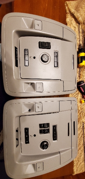

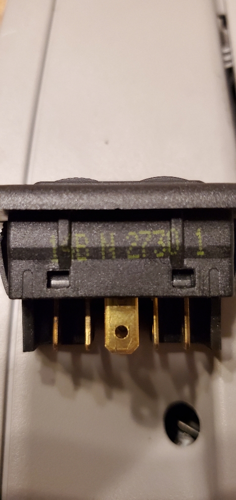

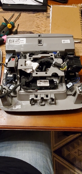

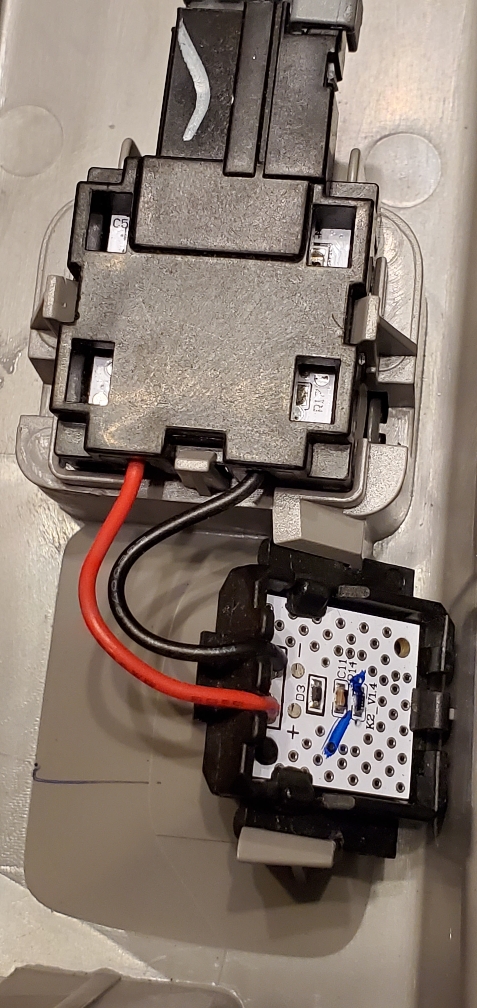

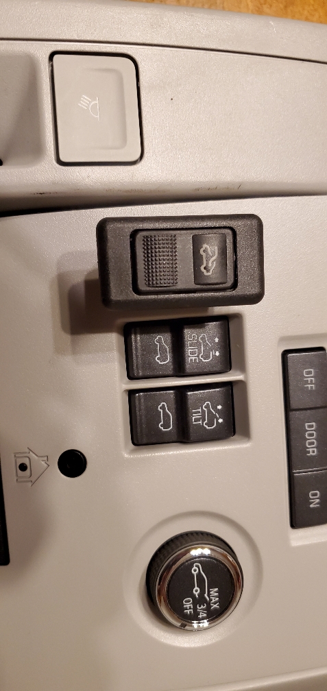

I replaced the complete overhead console with a BRAND NEW $30.00 OEM unit from eBay. These must have been damaged units from the assembly line because they are packaged like a factory piece. Everything swaps over...except the sunroof wiring and switch is different (no biggie...I have future plans for the second hole). In the short term, I'm just swapping over the leds/modules. All other switches etc are the exact same. Mirror/sunglasses holder is nicer on the newer model. Note the large gray plug on the left of the new unit, it appears to run the two switch sunroof, the other model just has a small harness that fishes down to the switch. I plan to swap the old switch into the new console and add a second switch for auxillary lights. I just need to find another switch that matches.
Red/Black wire LED modules are the newer units.

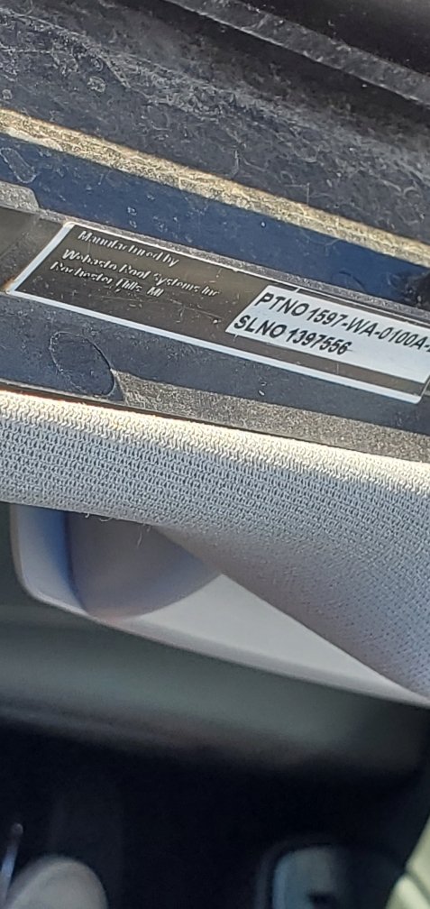

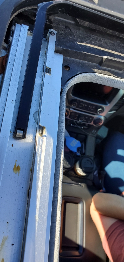

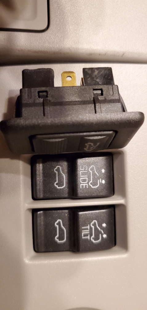

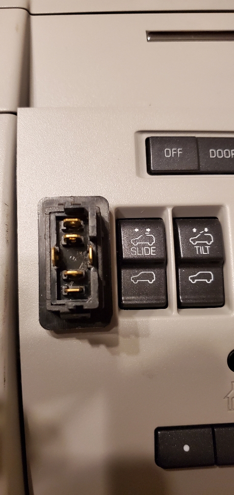

Just realized my sunroof is NOT an OEM one. I guess it's a Webasto 1597-wa-0100a. I figured that out after the touchless carwash blew some water through the antenna gasket...or possibly sunroof gasket...
That would explain why I couldn't find a single overhead console with a switch like mine above!

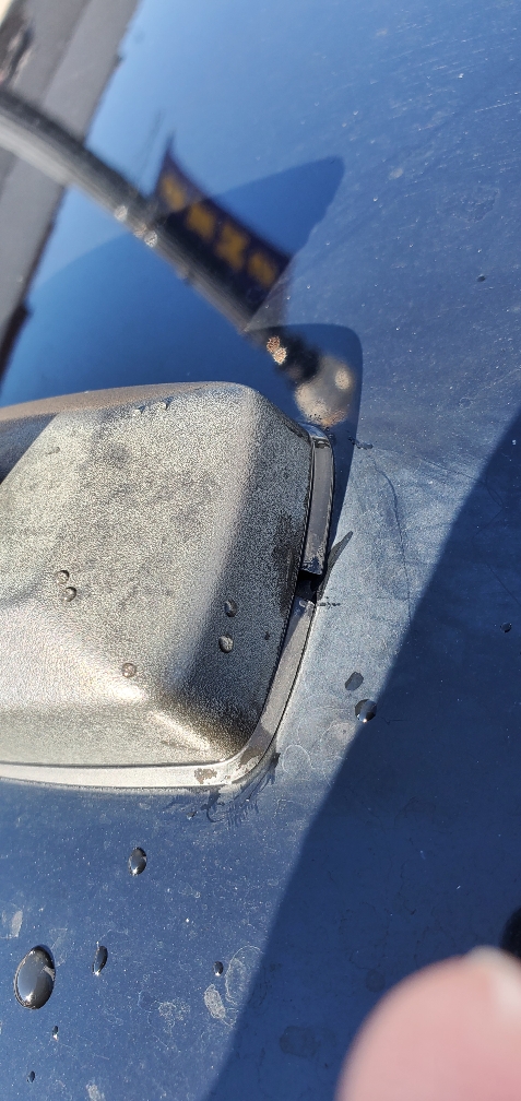

Nick
Sent from my SM-N975U using Tapatalk

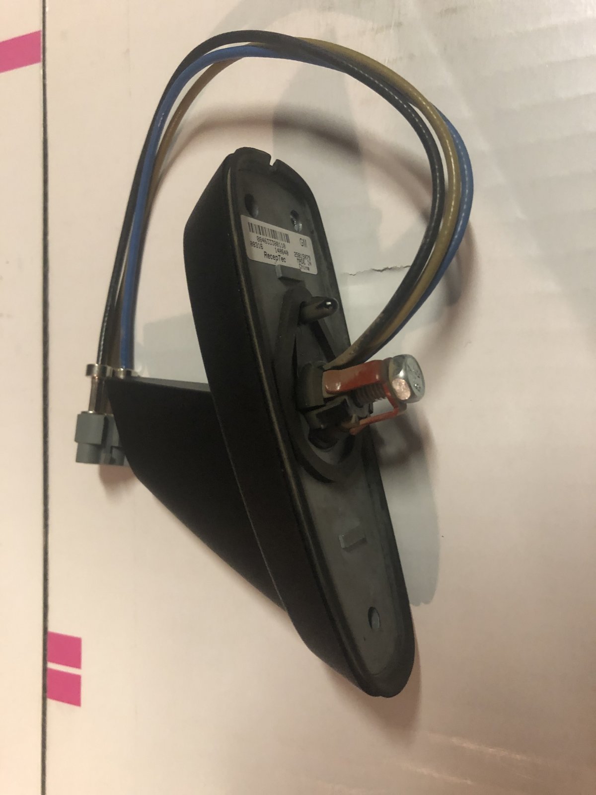

BTW-That gap on the back of your shark fin antenna is factory. The actual seal is made under the antenna where the clamp bolt is at.

BTW-That gap on the back of your shark fin antenna is factory. The actual seal is made under the antenna where the clamp bolt is at.View attachment 261415
Never had a leak before. Wondering if the automatic carwash just hit it at the right angle to cause it. I'm assuming whoever installed the sunroof also did the drop down dvd. It is aftermarket as well.

The lights in my wife’s ‘17 were only working intermittently (1/100 maybe) so I have new modules a shot. No luck, they only flash three times when I start the truck. Any ideas?
nglauer
Jun 30, 2020
235
200
Did you buy brand new modules? Or pick a pair up off of eBay? It's possible the new ones are bad. What color wires do they have?
