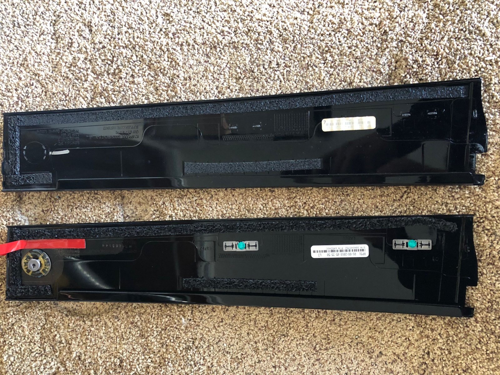

I replaced my drivers side pillar "applique" this morning. Took about 7 minutes.
I ordered a replacement from https://www.gmpartsoutlet.net/
Part Number: 84263144 - Applique - $41.85
You need a #2 Philips and a T15 Torx bit. Photos attached.
See photo - the bottom piece is obviously the replacement. Notice it is secured by a machine screw at the top (round fastener) and two blue-ish green plastic pins in the middle and bottom.

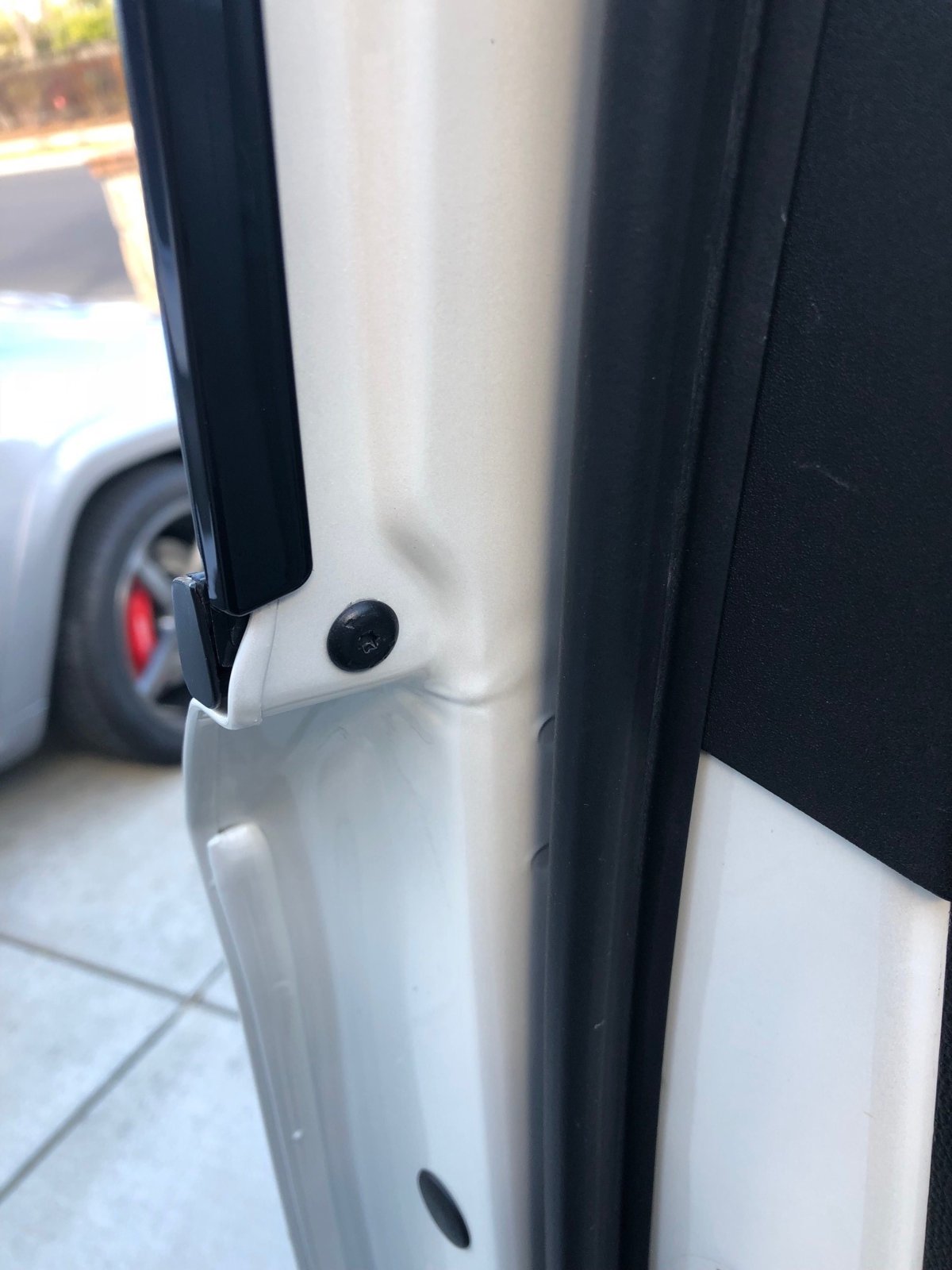

The top screw can be accessed (removed/replaced) by pulling the rubber interior window molding back.
Then remove the T15 torx bit inside the door that secures the chrome exterior trim piece (Photo attached)
The old trim should pop out and slide out (towards back) pretty easily. Just put the new one back and refasten.
Interesting the replacement piece also included a small strip of double-sided automotive tape. Maybe GM thinks this'll fix the issue.
