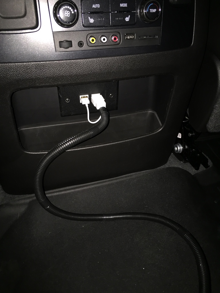

The method "hosseface" used will work absolutely. But you are left with cables exposed, the A/C plug in use and such. This method is all internal and very clean. You can also plug any HDMI device into the port and it works as well. Apple TV, XBOX, Play Station and such. If you use the other method there is no plug for those external devices because it's in use by the cable.

Here are the instructions and I did a little extra by wrapping the cable with a plastic tube and will probably dip the connectors and get rid of all the white totally.

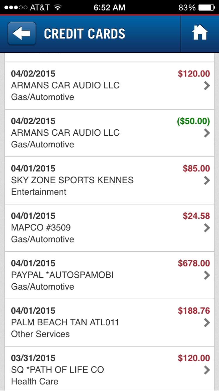

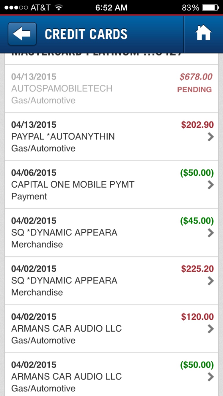

Woke up to another charge on my credit card from MVI. They claim its only an authorization to ensure my card is valid. What a crock of BS. I already paid them and shipped their module back same day. Beware of this fact before doing business with
them.

how did you gain access to the wire harness to solder the output of the video/audio? and where did you mount the HDMI to AV convertor box?

Pop the back console off and it's right there. The converter box is so small I stuck it in there with double sided 3M tape. You could just leave it hanging anywhere
