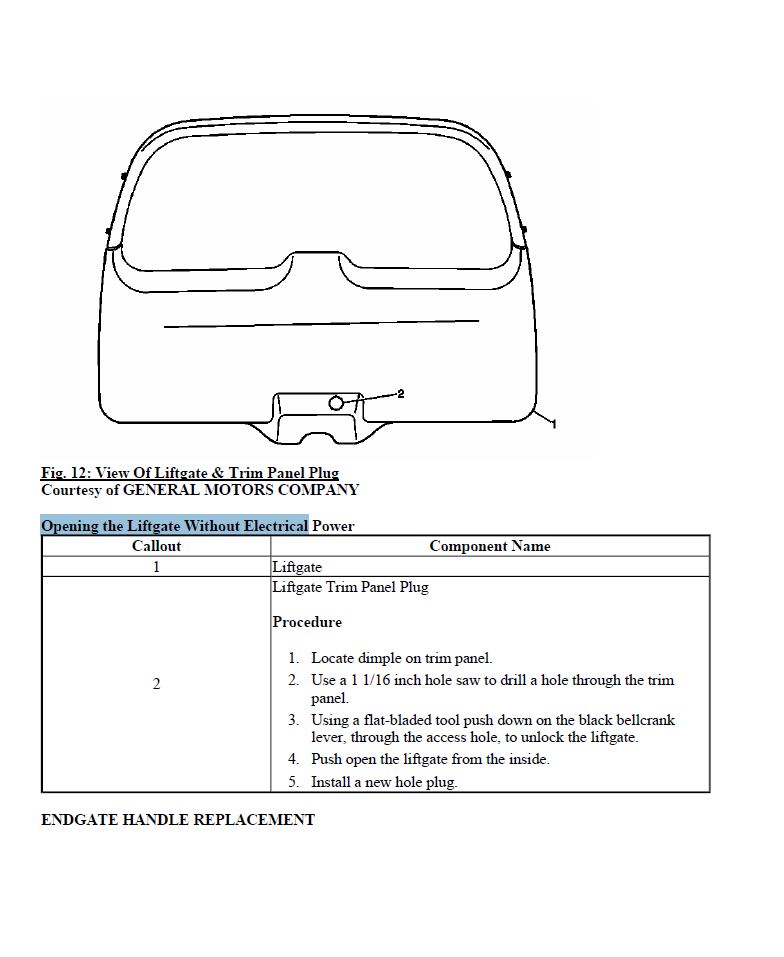

You might have to drill a hole through your rear interior panel to release the latch if it's staying locked...

If you don't have a power tailgate and the electric latch won't open, your only other choice is to drill the access hole in the interior of the cargo area.
Here's a good video showing it:
Thanks. Probably gonna have to do this. I think it’s a power tailgate? Maybe not. Maybe it’s just hydraulic assisted.

If you have a power liftgate, you would have heard the electric motor as the liftgate opens. (And you would only press on the liftgate button and not try to pull it open)
Either way, if it doesn't unlock, that has to happen first..
21,274
30,204
