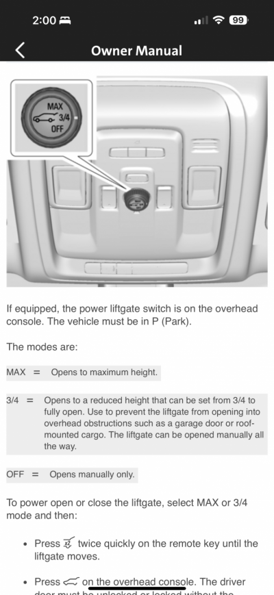

Double check the roof console switch to make sure the lift gate is not off. It’s the circular switch on the roof console with the button in the middle..also used to set the opening height.
The hands free takes a “slow kick” to open. Make sure to kick your foot straight in then straight out, right where the logo is; make it very deliberate, and make it take about 0.5-1s. I had trouble with mine when I first got it, was being too fast and not making a big enough kick
Now, for the wiper not working…that seems like a trip to the dealer.
