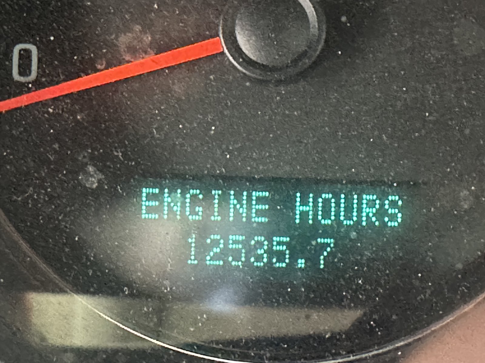

I just read how to see the Hours on my PPV and WOW was I surprised. I thought with 122K miles it would be lower. For being 10 years old that seems like a lot. 12K hours. Has anybody seen higher?

122,000 miles, divided by 12535 hours, 9.733MpH
12535 hours, divided by 10 years, 1253 hours a year, 104 hours a month, 24 hours a week, or 3.433 hours a day.
About 3.5 hours a day @ an average of 9.733MpH.
Sounds like this PPV chased - and arrested - mostly donuts (not the smoked rubber kind).
When you bought it, did you make not of the average MpG?

Im was getting 14-15 mpg. I am at 13 yesterday. Now my fuel return or charcoal filter is clogged. So just to fill it my mechanic removed some hose until he can drop the empty tank and figure out which part needs to be replcaed.

Typical is 30 mph, so with 122k miles 4000ish hours would be average.
12,535 hours would work out to ~375,000 miles for a vehicle that had a "normal" duty cycle.
Take away is your engine is much more worn that you'd expect at 122k. I'd be looking to do frequent oil changes, keeping an eye on engine compression and running some fuel injector cleaner.
Did you change all the fluids when you got it?
