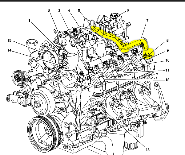

Is this the right routing for the PCV hose on a 14?

I didn't look too close but typically PCV's feed in before the throttle body. Is that how it is on these? Not a GM guy so the 5.3 is all new to me. If it feeds in before the throttle body I'm good. The throttle is very very clean.
No actually the PCV breather line goes to the top of the intake manifold. The TB is ahead of it, so the only oil you will get in the TB is if you are pulling it (pumping it) up through the clean air supply which is ahead of the TB. That would be suboptimal.
