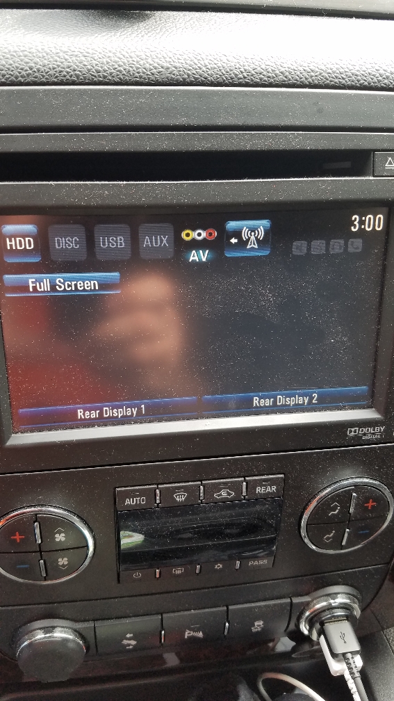

There should be a setting on the head unit screen to select which rear screen has a picture. You can choose one or the other or both

If there isn't, the dealer needs to reprogram the head unit for the XL with 2 rear screens using a Tech2

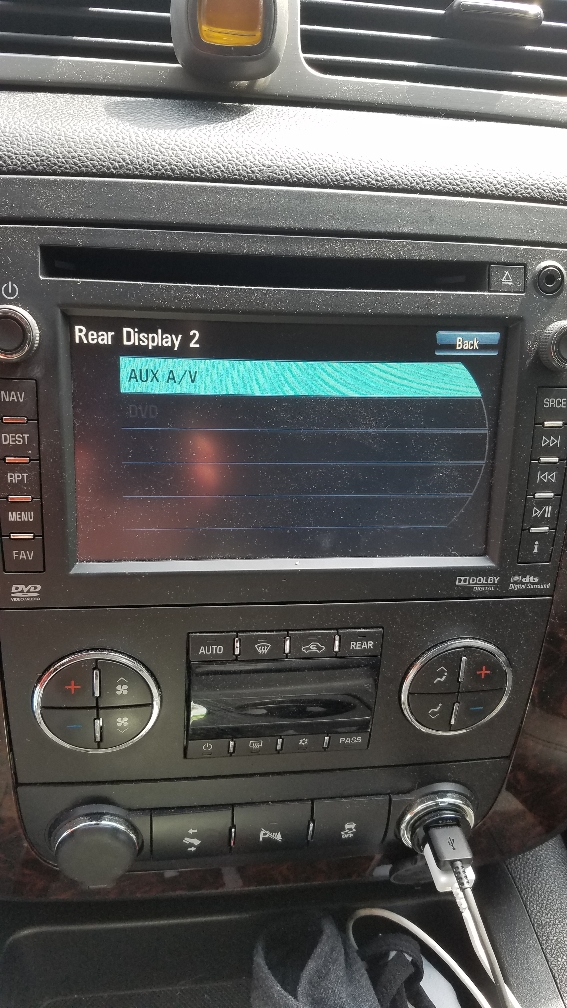

After pressing the SRCE button, this screen gives the options of what gets put on each screen, such as Aux A/V or DVD
I don't have a DVD inserted, so it just shows the AUX A/V option.
