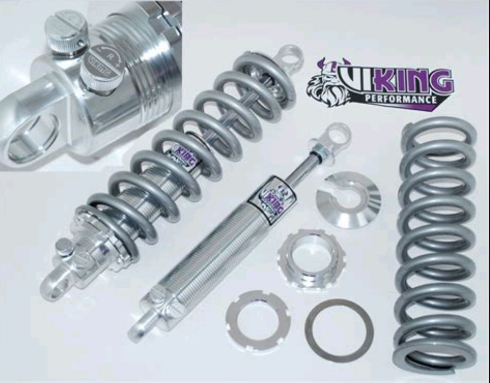

Your post is kind of confusing.
You mentioned changing over to "coil overs" but later mention Bilstein 5100/4600s.
Are you talking about changing over to actual, aftermarket, coil overs like this...
Or are you just talking about installing factory style struts without the Autoride technology?
If going to aftermarket coil overs, like pictured above, then yes aftermarket mounting brackets are required, Atomic makes some.
If going back with a factory style strut assembly then no, they will just bolt right in. The only thing you would need is resistors to keep the service suspension system message from coming on in your DIC.
I assume it is the latter but wanted some clarification.

Yes, switching to aftermarket coilovers, as Ken showed, will require special adapters on top and bottom to mount them. The strut towers that are part of the frame remain as-is. It's a bolt-in conversion.
You can use regular replacement struts that retain your stock coils and they'll bolt in just like stock. You can use the adjustable 5100 or the 4600 coupled with a spacer and get lift either way. Call Bilstein and see if you can find the difference in the 5100 versus the 4600 valving to determine what'd suit you best. If you go this route, as others have said, it's the perfect time to replace anything that may be worn, rusted, etc. - the top "hat", rubber isolator, etc.
IMO, if you're not sure how much lift you want or if you think you might be changing it later, the spacer method is more ideal. It's cheaper and much easier and faster to install so it can be altered as desired. I wouldn't use them for more than about 2" of lift, though. I ran a 2" front spacer lift for about a year with no problems. It was a ~$25-$30 kit from Amazon, made of billet aluminum. The included bolts were Grade 5 and I meant to replace them with Grade 8 just for peace of mind. I never did but never had any problems and I don't tiptoe around when I drive.
As for the AutoRide, simply soldering in some resistors will disable the system and keep the computer happy. I got a pack of 4 or 5 of the resistors off Amazon for something like $12-$20. I installed mine almost two years ago when I lowered it. No problems, ever. To disable the Auto-Leveling, it's as easy as disconnecting the battery and removing a couple of fuses then reconnecting the battery.

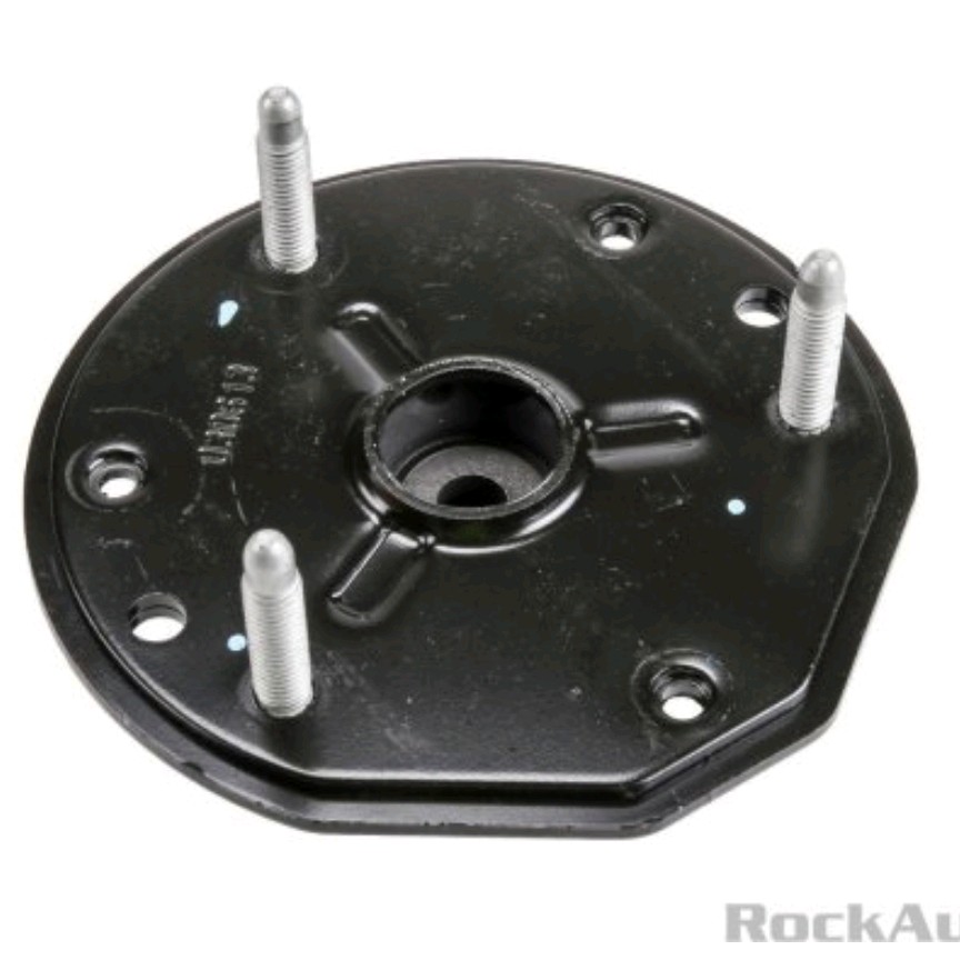

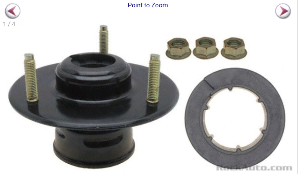

If you want to delete the Magride you need to change the front upper strut mounts and springs to the non-Magride version. You will also need to change the rear springs to non-Magride springs.

I don’t reckon you have to but you should for best operation. The springs and upper mounts are different.

Got a pic?
I am curious what the difference is... my truck didn't have the Magnaride.

You can look at pictures of the upper strut mount on Rock Auto and they look totally different.
That's weird, I never realized that before.
The bottom side, towards the spring, looks like it would still work the same once the spring seat was installed.
The top side just has that raised portion in the center for the non-Autoride struts...
whereas the AutoRide strut mount is flat on top...
