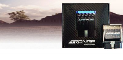

IMG_9483.JPG i came across these long tube SS headers, from kooks 1 3/4" x 3" any feedback on gain, installation...etc. and will it fit my Tahoe directly or requires any modifications? (A bit expensive though!!)
and also what's your thoughts on the Range AFM disabler?
Hope the picture are clear! :)
