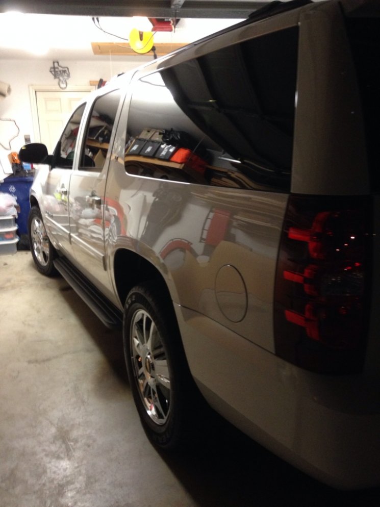

Washed and waxed the burb this afternoon...what a process, but it sure does look good!! It was too late to get good pictures so these will have to do.

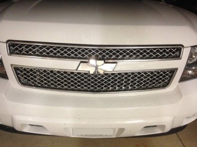

Got the LTZ grille in tonight!! I love the look! Thanks Burbin!

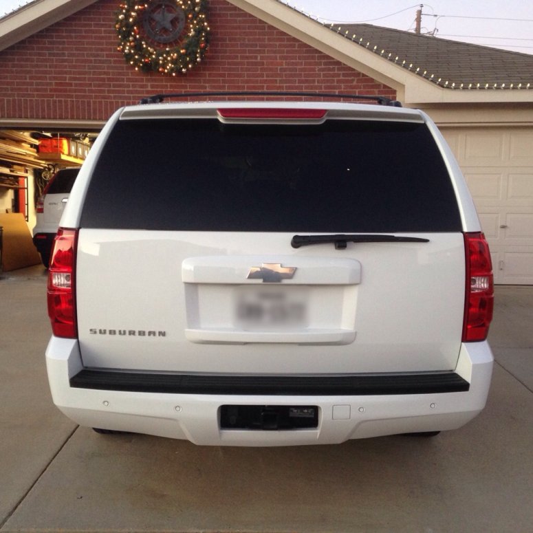

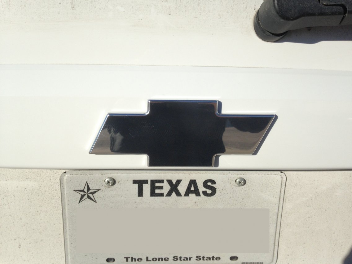

Got the billet bowties for Christmas and had a chance to get them installed during my time off. I think it turned out pretty good. I'm really not a fan of the white color-matched bowties, so I went with the polished billet.
They are All Sales 96108P Here is the link to the part on Amazon:
http://www.amazon.com/All-Sales-961...d=1419737106&sr=8-1&keywords=all+sales+96108p
The picture show a bowtie with a border but this part number does not have a border. they have another number with a border if that's what you are looking for.
I'm sure there is better quality out there but these are the same price for the set that most others are for just one. I had to modify the top of the front one with a file to get a better match than how it came, it was almost flat. I also removed the small foam square under that fits under the factory bowtie to get it set down properly.
You'll have to excuse the filthy truck...It's been raining once a week for the past month. I'm hoping to get it washed up with some of my other Christmas detailing goodies...

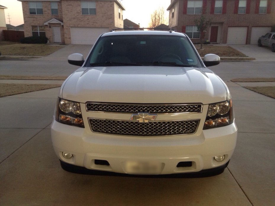

Cleaned up the burb this weekend. Turned out pretty good, I think.

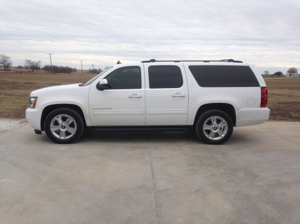

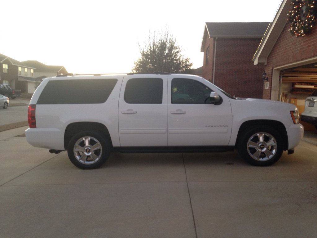

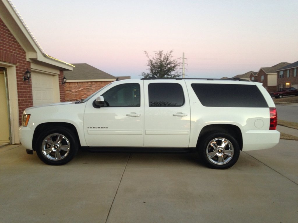

Got everything installed on the rear this past weekend. I'm pretty happy with the results. I'm still on the fence about whether to lower the front or not (Lee's working on me :))...I probably will but will wait until struts need replacing, I'm at 50K miles right now.
Here it is before:
And here it is after:
Parts installed were:
Belltech 23301 - 2" Drop Spring Kit
Belltech 6651 - Shock Extenders
Air Lift 60742 - Helper Bags
All of these products were awesome and truly are bolt-ons (no modification required).
Here are the measurements:
FL: 34-5/8"
RL: 36-7/8"
Initial: 34-3/4"
24 Hours later: 34-1/2"
FR: 35"
RR: 37-3/8" (Stock)
Initial: 35-1/4"
24-Hours later: 35"
The stance is currently similar to a PPV.
I also want to give a huge thanks to Lee (goodinblack) for all his support and assistance through this mod. This guy is a stand-up guy!

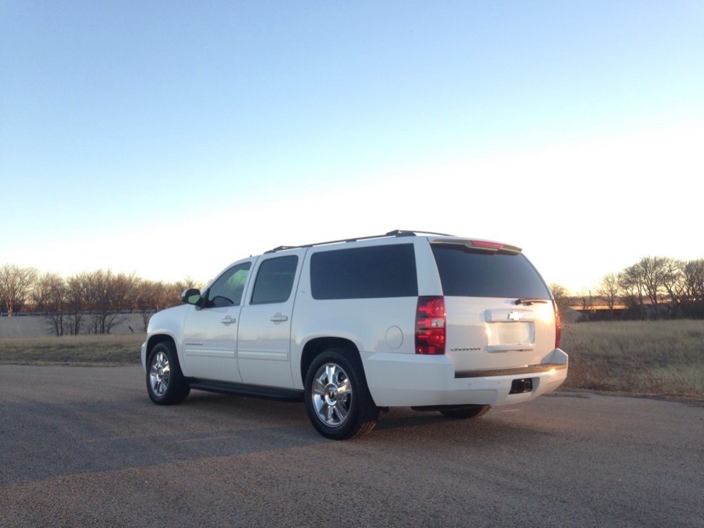

Finally got out to my land to snap some pictures...the sun was really a little too low, I may try some more in the morning.
Here's what I got for now.
