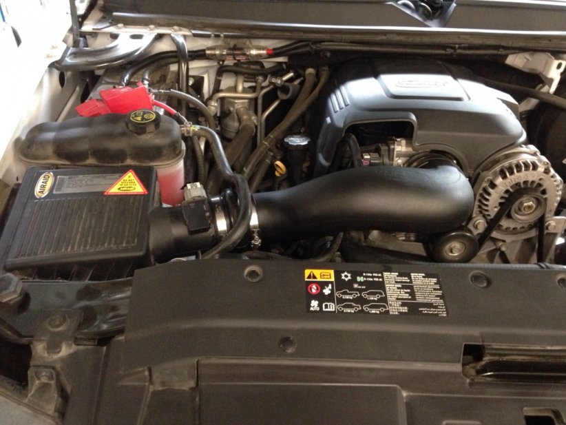

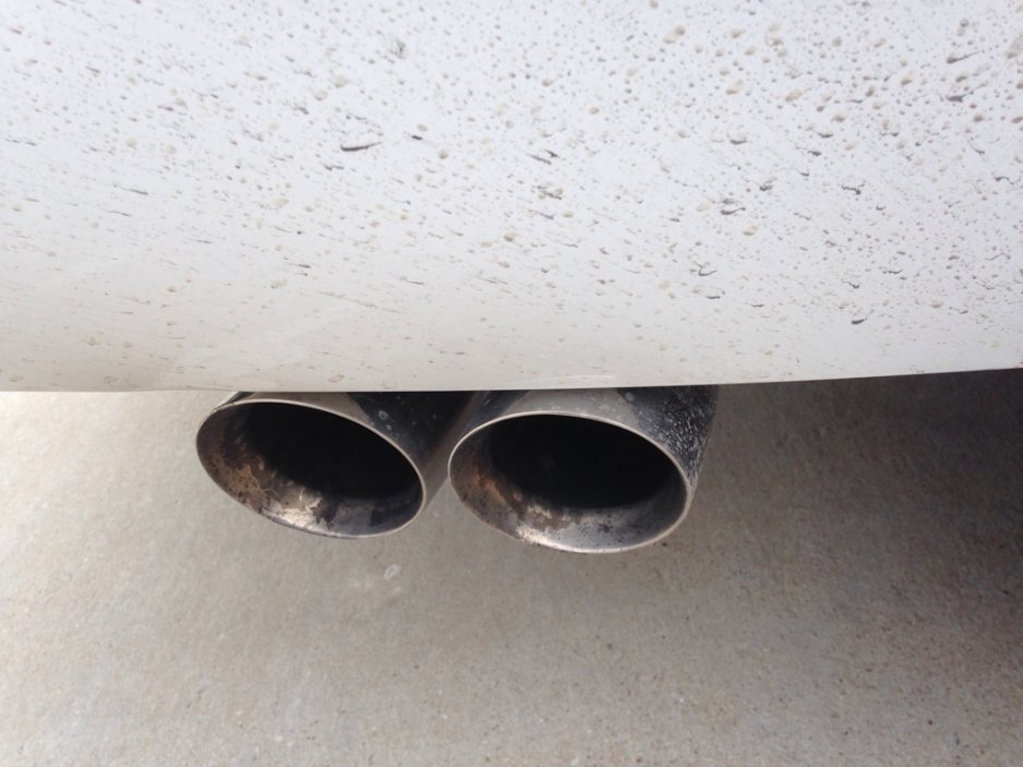

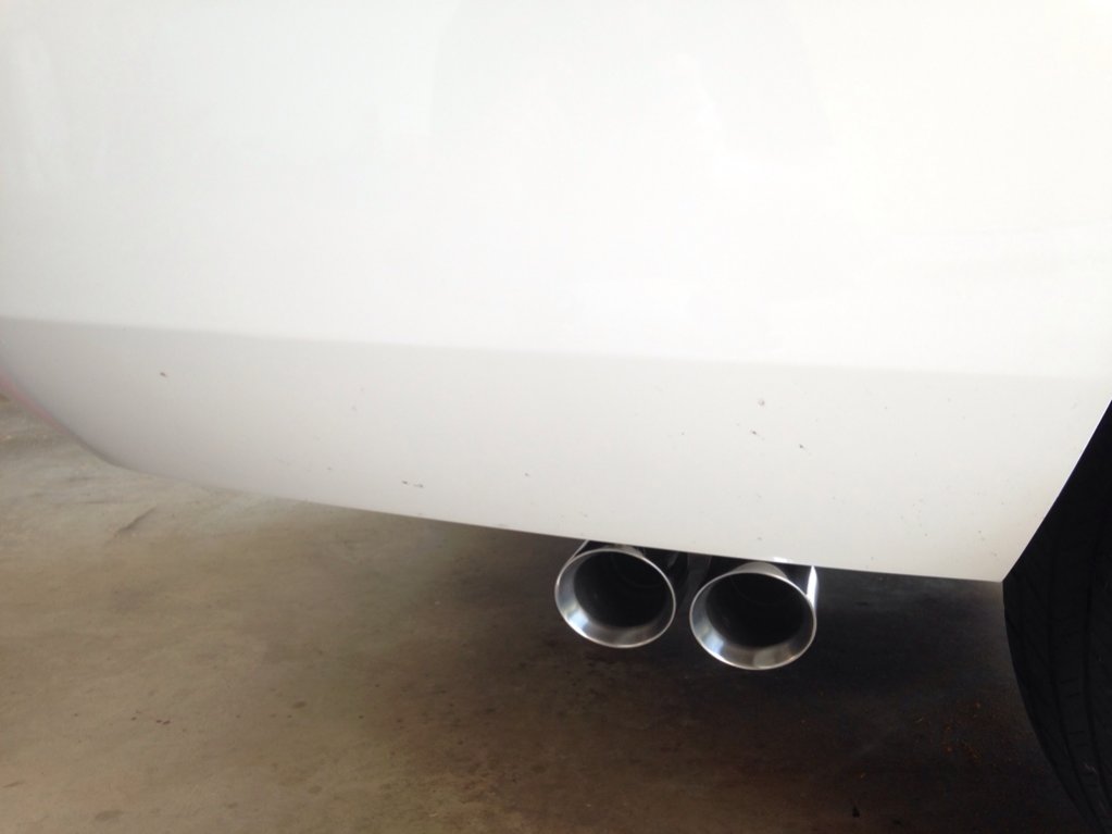

I got the SLP resonator delete kit for my bday from the family for my birthday so today I got to put it on!! I'm pretty happy with the results. I was surprised at how easy it was to install!

Thanks, the fit and finish of this tip is pretty awesome for a $100 add-on.
---------- Post added at 11:50 AM ---------- Previous post was at 11:48 AM ----------
I added the Airaid Jr kit a few months back and the combination of the two really works nicely. I think next on the exhaust side will be the Magnaflow 12589 muffler after I do the drop.

Good luck keeping that tip clean lol
I bet it's a job. Seems the only way to get to all of it is to take it off and clean it!
When the fam asked "Cool, but what is it?" I used the picture you posted of yours!
It does seem awfully close to the body, but I guess that the double-walled construction will help with the heat. How much space do you have between yours and the body panel?
Awww... I am so honored :)
lol
Like a .25 inch

Looks good. I've had a similar setup on my 08 tahoe and 07 avy and yea it's VERY hard to keep clean lol.

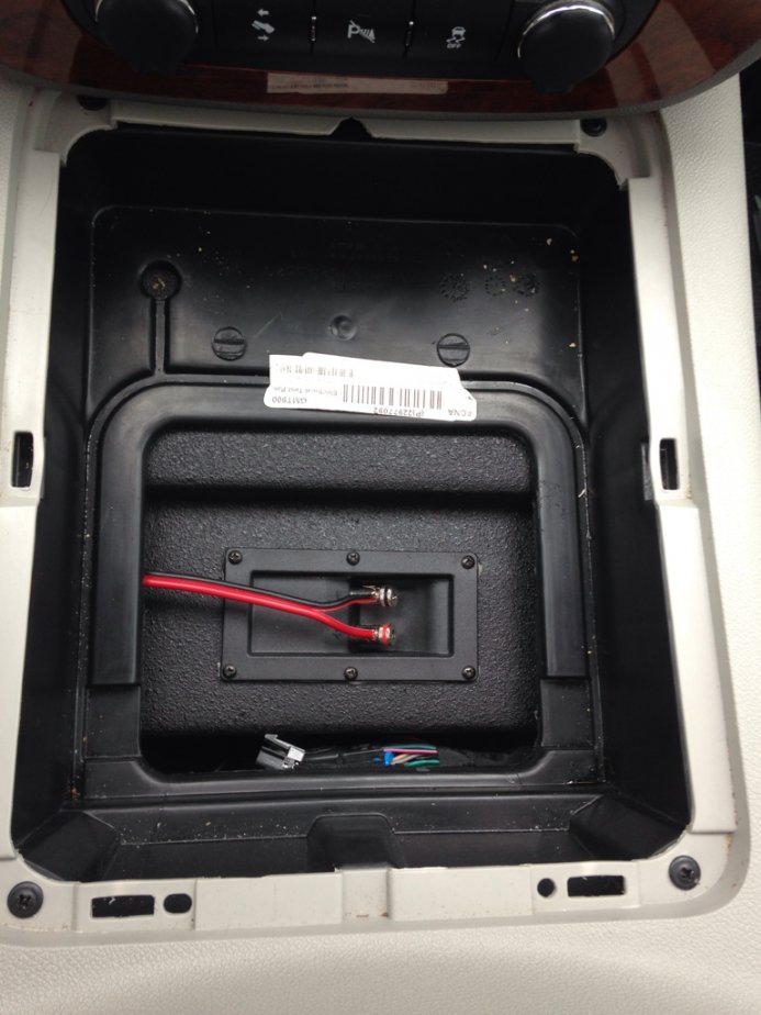

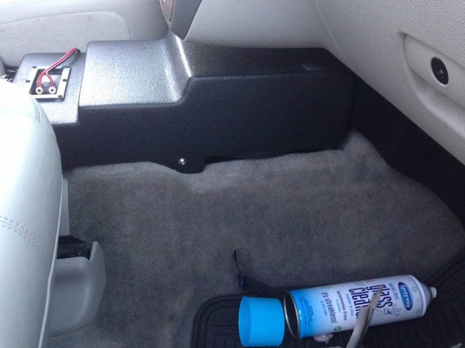

Where is the stealthbox?
Under the console?

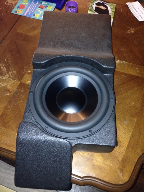

Yes, it is under the console. I found a complete MTX Thunderform on ebay and sold the sub out of it. The Dayton sub is good for higher power (I'm pushing 500 watts to it). The stealthbox is pretty small and I was doubtful of how well the sub would perform, but it's exactly what I wanted. It's not going to win any competitions but added just enough bump, and the soundstage is awesome with it up front and combined with the Hybrid Audio components.
I will try to get some better pictures when I deaden the console.

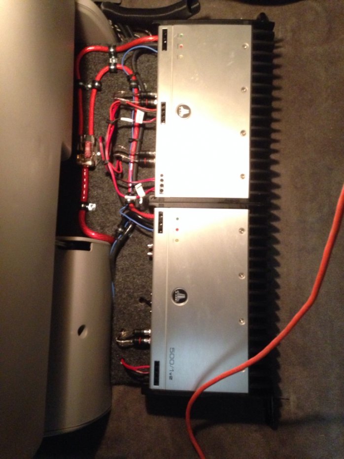

And the amp rack is under the middle seat. I just cut a piece of plywood to fit the space and ran all of the wires to it. With the seat folded down it doesn't move. I wrapped it in carpet and installed threaded inserts.

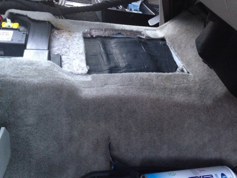

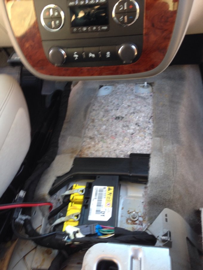

Finally did some work and got those pictures of the sub, as promised...
Sub installed:
Sub installed, 2nd view:
Under the sub, before:
I noticed that the sub's surround was awfully close to the carpet/pad and there was evidence of rubbing on the surround, so I removed the pad and cut back the carpet a little on the driver's side and replaced the pad with two layers of second skin damplifier pro.

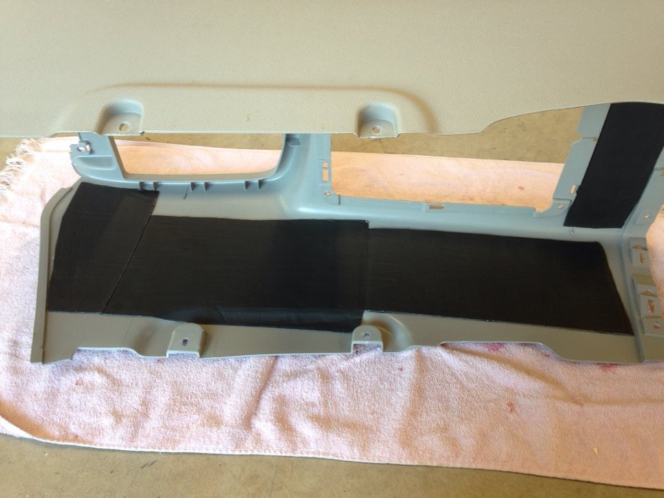

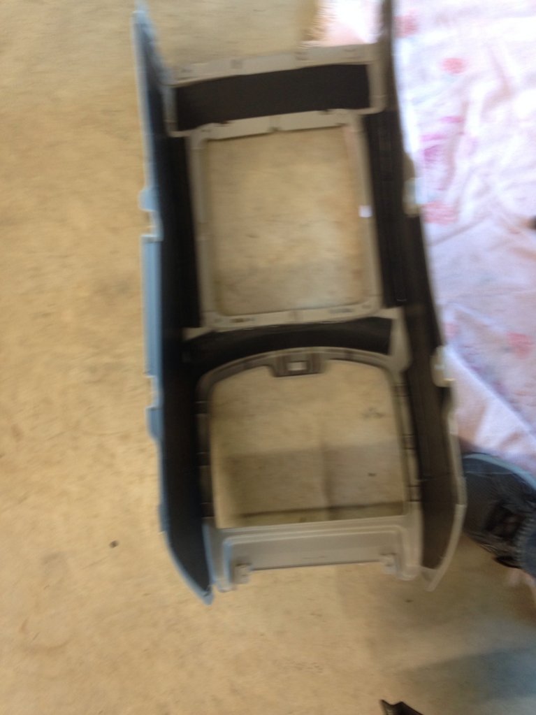

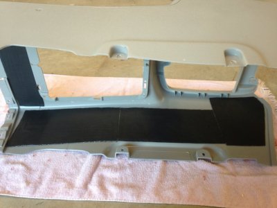

I also finally sound deadened the inside of the console to eliminate the vibrations a little more. I have to say this made a tremendous difference in the clarity of the sub as well as the overall loudness. I had my doubts...
Inside of the console shell, after:
Sound deadener used is Second Skin's Damplifier Pro. I am super impressed with this product and I am a new believer in sound deadening!
The sub is a Dayton Audio Reference ** 10" subwoofer from parts-express in an MTX Thunderform enclosure. I also added some Damplifier Pro to the inside of the box because it seemed a little thin to me (I'm used to huge MDF boxes for subs...
