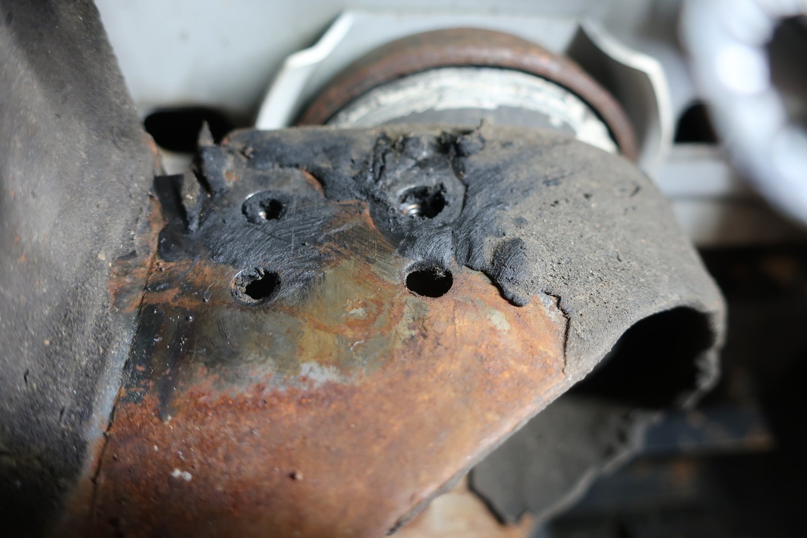

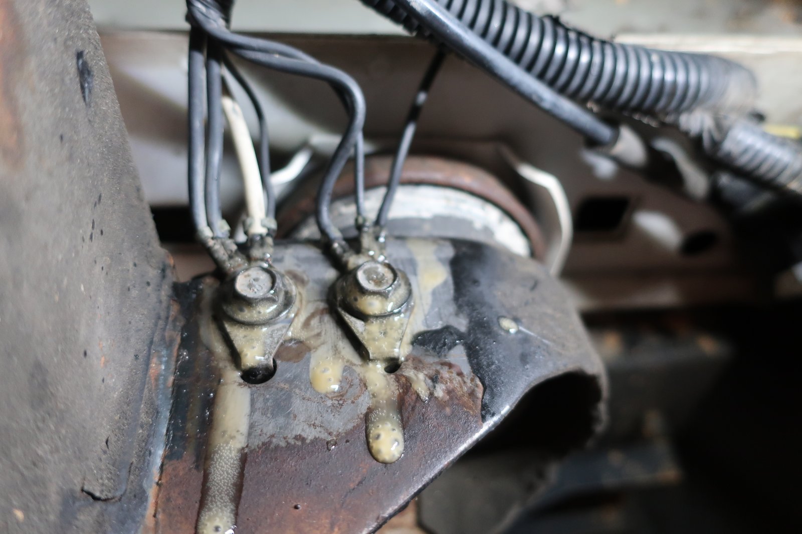

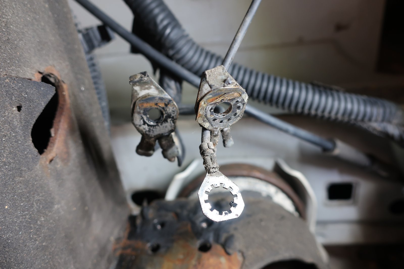

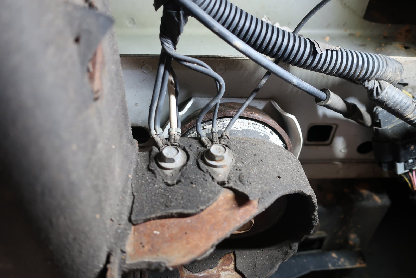

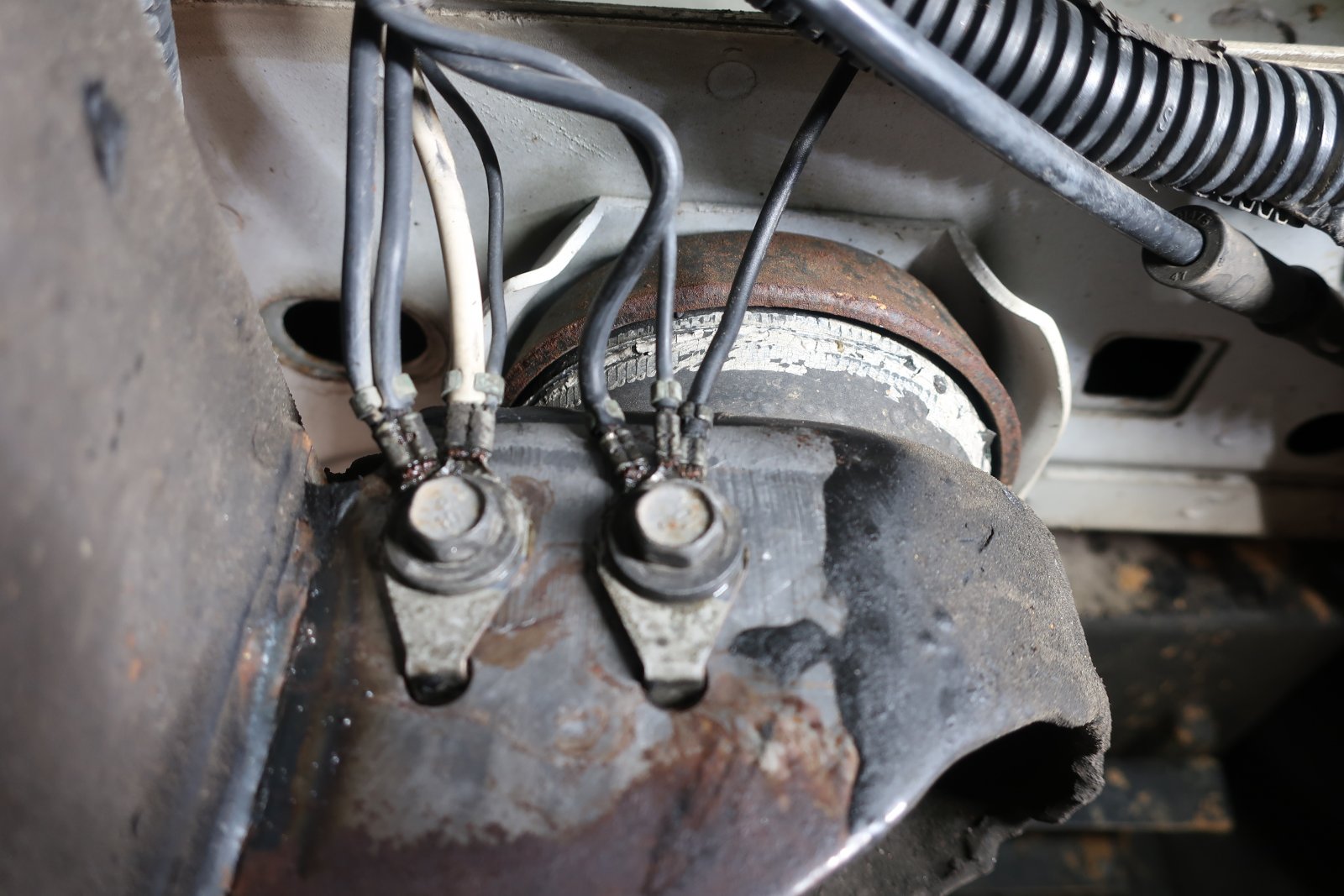

OK, I got some troubleshooting done today before the storms rolled in.
Using the electrical prints from AllDataDIY, I found the tail lights grounded to G400 and G401. Both those points were on the left rear body mount. Both grounds looked OK, but it looked like they had been installed over undercoating.
I removed the screws and ground tabs. I was able to clean up all the undercoating with a scraper, brake cleaner, and rags. Wire brush was onhand, but not needed. There was no corrosion on the body mount, screws, or ground tabs. I reinstalled everything nice and tight.
I disconnected the tail light plug on each side, cleaned both connectors and receptacles with DeOxit D5 spray, and let them dry.
Using a jumper from the battery (-) post, I read 0.4 ohms between the battery (-) and G400, G401. (0.2 ohms of that was my meter leads.) As well, I measured 0.4 ohms from battery (-) to the black ground wire in each body side tail light connector.
So, I believe the tail lights are getting a good, solid ground.
I reconnected the tail light plugs, sprayed G400, G401 with Fluid Film, and went for testing.
FAIL. Right side turn signal flashes fast after 2 blinks. I verified the front turn signal, door mirror repeater, and rear turn signal were all flashing fast.
There is far more to take apart to access the front turn signals, and the sky was looking threatening. I will continue troubleshooting another day.
Ground points G400 and G401 on the left rear body mount bracket. They look OK, but appear to be smooshed in undercoating.
Screws and ground tabs removed.
Ground tabs dirty, but not corroded.
Body mount cleaned, ground tabs and screws cleaned, then all reassembled.

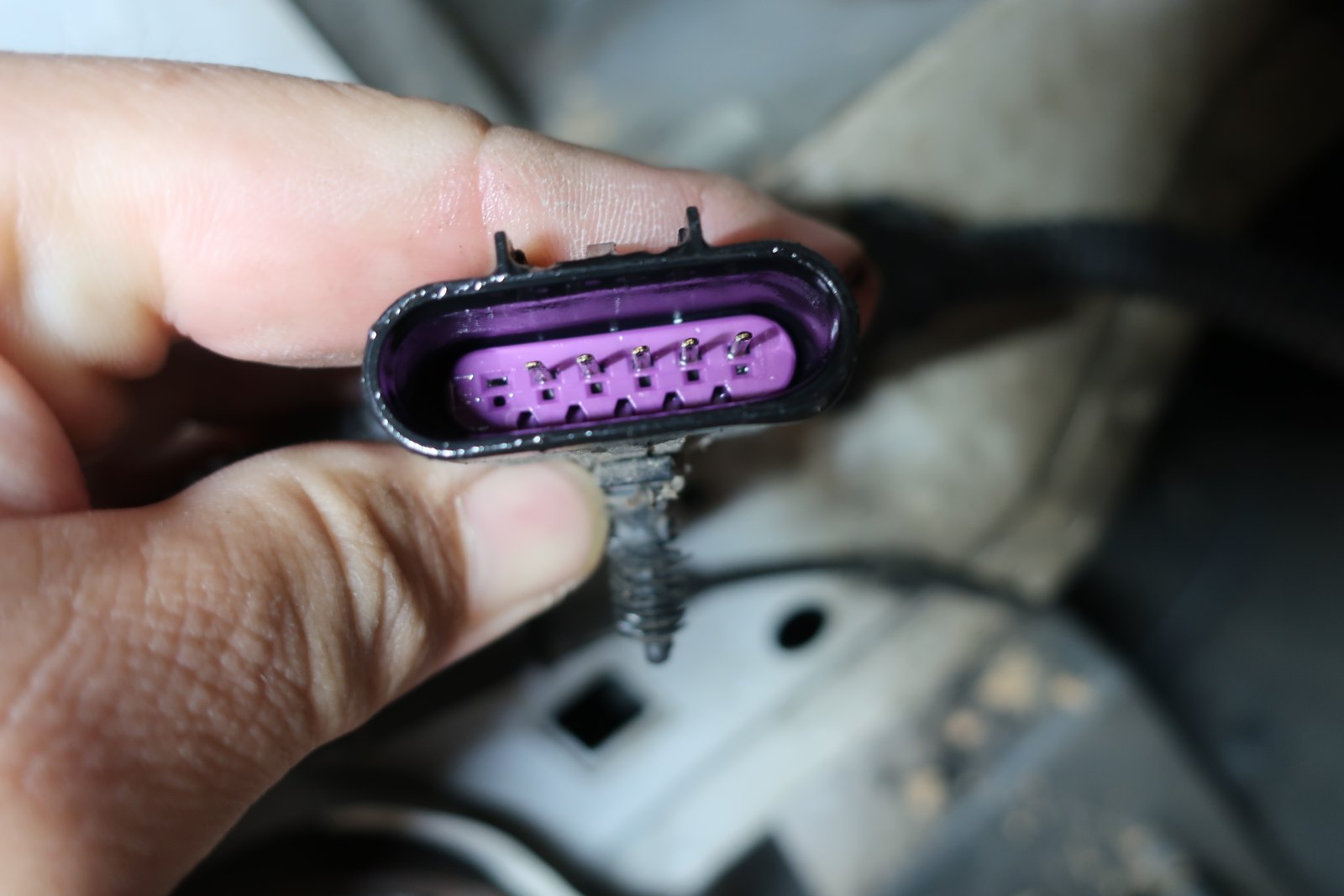

More photos...
G400, G401 sprayed with Fluid Film.

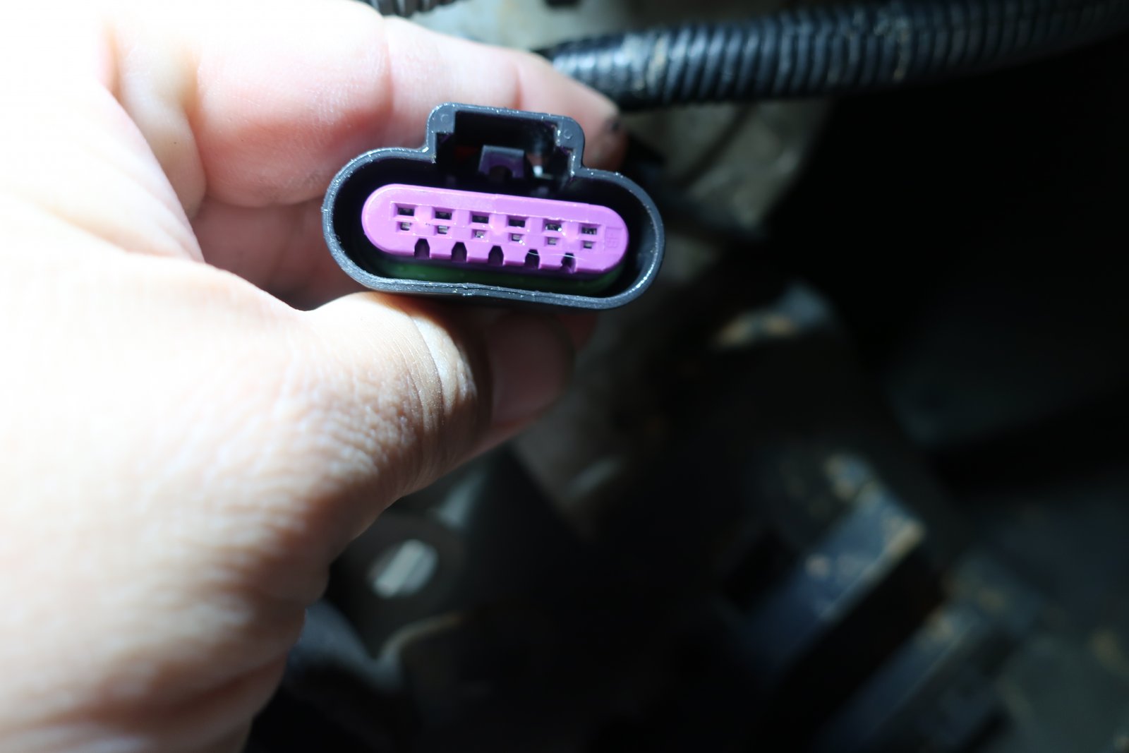

Body side tail light receptacle. All pins were clean and shiny. (This is the left side. Right side looked identical.) Wetness is DeOxit D5.
Housing side tail light plug. All slots were clean and shiny.
