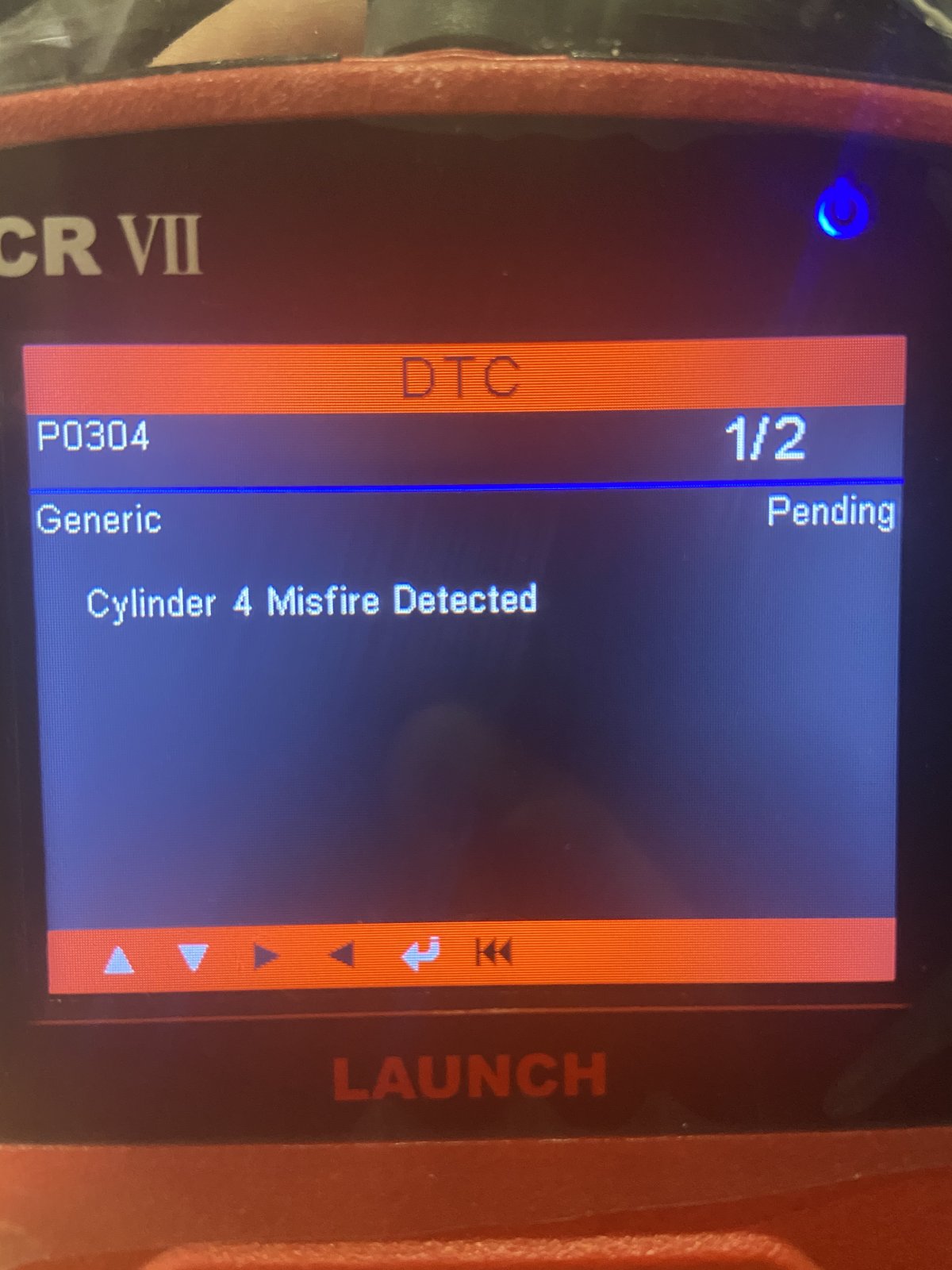

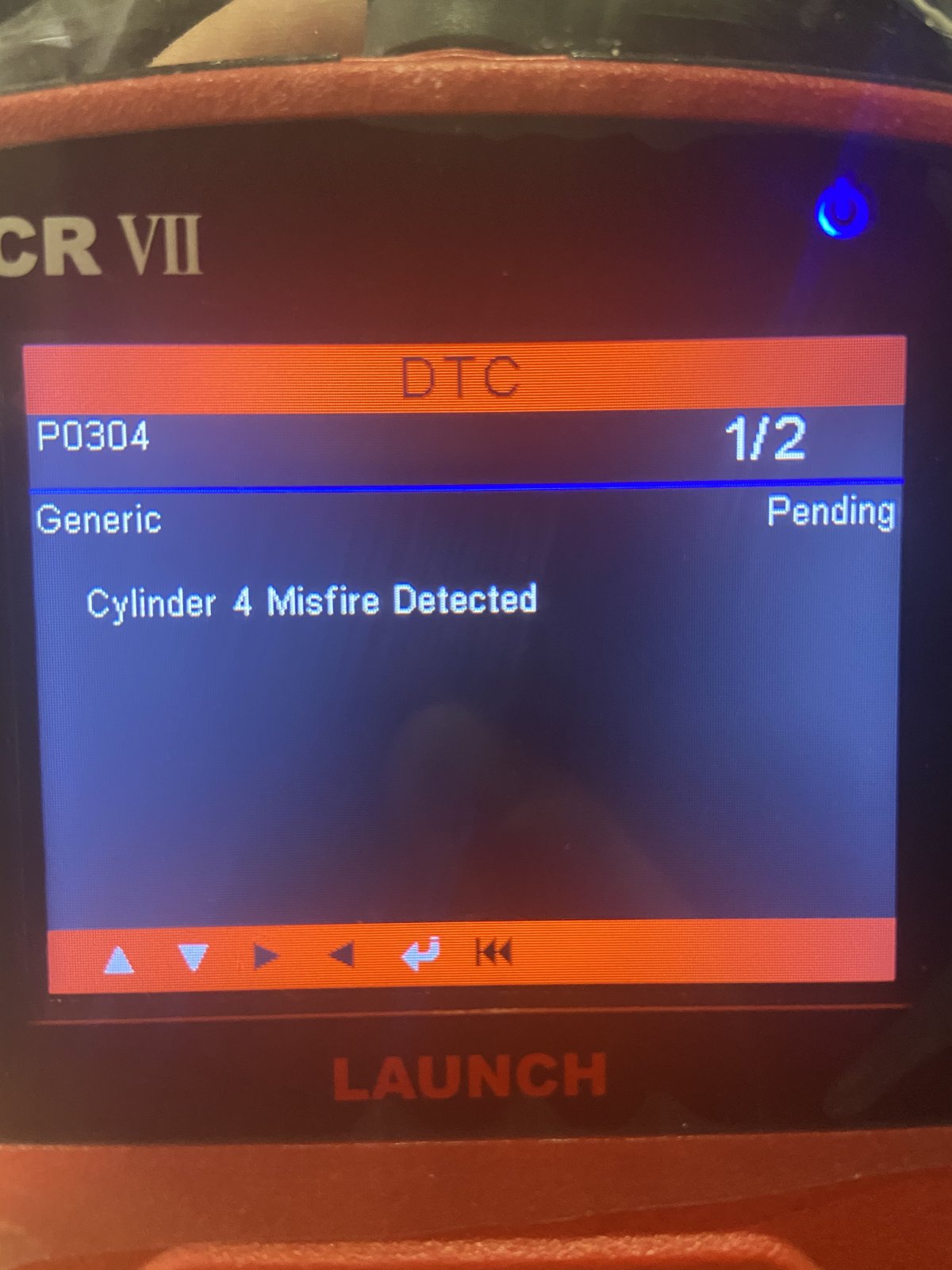

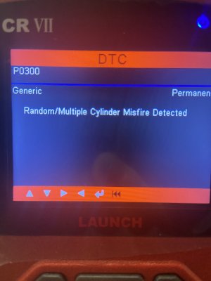

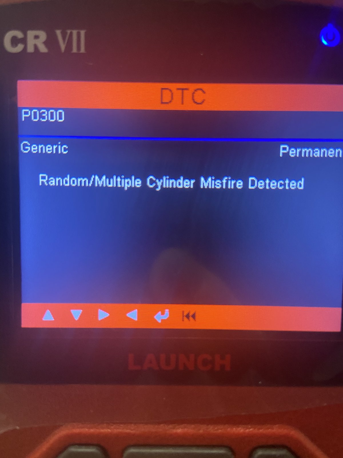

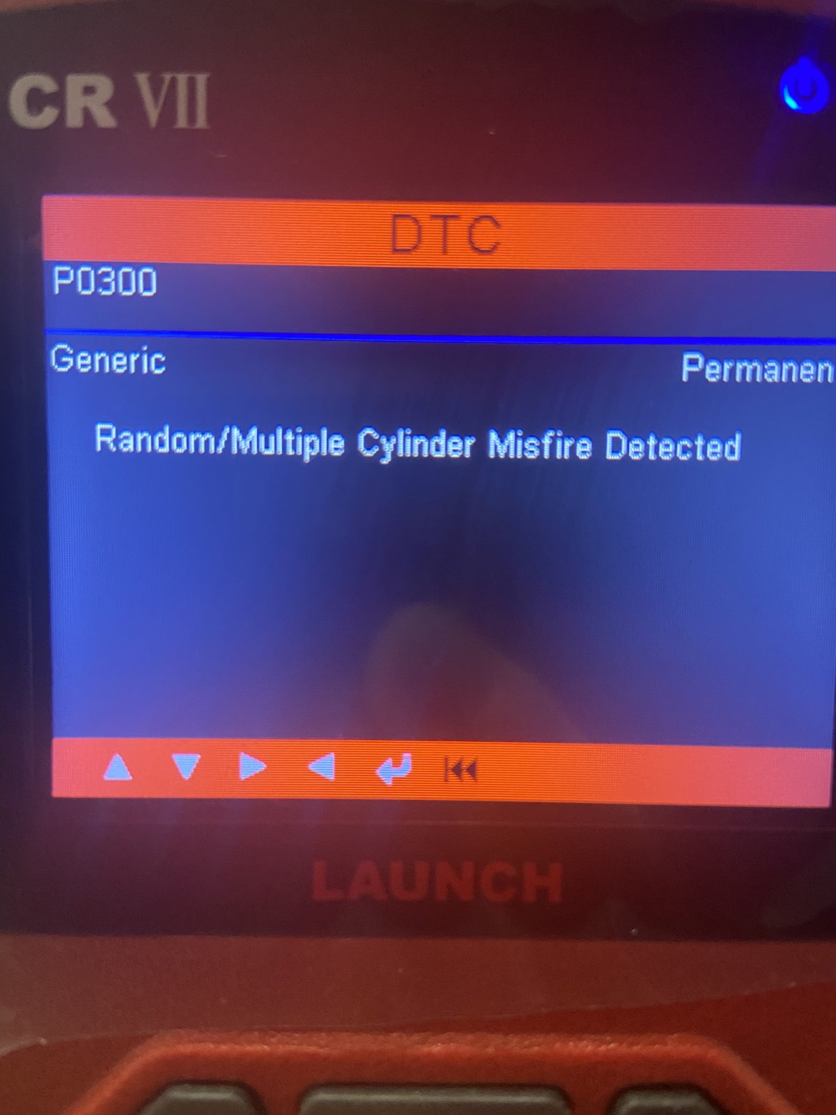

Scanner only shows #4 misfire p0304

Other than the P0304, it doesn't seem to offer any insight into the other misfires (P0300), whether it is bank specific, etc?
Looking at the very brief description on one of the retail sites for that scanner, it says something about reporting O2 sensor status. It would be good to know if the upstream O2 sensor on Bank 2 (the bank you know for sure you have a misfire on) was functioning properly. Maybe correlating what it is saying with any fuel trim reaction, might tell you if you have a bad O2 sensor on that side?
Back on the compression stuff. When your friend pulled the head on bank 2, did he do any kind of seal test on the valves?
