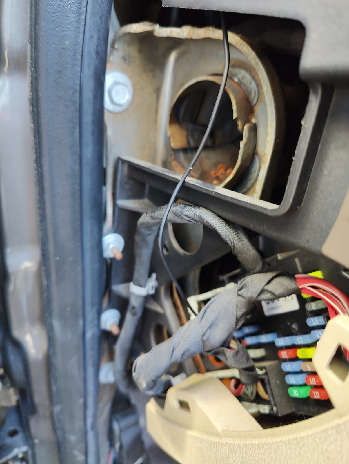

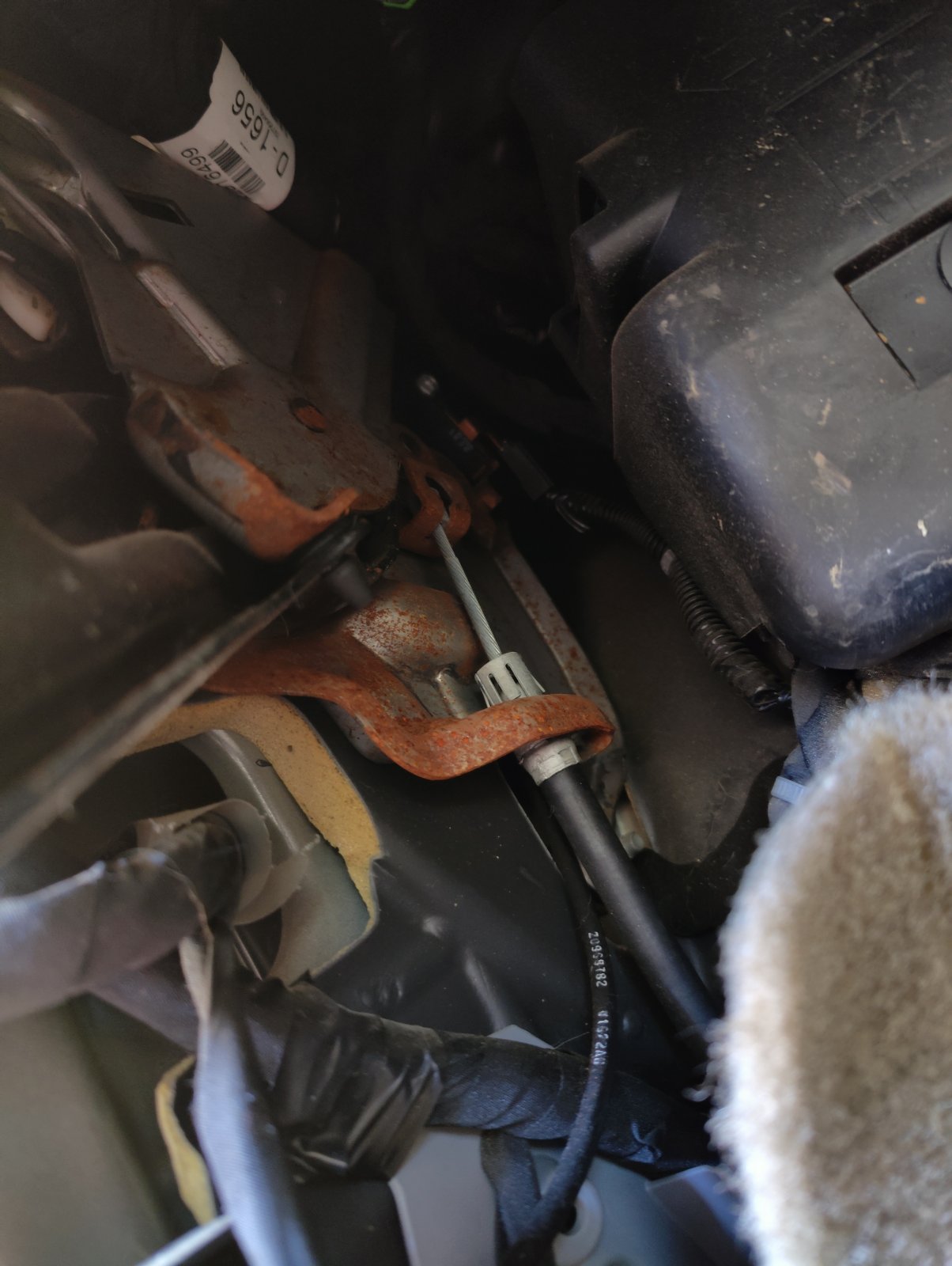

provokaz
Dec 5, 2022
Updated with some pics, looks like the emergency brake bracket is getting rusted. I tried to see lf it it was following wire but wire felt dry got rain in two days gonna see if I can see where it comes from
I'm open for any thoughts
