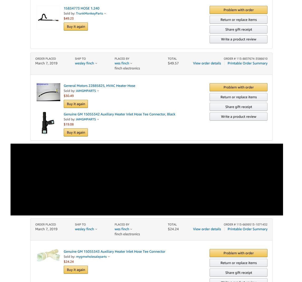

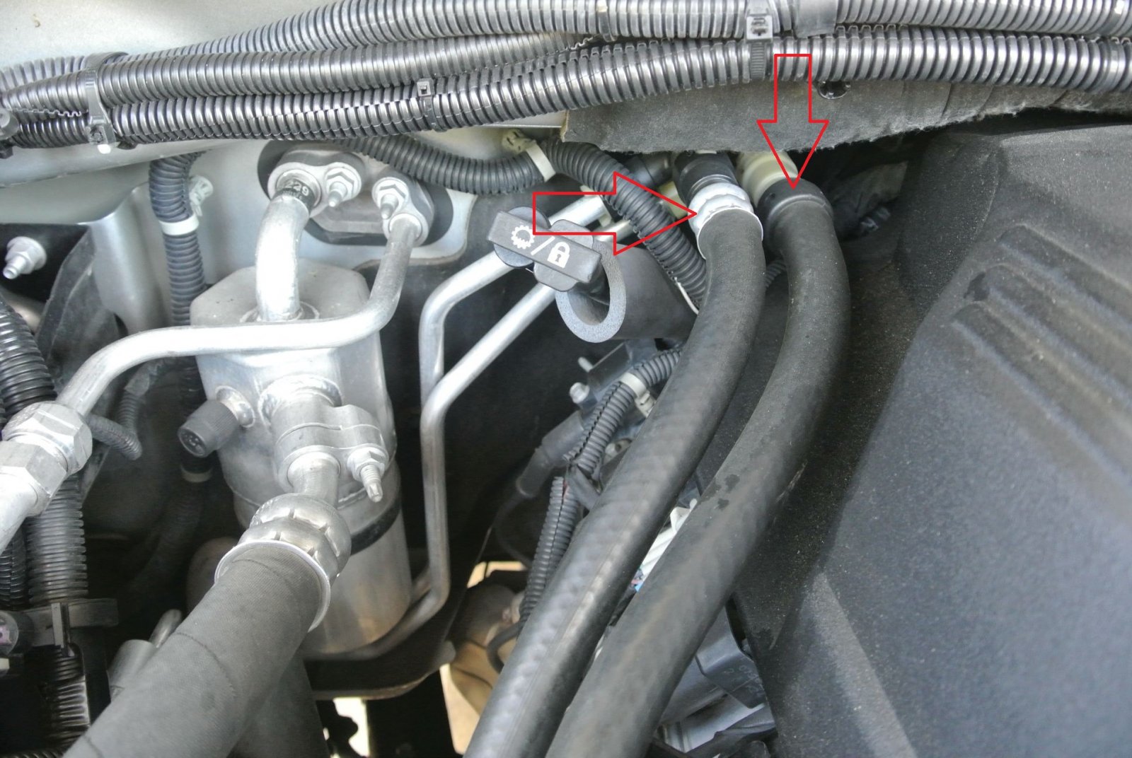

if it is these 2 heater hoses and T's then these are the parts you need

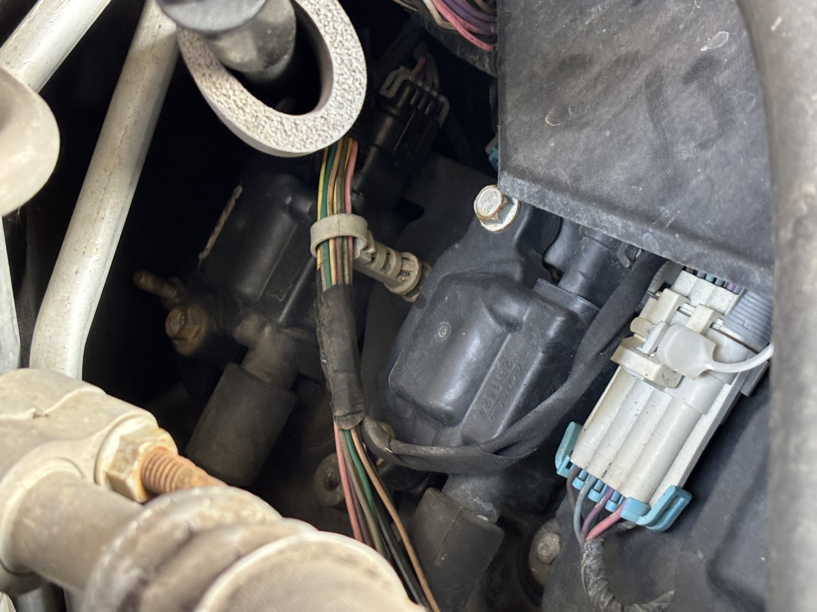

Silly phone didn't attach the pictures. It doesn't appear to be the hoses but this plastic housing.

I see ignition coils and A/C lines so the likely source of your leak would be the plastic tees that @Doubeleive showed you a picture of. They are where your coolant lines go to the front heater core and tee off to go the rear heater core.
If these tees crack and start to leak, coolant will puddle up in the pockets of the intake manifold.
