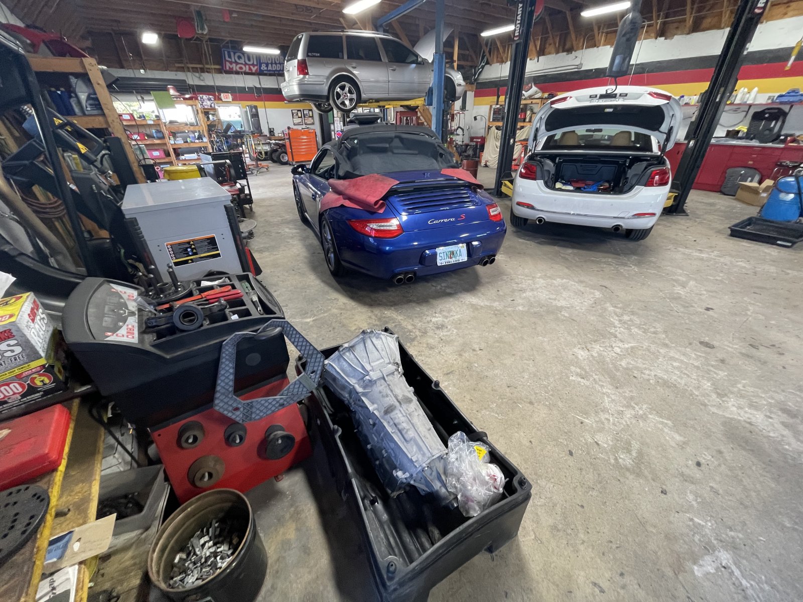

The just got a Jasper installed .. took 3 weeks, they send rebuilt in box - you ship core back for credit. 3 yr 100,000 warranty. The shop mentioned the transmission thermostat cleaning, and new trans cooler is in new radiator for about $500.
I had the V-4..V-8 “DOD system removed last year with Texas Speed parts. Got new front Magnaride Shocks at Chevy.
so My 96,000 mile Tahoe now has 106,000 in my two years of ownership.
Repair costs in 10,000 miles of ownership
total up to ……$10,000 A Dollar A Mile !
It runs and shifts so Smooth . NOW..
Pulled my 18’ fishing skiff like it wasn’t there behind us. Front Hitch means Tahoe is pushing boat back in These days
