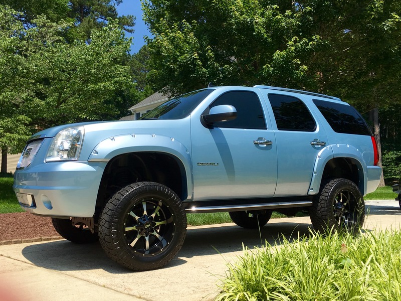

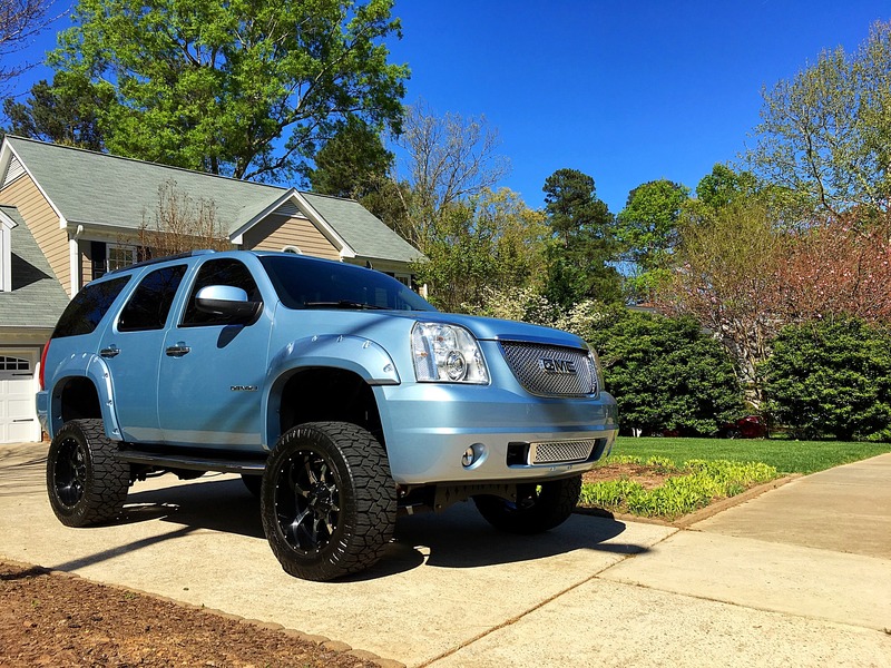

Thanks guys!!! I love the color! Everybody asks is it custom painted but nope pure GM ice blue metallic

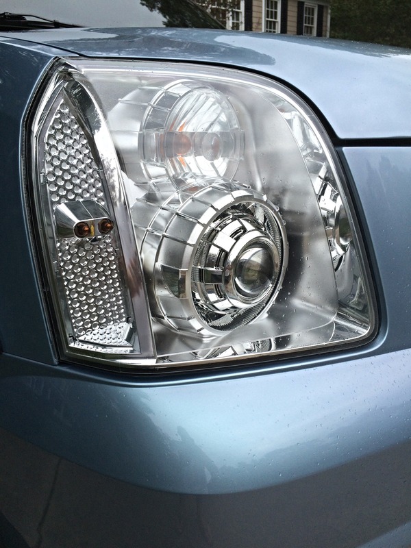

How hard was the FX-R retro? i just finished a D2S retro and i guess thats a walk in the park compared to the bigger FXR

The FX-R retro was a peice of cake! Cut the bowl to fit projector deep enough not to contact the front housing lense. A lot of steel stick to fill any gaps, then sand/clean, a lot of jb kwik, done! I took my time doing it over a couple nights after work but could do it again in 4-6 hours.

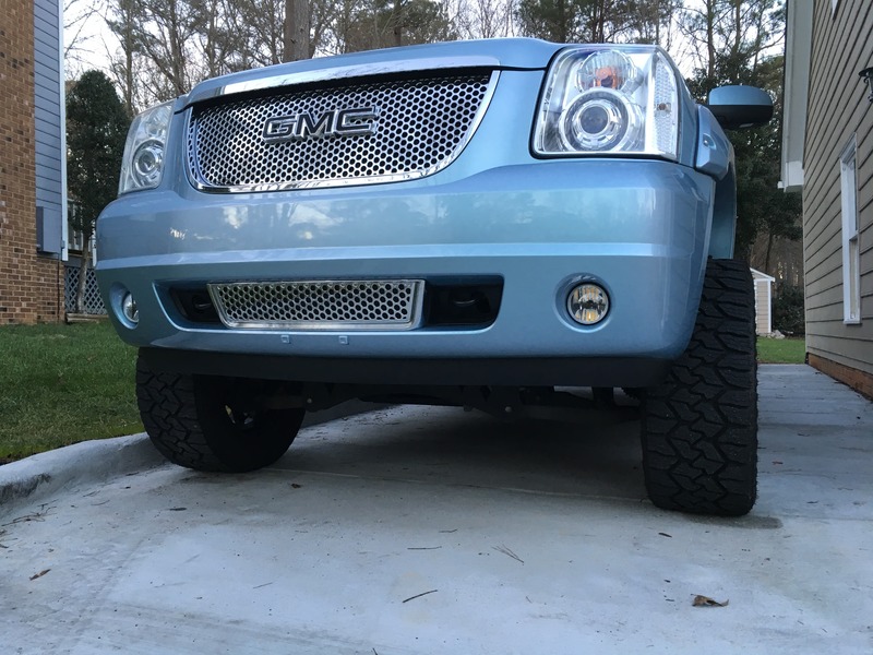

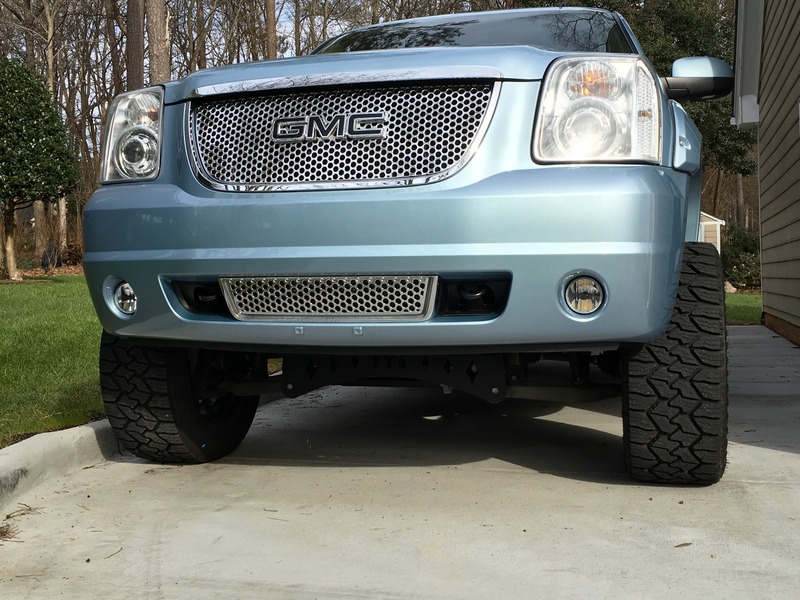

Updated headlights with cleared amber strips, also black vinyl over the grille emblem, and pic from the other day

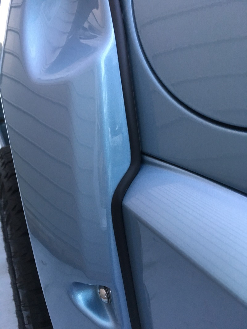

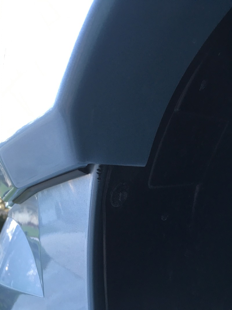

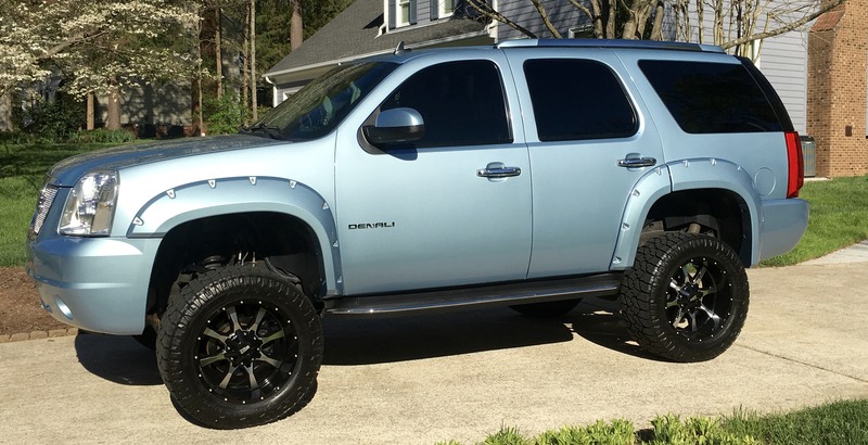

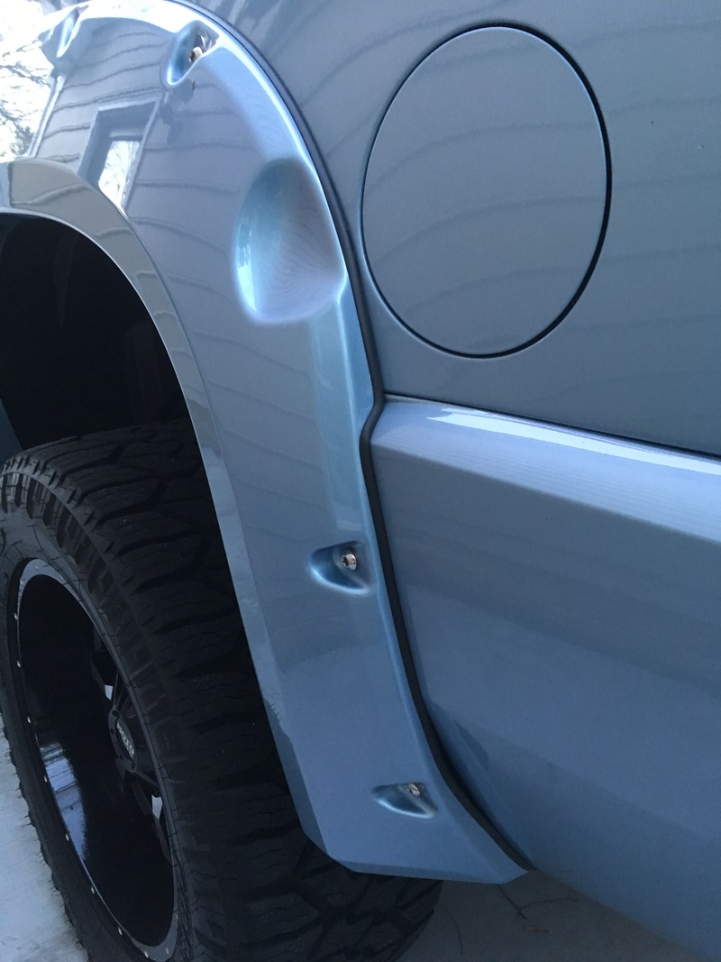

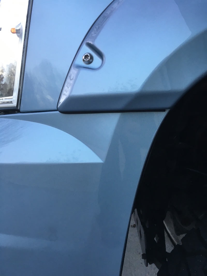

Latest update with lower valance trim and some flare pics to show how they need to be shaved for a Denali

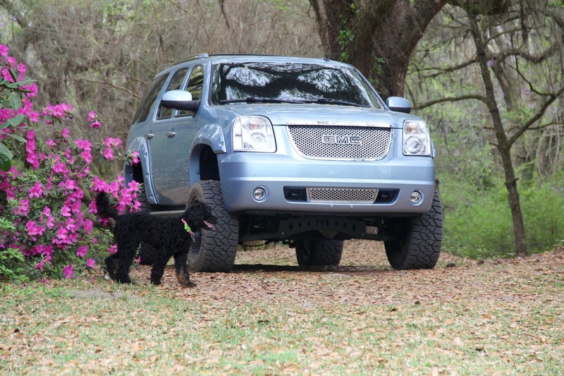

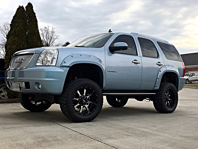

Looks bad ass!...now where is the dirty pics????

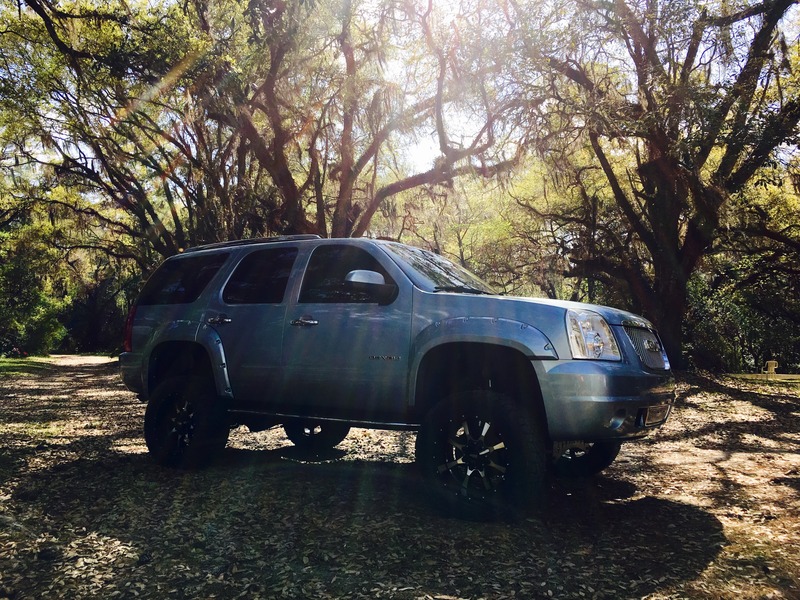

Thanks dude!! That dirty pic is in post # 25 when I took it down a dirt road haha! It's mainly a street queen but does get dirty every once in a while when going hunting or shooting.

woooo whooooo....how did u get out of that terrain??? LOL just kidding...looks good!!!

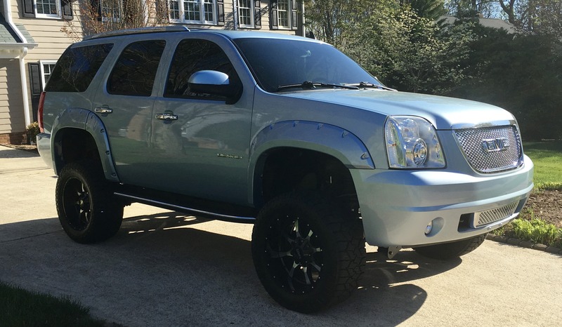

I dig it. I just never cared for the flares. Awesome truck.
Jk trade me
Jonah you need to build yours on them esky wheels!
Fiat thanks! I know most people dislike the flares but in person they look much better. Not sure why the pics make them look terrible. I do like the extra coverage from throwing stuff down the side of the body. I dislike them on the trucks with the flare on flare truck body.
