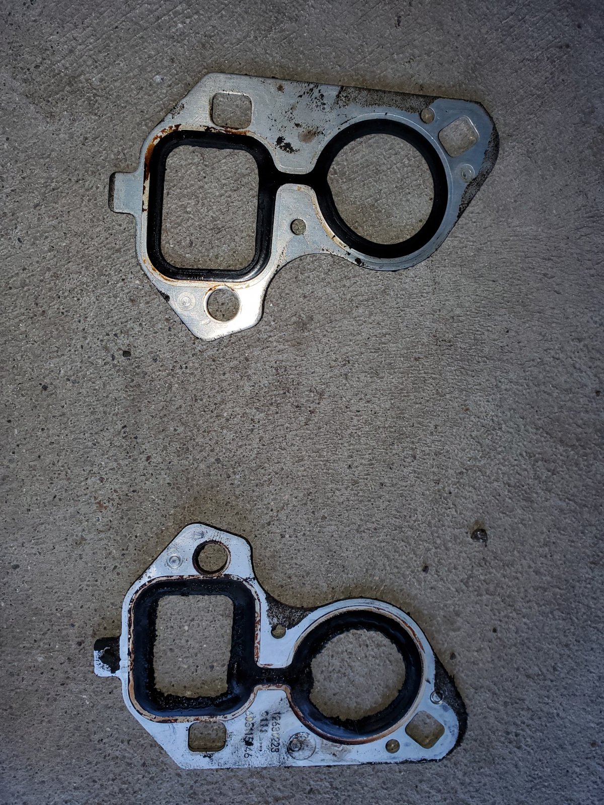

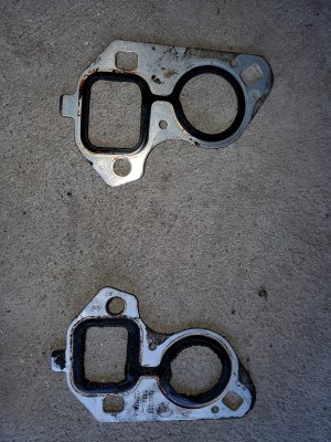

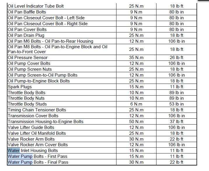

I have a Yukon Denali that started to run hot and found the water pump having a leak dripping down. After looking it over, I could not see an issue with hoses, so assume the pump is out. I have removed it and cannot find a weep hole visible. One of the gaskets appears rather bad and I am wondering what would cause this and if this might be the source of my leak. Thoughts? I am doing as others suggest and replacing the pump, T-stat, AC belt, tensioner, pulley and lower hose. Mileage is about 145k. Does someone have torque specs on these they could share? Only finding them for the 5.3. Thanks.

They are the same for the 5.3 and the 6.2.
The documentation that I have calls for a two stage torque:
Step 1: 132 in-lbs
Step 2: 22 ft-lbs

You probably were not paying attention but did the attaching bolts on the worse looking gasket seem to unscrew easier? Was the leak you saw from the area where that gasket is?
Unless you get new attaching bolts, I would clean the threads of the old bolts. I would run a tap in the bolt attaching holes.

Thank you for the info/suggestions. The bad looking gasket was the one more under the alternator. I could not tell if the leak was from the gasket or coming from under the hub. The bolts all came off about the same and no noticeable difference when comparing them. Surprised one gasket appears rather good and the other so bad. Thanks again.
