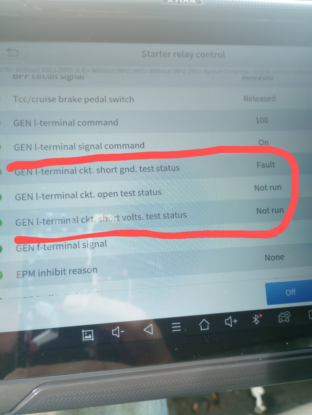

Found this interesting no codes on scanner to reference.

Weird that is under starter relay control. I haven't heard of a bad alternator preventing starting before..
When you say you jumped the starter relay, I am assuming you activated the relay and didn't bypass the starter relay?
Ya I jumped pin 30 to 87. It also turns over with scanner command mode
