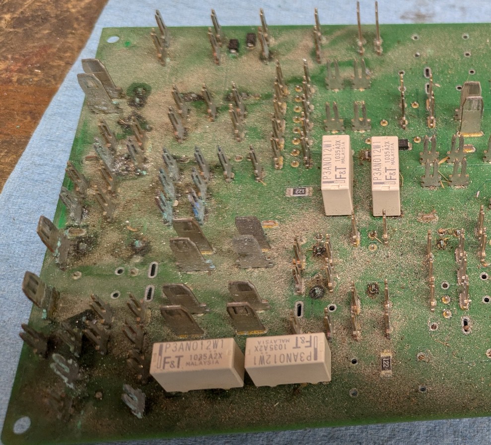

Whenever I hear about the electrical gremlins I say check the eng area fuse box. I had random shut off, headlight issues, stabilitrack warnings that would come and go. The big circuit board that all the connections and relays sit on was dirty and corroded. see pic.
Took apart and cleaned it, all works normal. I found it by wiggling the big wiring bundles coming to the fuse box. Lights would go on and off etc.
2011 Denali, btw.
