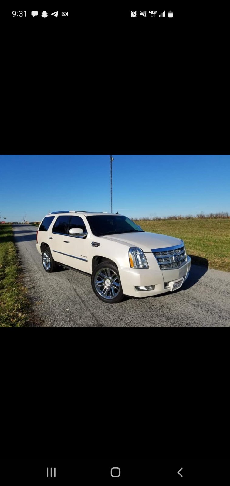

I have searched and didnt find the answer i was looking for. I would like to drop it 2/4 possibly 3/5. I am having a hard time finding a kit and have been out of the game for so long i don't even know what site to order from anymore. My struts are shot and its riding like a brick at the moment. I can't seem to find a kit that has drop struts and rear springs/shocks possibly relocators. Trying to decide on either drop struts but have no idea which or replace with non autoride factory struts and do spindles. Don't care to keep autoride so not a necessity. Also need a helper bag setup for the rear. I will hopefully be doing this in the upcoming weeks/month or 2 and will make a thread of the install. Going with some type of 24in wheel and possibly a 295/35/24? Thank you for the help!
