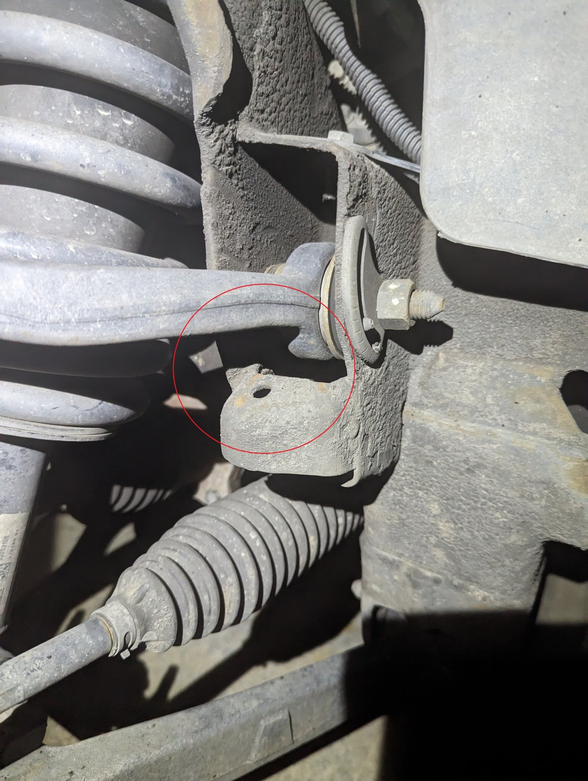

Thanks for the quick response, this is a 1500 suburban, by bumpstops I mean the metal ledge off of the frame that will touch the UCA at full droop

shouldn't be having full articulation unless the wheels are coming off the ground or you are bottoming out high speed
are you talking about right here-->
A
Alec R
Mar 22, 2023
Yes when I had the leveling kit installed the UCA were hitting on that with the vehicle just on the ground. When I removed the leveling kit they now have way more clearance
