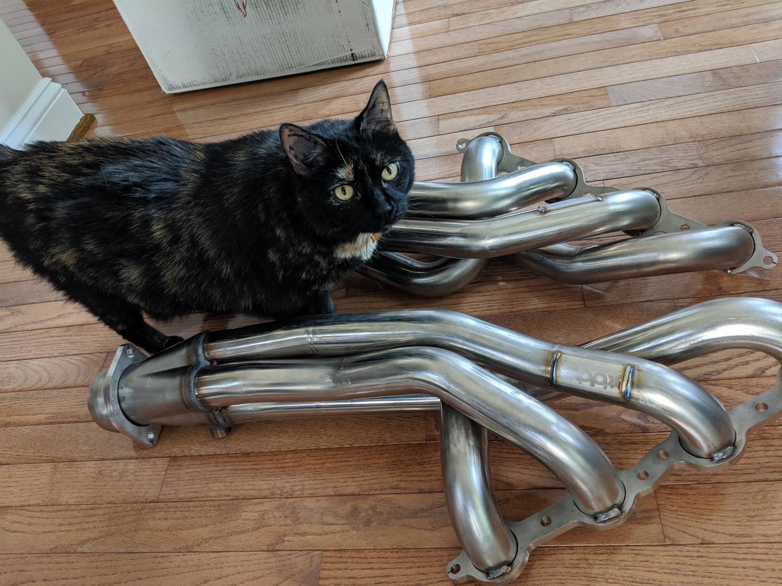

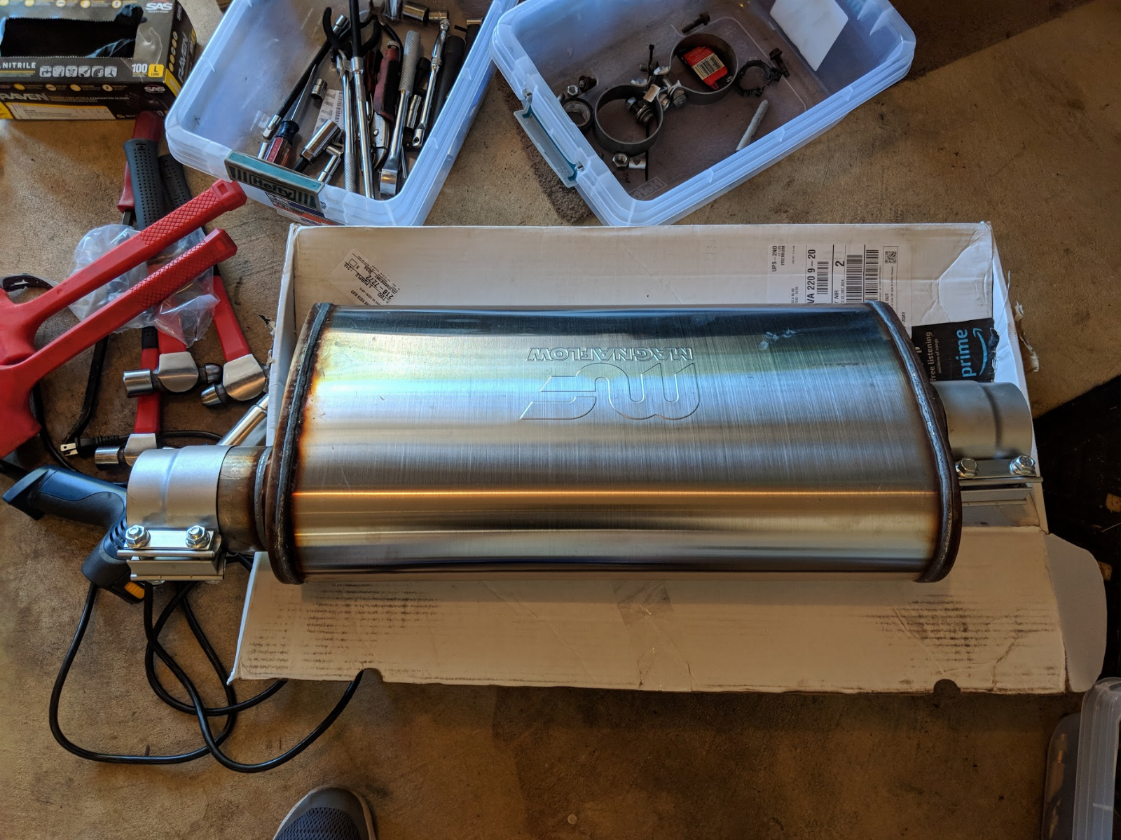

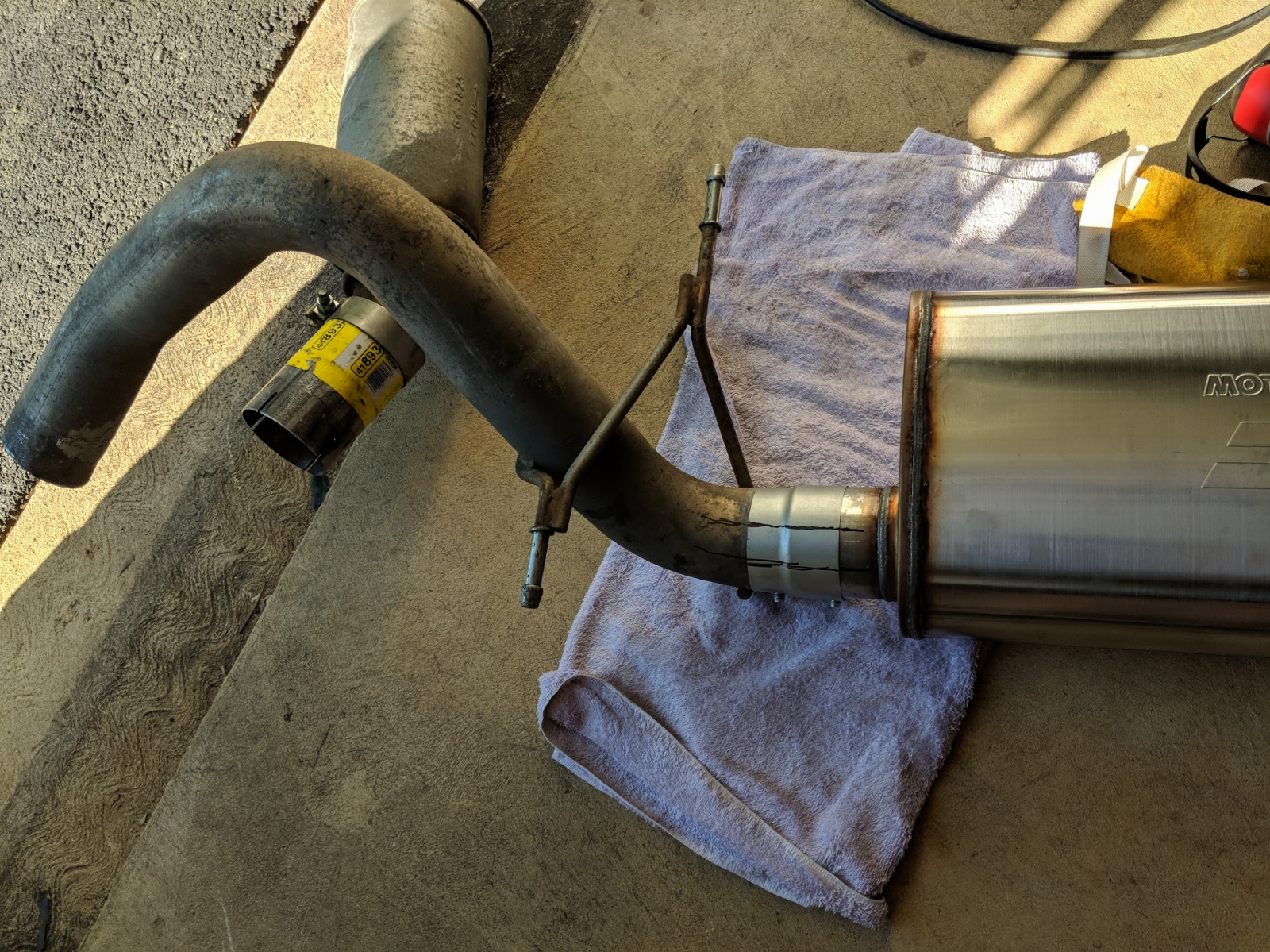

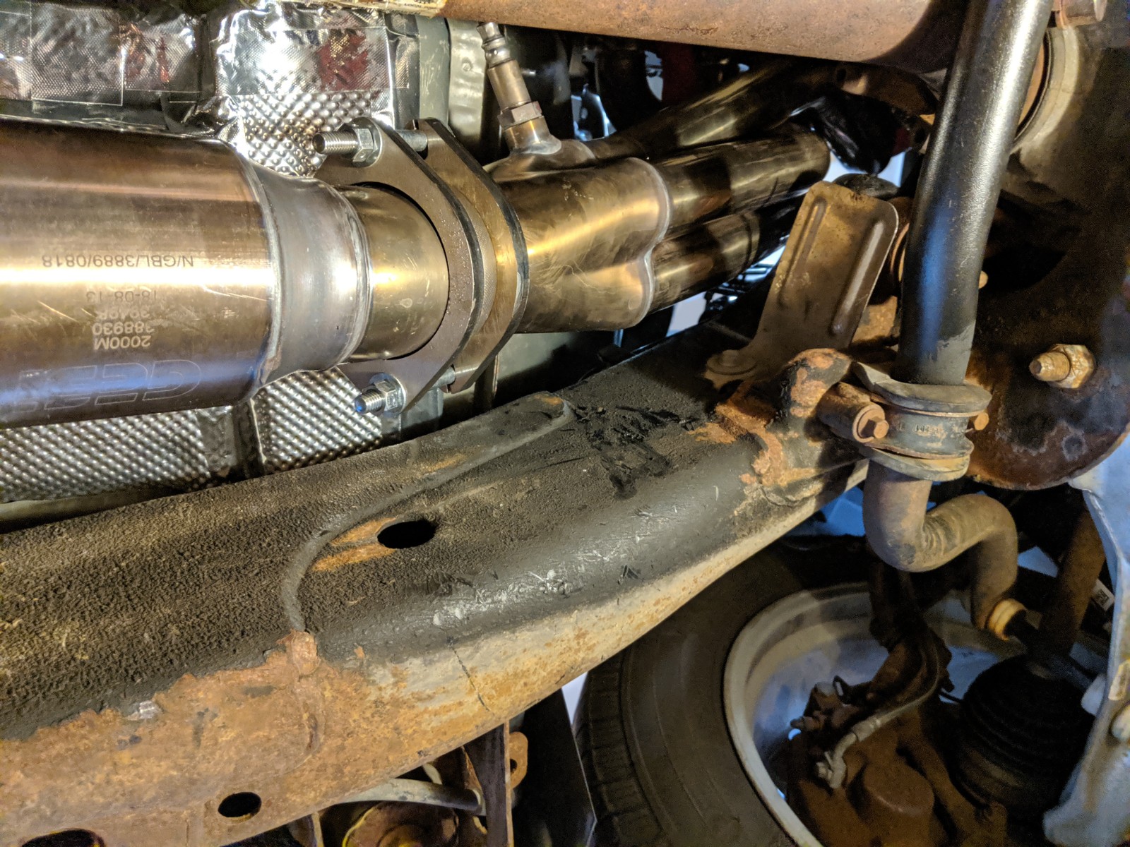

On my 08 Denali, I did kooks catted headers, hacked in a magnaflow muffler and kept the resonator. Comfortable cruising, screams like a racecar full throttle.
I did some heat shielding as my floors were getting warm with the changed cat position.
