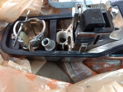

They have a threaded insert that a bolt goes into and they are prone to breaking if pulled on to hard... Like when someone grabs the door to yank it open but its locked... Very common problem on these trucks and not terribly expensive or hard to fix.
I bought my handle off of Fleebay, pulled the door panel and swapped handle.... Maybe took 20-30 mins tops.

I only had the 2011 Denali for a week when I noticed the driver side door handle would pull out on one side about 1/2 inch if I pulled on the door hard when opening it. I suspect it was already broken when I bought it at the dealer. I guess I should have pulled ******* all the handles first before buying it. Never occurred to me as I've never seen such a fragile door handle on a truck before. Given what these SUVs cost when new, that really surprised me.

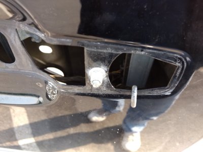

So after 3 weeks, I finally pulled the door apart to replace it today. I was worried that I'd get water intrusion into the door if I didn't take care of it soon as we are moving into the rainy season here. The plastic was broken where the metal receiver fits in so the bolt wasn't doing much good.
When I tried to remove it, the bolt there wouldn't unscrew and just rotated, damaging the paint under it. It stayed on the door when i removed the handle. I had to hold the one end with with pliers as I unscrewed the bolt afterwards.
Overall, it wasn't very hard to replace after watching a Youtube video of how to take the door apart, but I resent having to do it. I swapped in another GM part I ordered online for ~$50, but if I end up having to do this again, I think 'll buy those aluminum billet ones at 4 times the price as I figure they at least hopefully won't break. Cheap ceases to be cheap when you have to buy the same thing over again.
