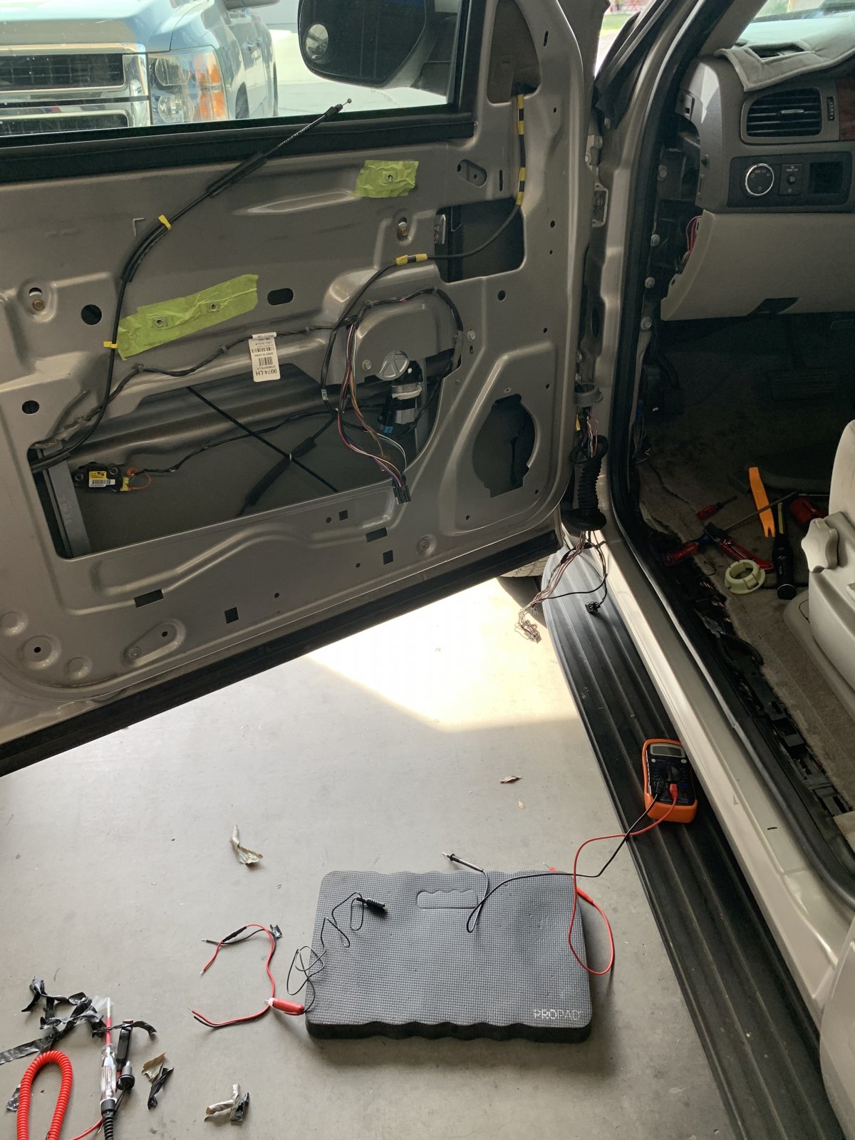

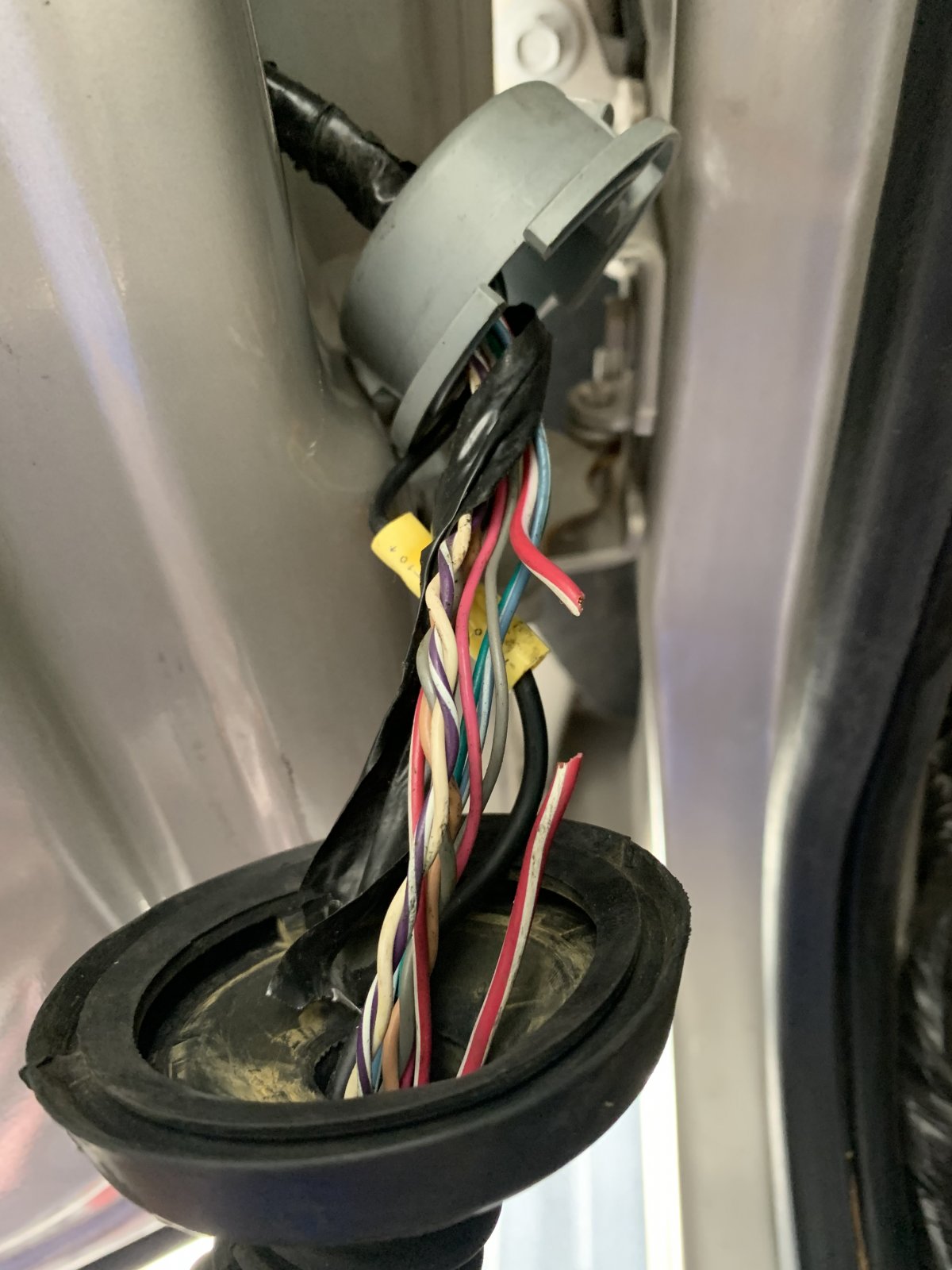

Broken wire in the harness is where I would look. I have found ground and power wires broken in two. Most recently on the DR side. Same symptoms. 3 years ago the ground and then 3 months ago the power.
