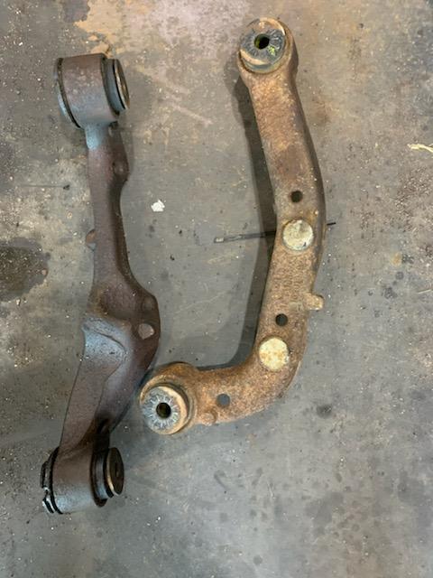

The front differential mount bushings were bad on mine, and it produced exactly the clunk symptom that you are referring to. I had both mounts replaced (came with new bushings), and the clunk was gone.
Other folks on this Forum have experienced the same symptom, and changing the mounts resolved their issue.

the front diff bushings on the left side are weak and need to be replaced ordered the whole mount instead of dealing with the press in bushings
