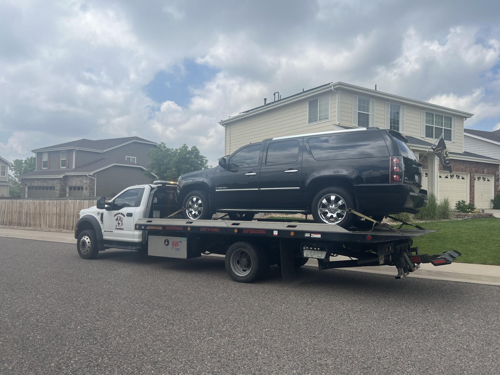

My baby is on her way to LT! I'll post my updates here when I get the diagnosis from Courtesy Automotive. This situation has been really difficult the past few weeks but I finally feel like I'm heading in the right direction. Thanks everyone for all of your help!
