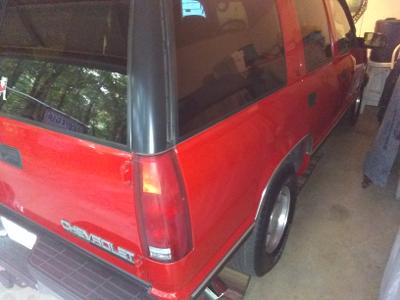

unfortunately, the evaporater needs cleaned with a water hose. Remove glove box completely, remove blower motor, to the left is the evaporater core. GOOD TOOTHBRUSH to clean the fins. Then spray core with purple power (walmart) and let it soak while you remove anything in the bottom of the case. Use your floor mats and arrange to get the water flowing out of the door opening to the ground. use a good nozzle to make good pressure to wash out the core. It will try.....trust me. My 99 with 226k, cools specs 38-42.......JMHO
