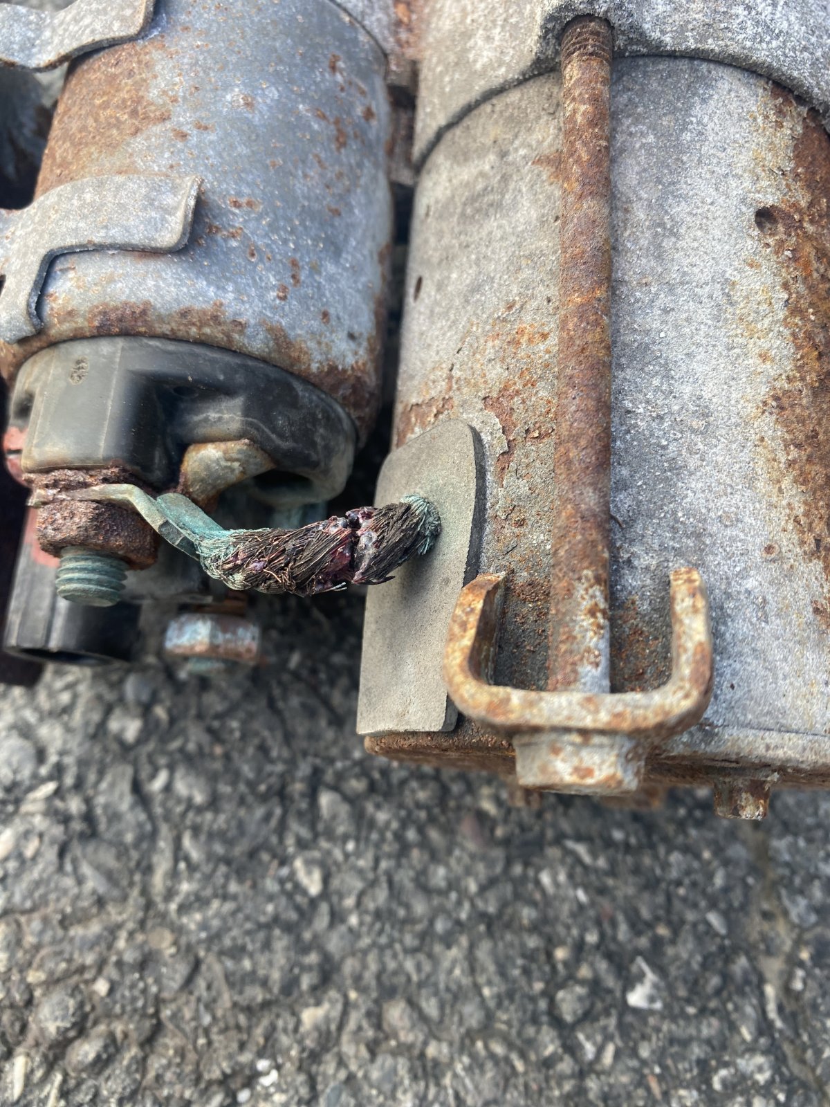

Check the starter. There is a ground off the solenoid to the starter body that can corrode. My ‘13 pretty much did same thing. Ran fine, parked it a few hours later nothing… had lights, good voltage at battery, everything checked out normal. A few raps on the starter got it crank but then would quit mid crank.

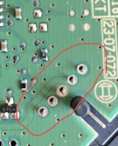

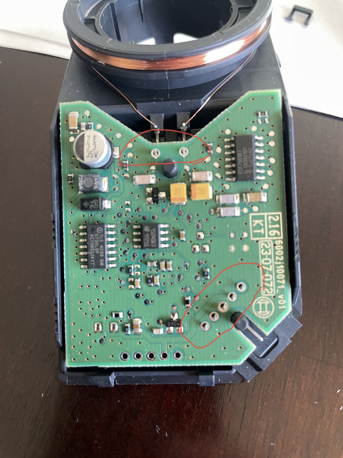

Starter is good, jumped relay and turns over fine. Unplugged ignition security module and it will start everytime and die. After plugging it back in, it’s starting and running normally. Wonder if module needs replaced. Looking inside I don’t see anything obvious but wondered about these joints?
I would be more likely to suspect the capacitor (s) if the solder joints are okay. The caps are the components most likely to suffer from age, me thinks.

gm has been known for parts failing over solder joints. all the older abs systems in the obs, most can be fixed by reflowing the solder on the big pins, same with the c5 abs system. almost every one that fails seems to be fixed by a reflow. the 2nd Gen volts there's a major issue with a battery module of some sort. every thread leads to just pull it apart and reflow some pins and it usually works again.
I don't know what kinda qc gm has in place.. but same issue has spanned almost 30 years at this point. I'd say it's definitely worth a try, even if they look good. maybe make a youtube and add it to all the other repair videos haha.

Well I reflow the pins I circled in the pic. It starts and runs now. I tried a new gm security module but couldn't get the 30 min relearn to work. I reinstalled the old module and see if it flakes out or not. Looks like my no crank / crank-start-die has been solved. Thanks for all the help and suggestions! :patriot:
