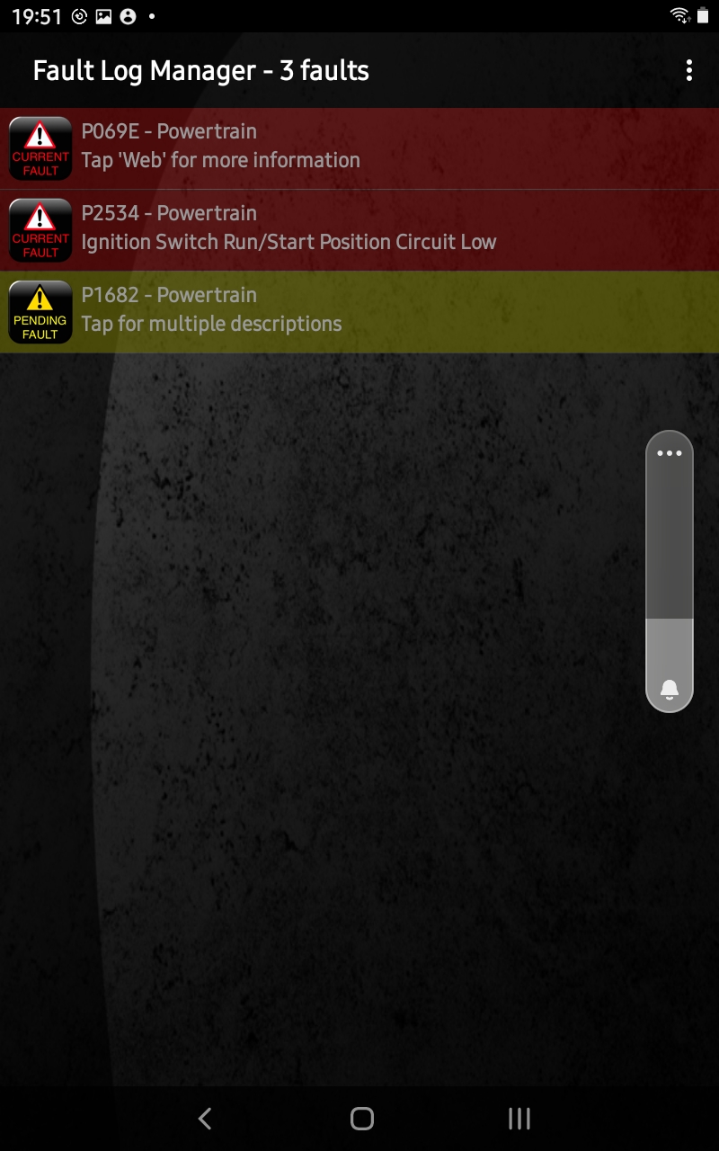

Update, checked codes with torque app. Here's what I have
P069E – Fuel Pump Control Module Requested MIL Illumination​
P2534 – Ignition switch, ON/start position – circuit low​
P1682
Chevrolet
Engine control module (ECM) -ignition power supply variation
So I cleaned up the battery connections and ground point on the pass head and tried again. Same thing with crank sometimes and run a few seconds and mostly no crank at all. Then it started once and ran fine. I shut it off after 10 minutes and back to no crank.
Fuel pressure read 44psi
Could it be the ignition switch? I read there were issues with some.
P1682
Chevrolet
mmmmm maybe fuse box, seems logical. these trucks are pretty finicky about voltage
