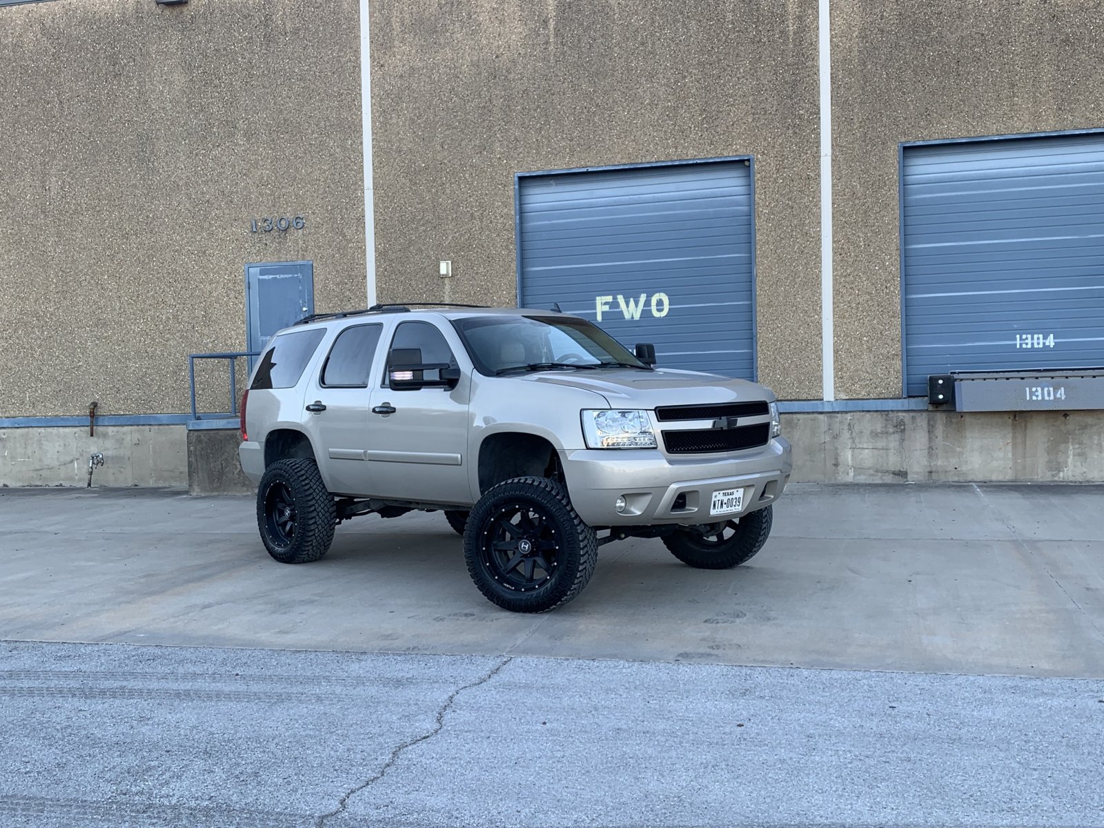

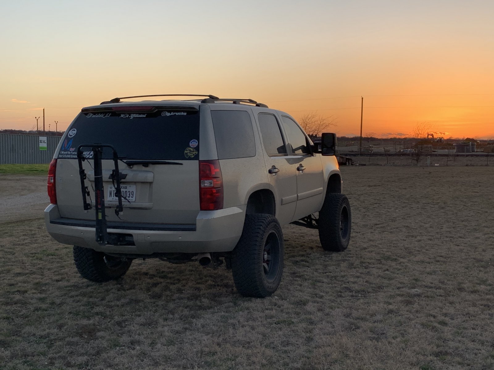

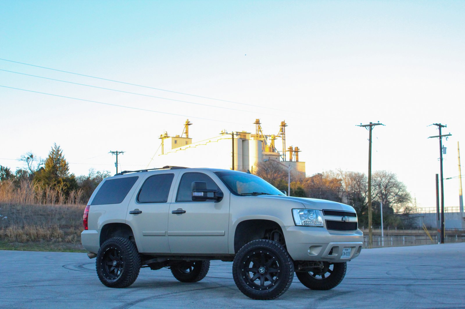

Here’s some pics of the Tahoe. I bought it with the lift and figured out quickly that was dumb. Has anyone ever swapped lifts?

@Mason Mayo Look up the installation instructions for the lift kit that is installed and then you can make a plan to reverse it depending on what permanent modifications were done to the frame to support the new lift.
It might be a better option to keep the lift on it but to improve it, from your pictures I can see that it is using factory struts with a damn 5? inch spacer. That means the Tahoe was lifted 7 inches but it is still using the same factory shocks that are not designed for a lift like that. Ditch those and buy proper 7 inch lift springs, shocks, and struts and that would help out a lot.

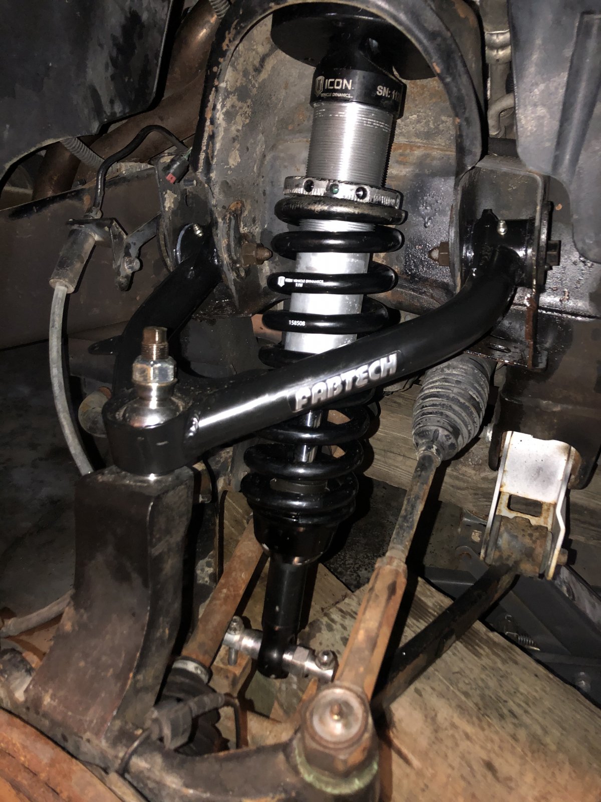

I put icon coil overs on my Silverado with the RC lift and swapped the RC UCA for Fabtech uniballs alone with kryptonite tie rods and wheel bearings swapped the rear RC shocks for bilsteins and the rides quality handling etc was night and day difference. Lift isn’t hard I done mine on the Tahoe with nothing but a floor jack and jack stands by myself with only basic tools and everything went smoothly. My Tahoe has the Fabtech gen 2 lift off a 2019 Silverado with the uniball UCA with icon coil overs off a 2019 gmc at4 and rear RC lift springs and jeep sway bar links everything is perfect now I’m getting my rear build together with resi shocks diff cover sway bars and adjustable control arms/Panhard bar by spoon message me if you have any questions on how to do anything I’ll help out however I can
