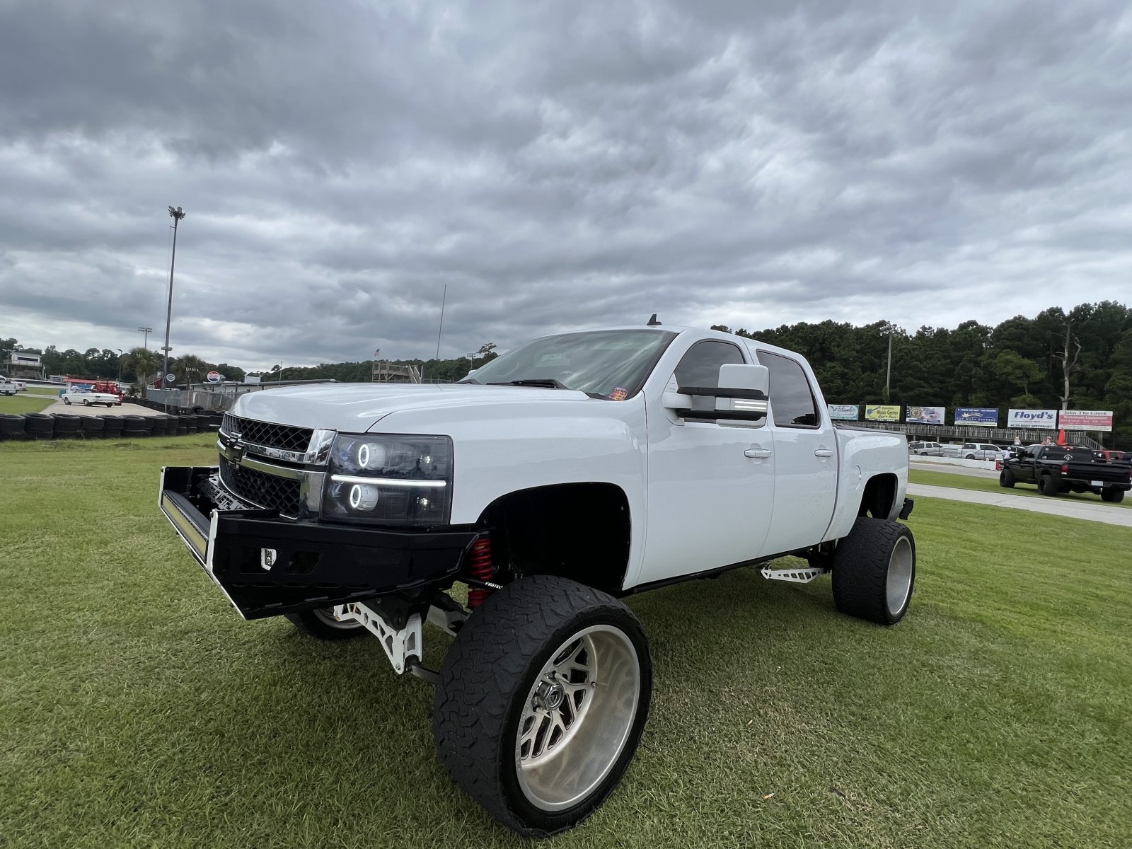

This was my Silverado picked up to 9” I believe
9” was all I could do while maintaining alignment and cv angles
