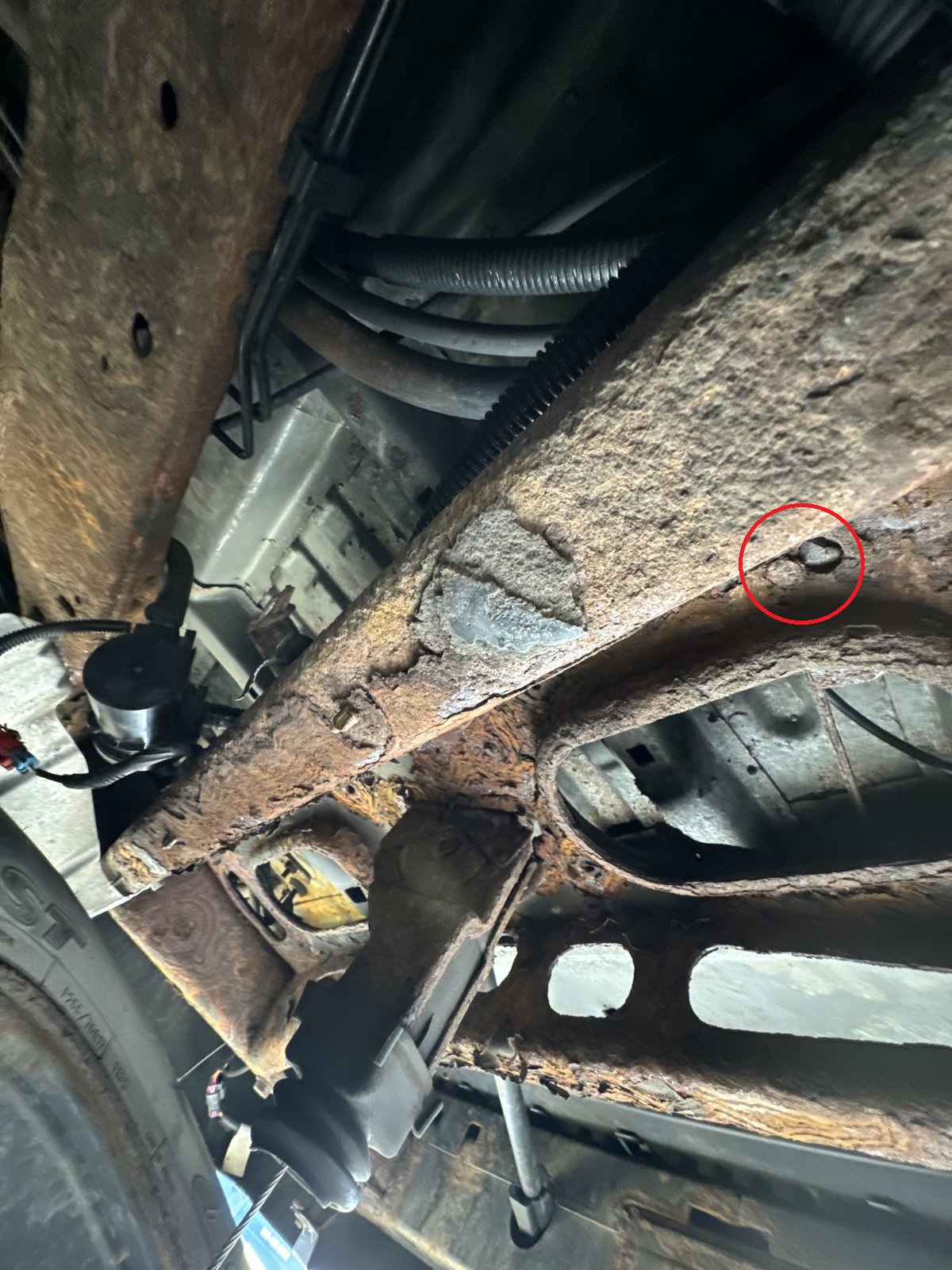

2007 Yukon died while driving. Found harness unplugged but cannot find where it plugs into!

That's the connector for the suspension control module which is above the spare tire..yes it can cause the truck not to start.Maybe the module fell out? Please excuse my Jersey shore frame rust.

Does anyone have a definitive location of where the Suspension Control Mod would be?
Directly above the spare tire. If you do not intend on keeping the air ride you can by bypass the connector and splice the wires directly. I believe the low speed can runs through the module and most likely shorted out from some corrosion in the connector. You gotta verify though.

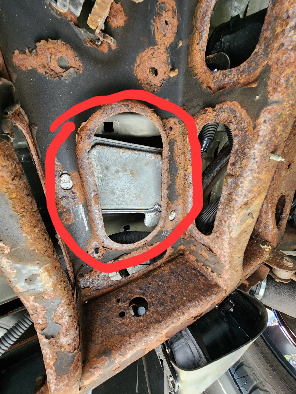

Seems to me that if the suspension module has been missing for a while it doesn't explain why the truck died now. Unless the module somehow just left the building or was disconnected by the jolt, physically-speaking.
Are you sure it's not up there hidden by the frame member, having slipped out of one of the keyholes? What's in the keyhole that I've circled in the pic below?
