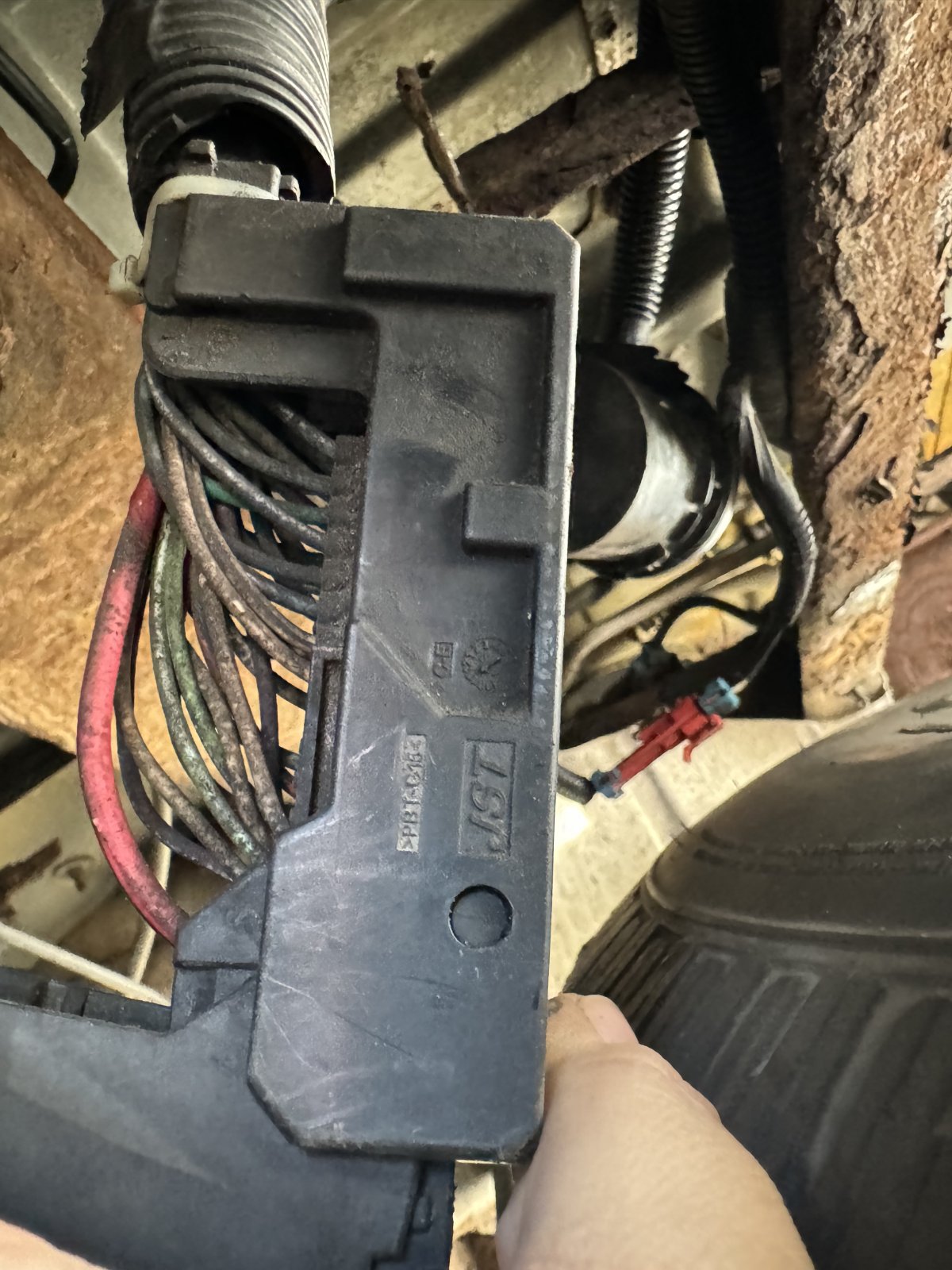

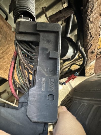

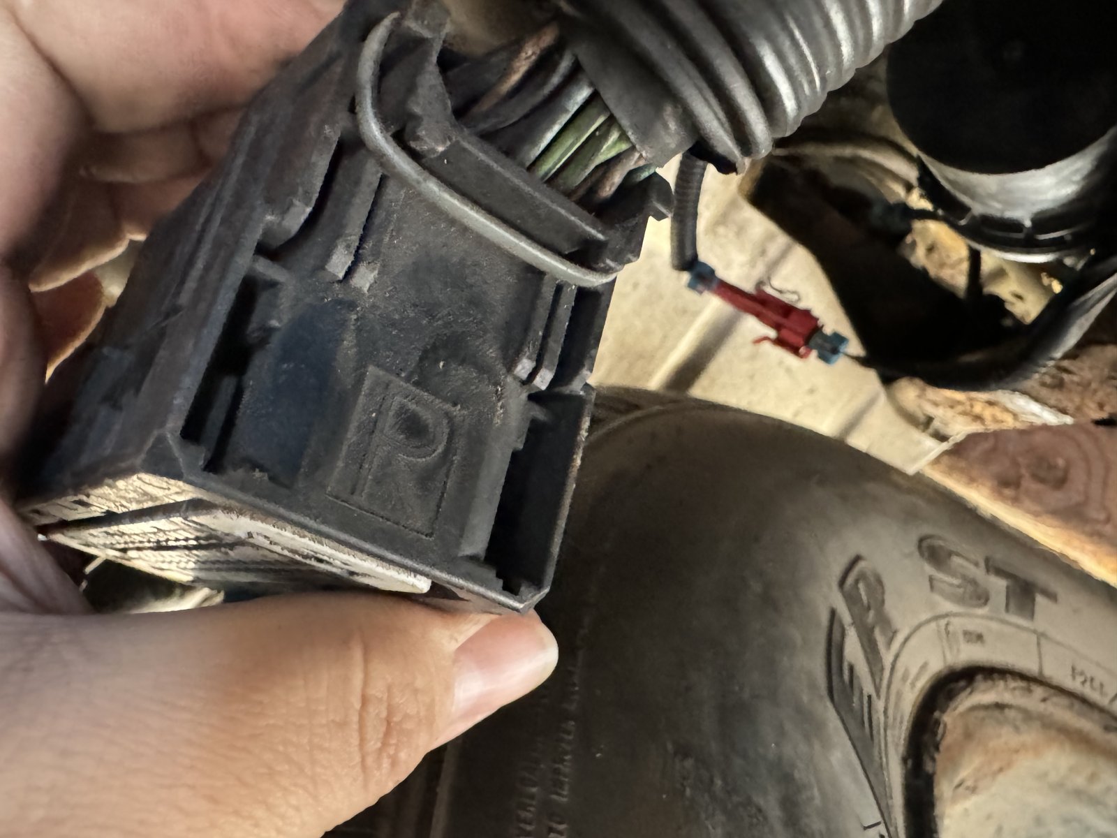

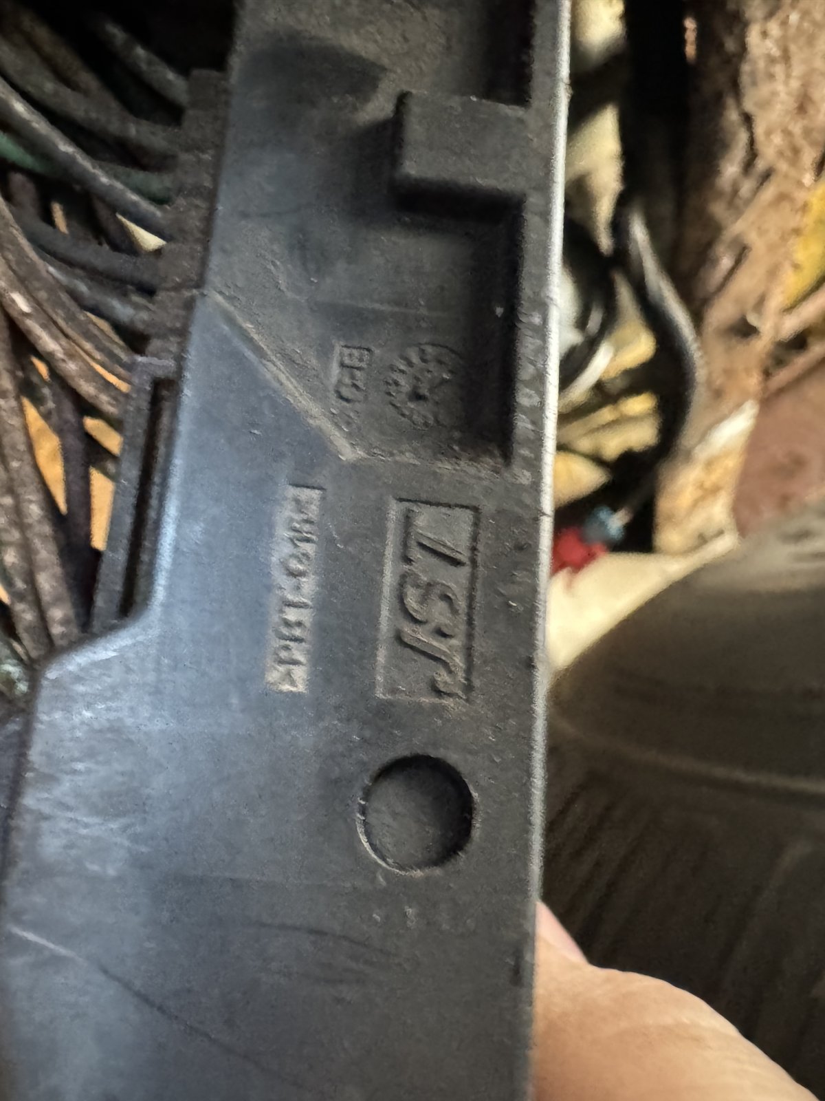

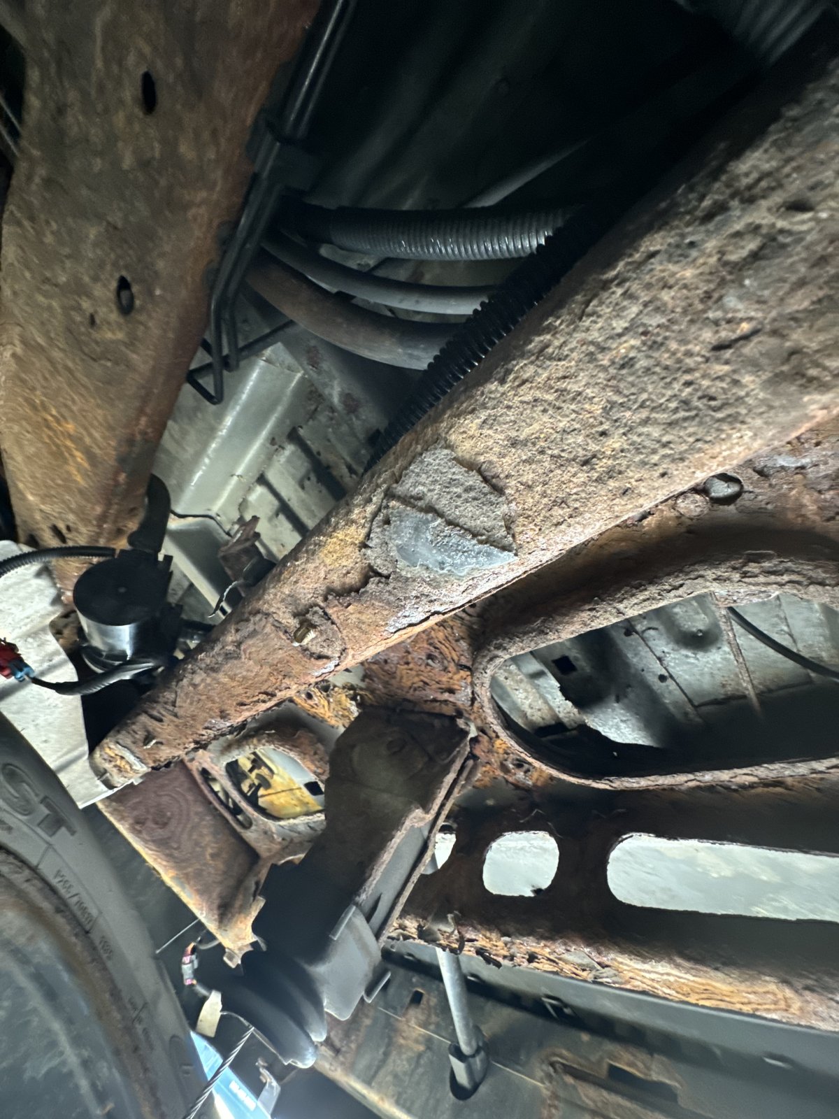

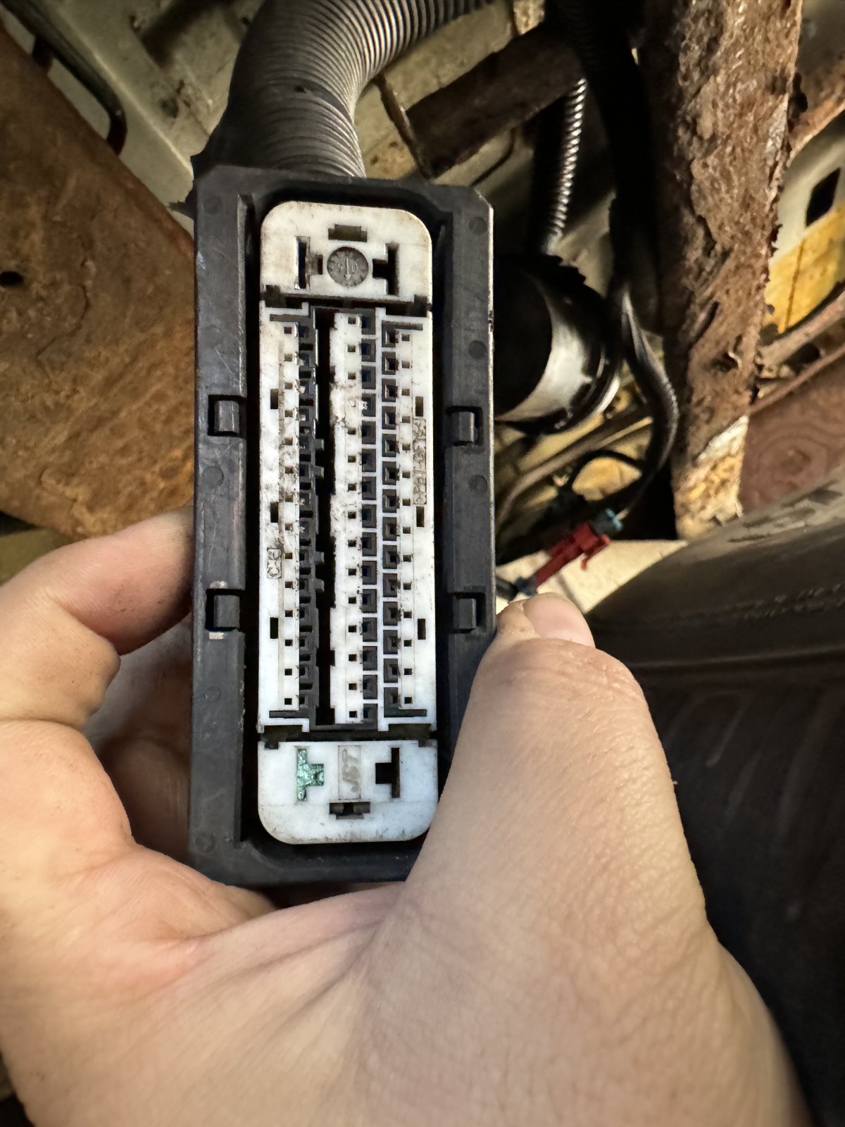

Hello All!
Was driving to pick up my wife from work last night and missed the turn, stoped the truck and threw it in reverse and the truck just turned off. Dropped the spare due to having a code present for an Evap vent solenoid and noticed a large harness hanging.I believe it is for the fuel control module but I’m reading that these years did not have one? I’m super lost had to get her towed back home since it was super late last night.
See pics below

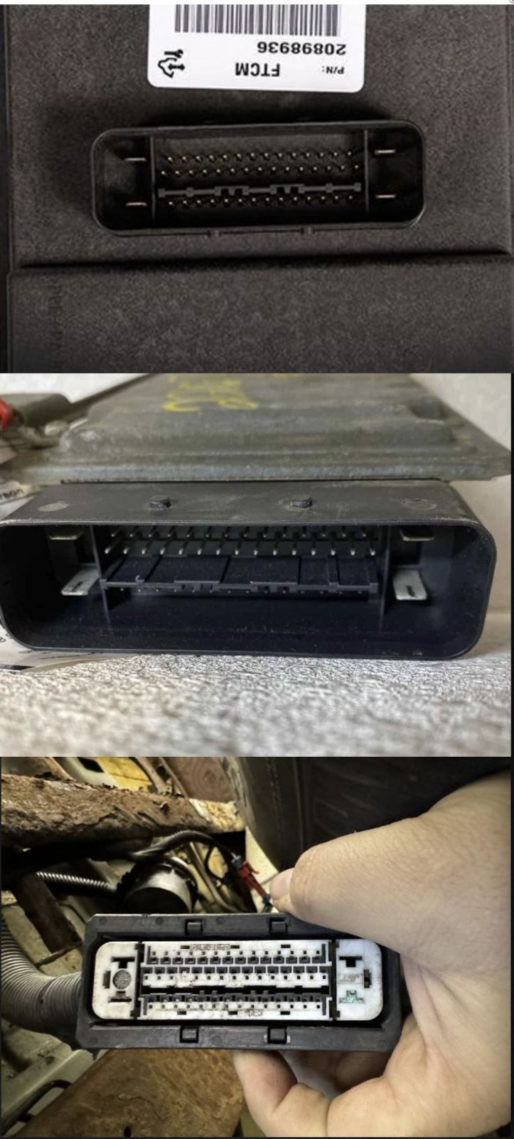

hmm if I was a guessing man I would say it did have one.... it's probably laying in the road where you flipped it in reverse

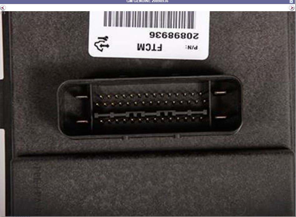

might be worth your time to go back and look for it because they have to be programmed to the vin if you buy a new one, but I think the Dorman one does not.
if you look at your harness and compare the pins and slots to a control module,,,,,,,,, although the one I pictured may not be the one needed
****EDIT, IT SHOULD BE NOTED THAT THE SUSPENSION CONTROL MODULE AND 08/09 FUEL CONTROL MODULE HAVE THE SAME CONNECTOR IN THIS CASE AS PICTURED LATER IN THIS THREAD.****

If your 07 is a Denali (which your screen name implies), do you still have the OEM Z55 air and electronic suspension (shocks), or did you or a previous owner convert to a passive system? In your first photo, I do not see the electronic suspension controller, and that plug looks like the plug that connects to that controller.
Still with the OEM suspension never fixed it. Dealer quoted $1700
Took a drive out there this morning and nothing what’s weird is I cannot one of these compatible with my 07 Denali…

what is the manufacture date of your Yukon?
the dorman 601-132 says it is compatible with 08-09
so depending on your manufacture date it could be what you need.
just guessing

I too thought early trucks didn't have a fuel pump module..
Perhaps the fuel pump is starting to go?

not unless it is 100% identical to a fuel control module, look at the pins i pictured

if it turns out you do need one and grab a dorman I would grab some crc contact cleaner and a can of compressed air and clean up that harness I see a little corrosion on there and that is a known issue for these trucks becuase they get exposed to the elements, so clean that up and then tuck it up under there as high as you can get it.

OK, but I still do not see the electronic suspension controller in your photo. It sits right on top of the frame rail. About 4" wide by 10" long and about 1" thick.

Does that suspension control module have anything to do with the no start issue?

it could if it interupts the lan bus as noted already, leaving a open circuit
I would look up under there a little closer, maybe the suspension module fell off then
