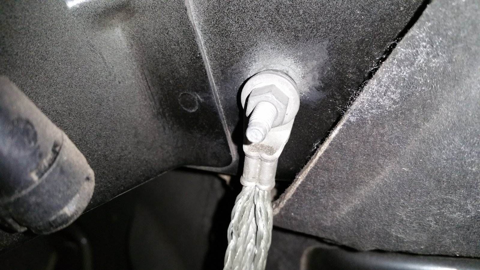

Where would I find the transmission ground strap?
it's connected to the transmission not sure where but it's a bare aluminium wire (copper tin for iron blocks???)to the frame..
each main part has one i.e the engine transmission etc..... that is because of seals will cause poor contact to ground
should look something like these typically...
View attachment 237885 View attachment 237886
thanks, will take a look

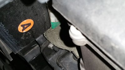

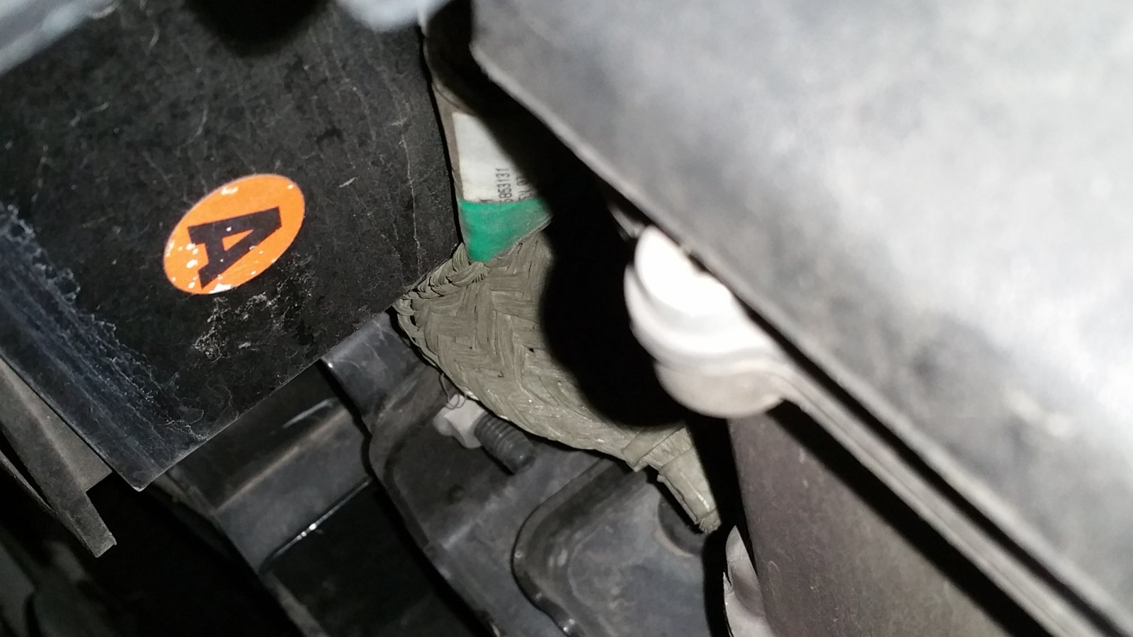

I took the fuse box out and didnt find any evidence of a mouse or chewed wires.
