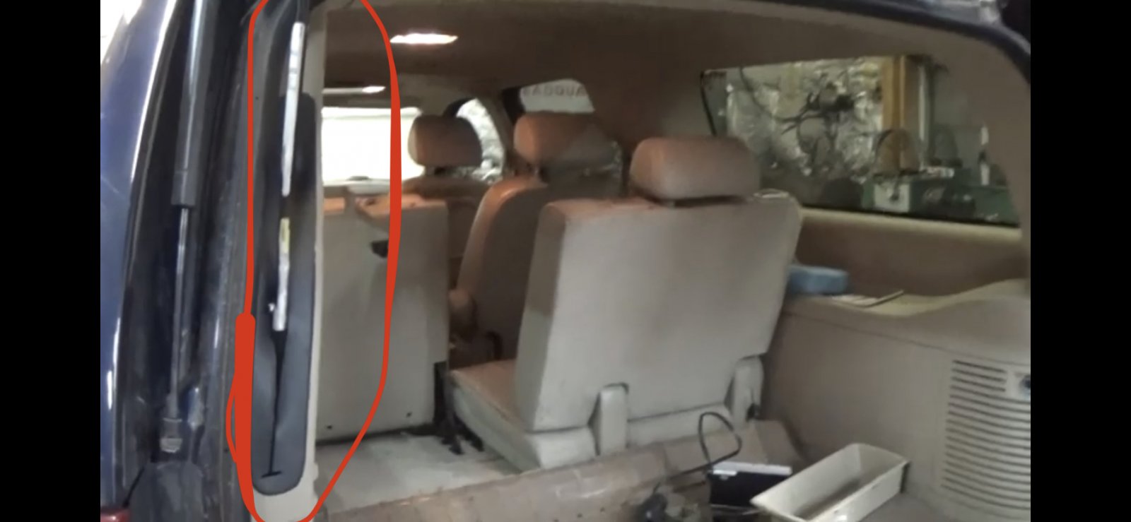

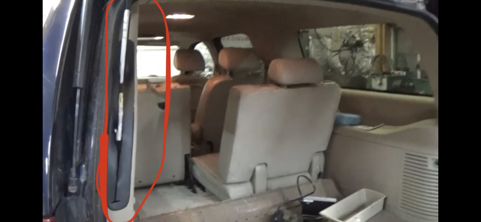

Should be able to just pull the rubber gasket back a little and see the motor and if things are turning or not.
Here is a video of a guy working on the liftgate.
U
ugadawgs311
Oct 13, 2010
109
14
thanks for the video. I pulled back the rubber piece like you recommended, and I can see the arm trying to move, but it just doesn’t. It seems like the gears aren’t engaged back there...
It definitely seems like it's that gear that you pointed out. I can see the gear try to turn, but it never does, then kind of pops back to its starting position. However, when I manually close the gate, I can see the gear moving perfectly. Grr....

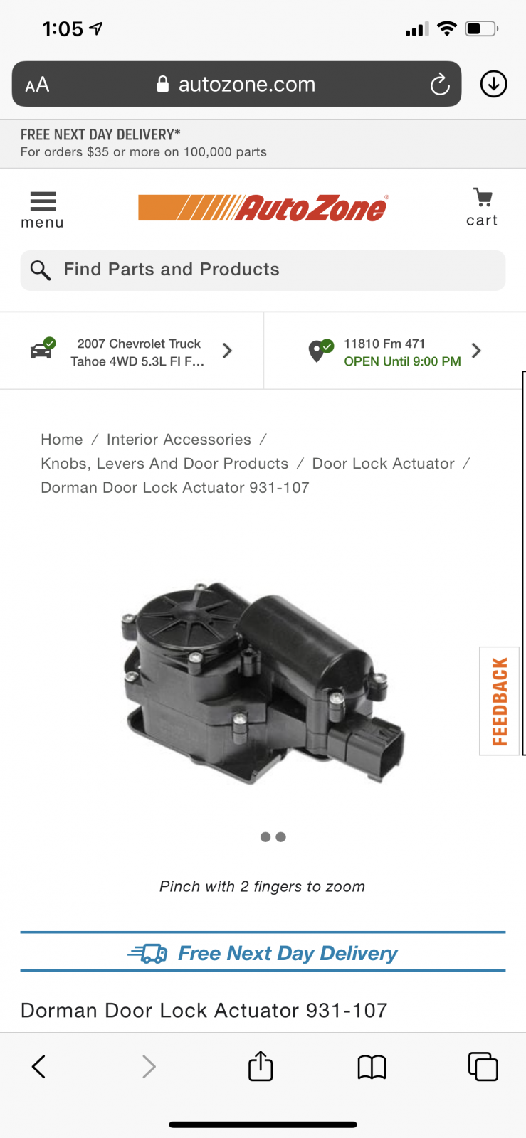

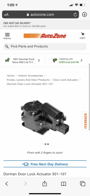

I helped my brother diagnose this issue and the symptoms described by the OP were identical to his. If you have a tech 2 or similar scanner, the body codes may point you to the right direction. The codes for my brother’s truck pointed to the latch on the door. The latch has internal sensors, one of which had failed.
We did the relearn procedure after the replacement, and it’s been working since with no issues.
U
ugadawgs311
Oct 13, 2010
109
14
What did you replace on the latch? The whole unit?
I’ve also noticed that the latch doesn’t seem to move when opening or closing. The little piece that should move when opening, stays put, and when the gate is open, I can manually move the latch myself.
cam3439
Feb 2, 2010
163
33
Yeah, we replaced the whole latch assembly within the rear door. It’s called different things, like door lock actuator / liftgate lock actuator/ etc., but it was an assembled unit. The sensor that failed was internal to the unit in the screenshot below, and it looked like some of the sensors were epoxied (helps with longer life) so I wasn’t about to start messing around with trying to find the single sensor.
If the latch turns out to be your issue, find the correct replacement part for yours. When we looked for our replacement, multiple units/versions came up.
