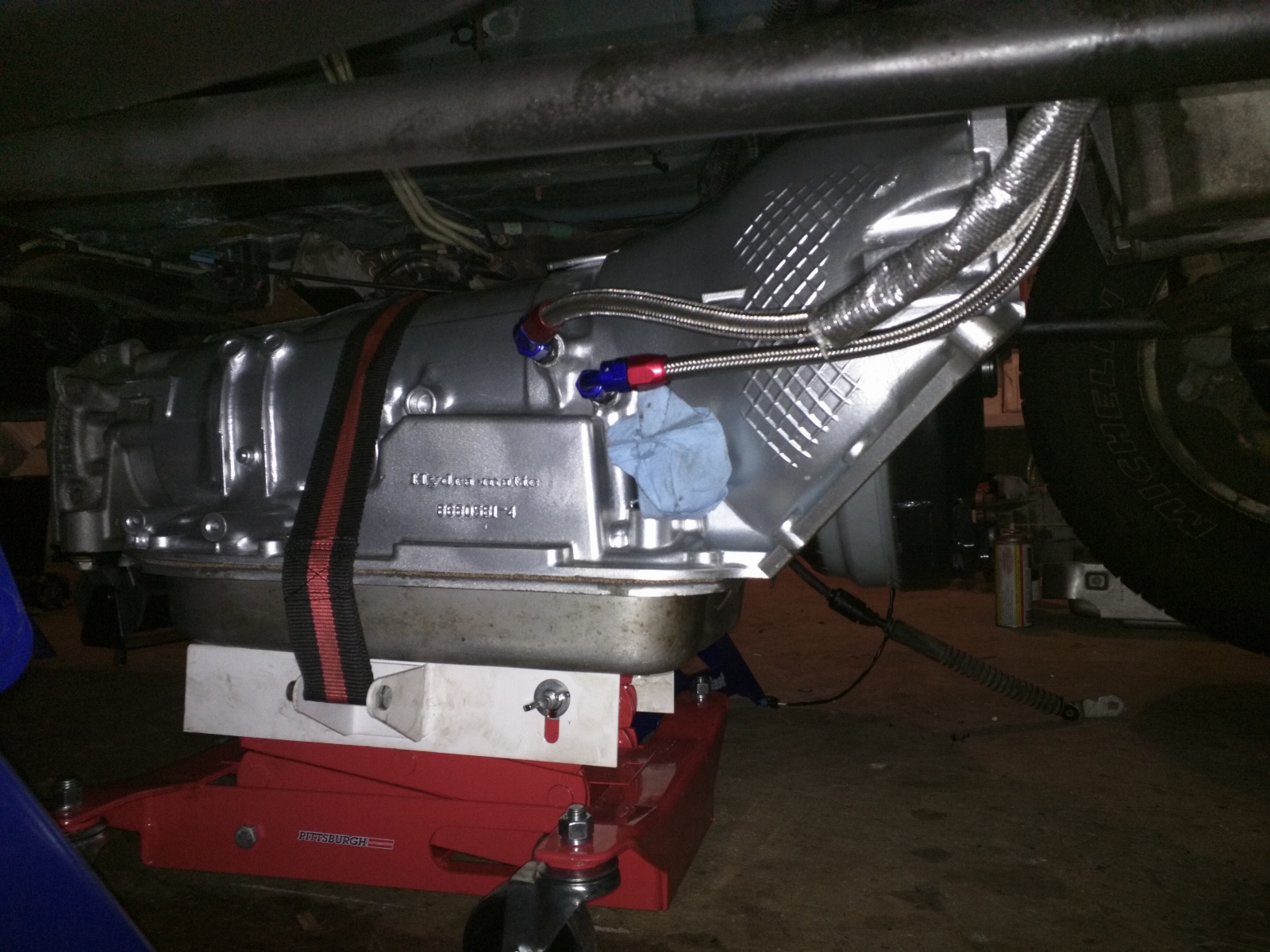

I did notice that after I got the auxiliary transmission cooler installed that my outside temperature on my rear view mirror reads much higher than normal. I think I found the sensor and might try to move it somewhere further away from the transmission cooler radiator.

You'll need to make sure its away from the cooler and in an area where it gets air flow. I had to move mine on my prev Yukon when I did a large trans cooler.
Per the stalling issue, the fuel line runs by the trans and I think pretty close to the drivers exhaust. I'd see if it were possible to wrap it. I wrapped my prev Yukons trans lines with the pictured stuff and it worked well.
